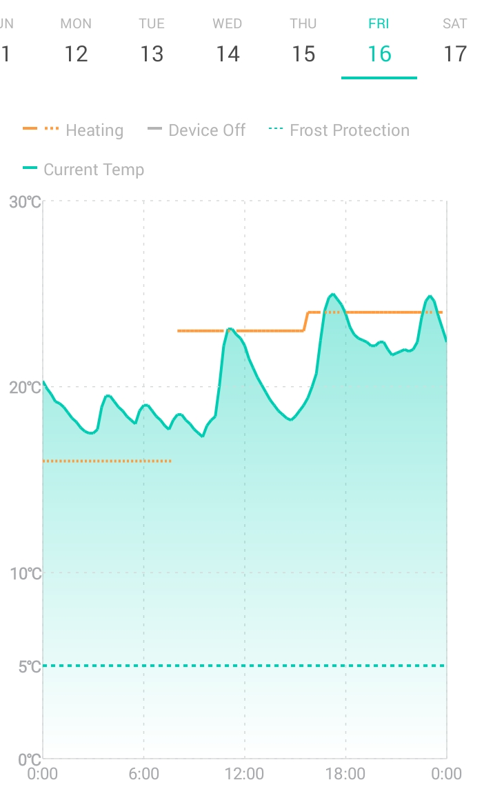

What one needs to remember is a TRV is a thermostat, it depends on where one reads as to if it needs a timing element, but the electronic TRV does have a timing element, so there is no need for any wall thermostats or programmers, the electronic TRV head can do the lot, which is what the Honeywell EvoHome did and still does all those years ago.... if I understand correctly there are now some 'regulations' (I don't know their 'status') calling for 'zoning' of heating, and that that is usually achieved with wall stats in each zone. Is that not the case? (not that I personally care - I'm happy with what I have, regs or no regs)
must help when trying to work out failings. The Wiser version records from the internet outside temperature as well
I have removed a section to make picture smaller, it shows thermostat setting, room temperature, and outside temperature but it does not help with an install where one has no idea of the pipe run, which is all micro bore, so there is around a 20 minute delay from boiler turning on to radiators getting warm.
