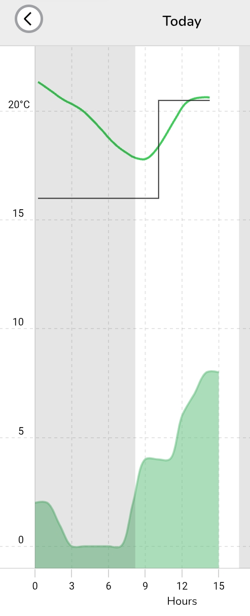

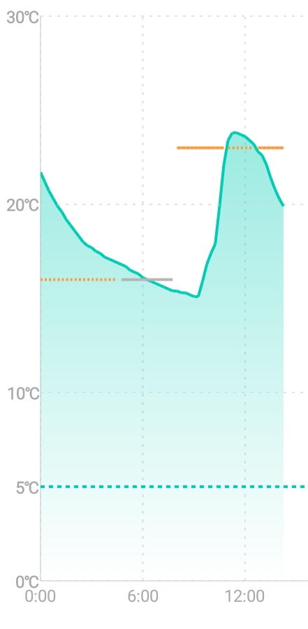

And I am not sure if the oil on/off boiler is causing the hysteresis or the way the electronic TRV heads work? Today I feel cold, thermometer on table next to PC shows 19.6°C the TRV behind me 19°C, behind sofa 19.7°C and the wall thermostat 20.5°C and set to 20.5°C and heating not running, radiator cold. Did not take readings yesterday, but felt warm, the Kasa TRV will show a graph, as will the wall thermostat 1769005704894.png1769005594935.png and it seems as if heating is doing as it is told, so why do I feel cold? Maybe because it is a dull day? Phone tells me 8°C which is also what the wall thermostat shows, where it gets it from I don't know, must be the internet in both cases.
If the room was 20°C in the summer, I would be thinking it was hot, so maybe kid ology works?
