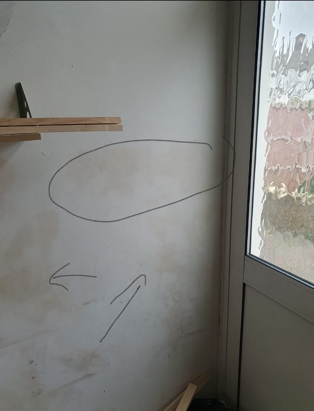

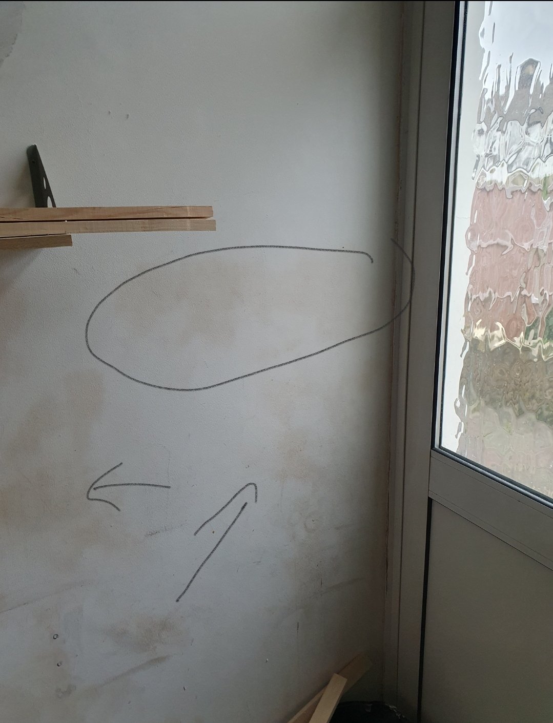

Hello,
I have a kitchen wall and the color has changed. Its been like tgis for about 10 years, since i painted it when replastered. Could this be damp or something to worry about? I was planning to wallpaper it then paint over it... to hide this. Any advice would be appreciated. Thank you.
What's on the other side of this wall? Do you get any efflorescence on the surface?
A stain blocking paint might work in the short term, but you need to address the root cause of the discolouration if you want to solve the problem.

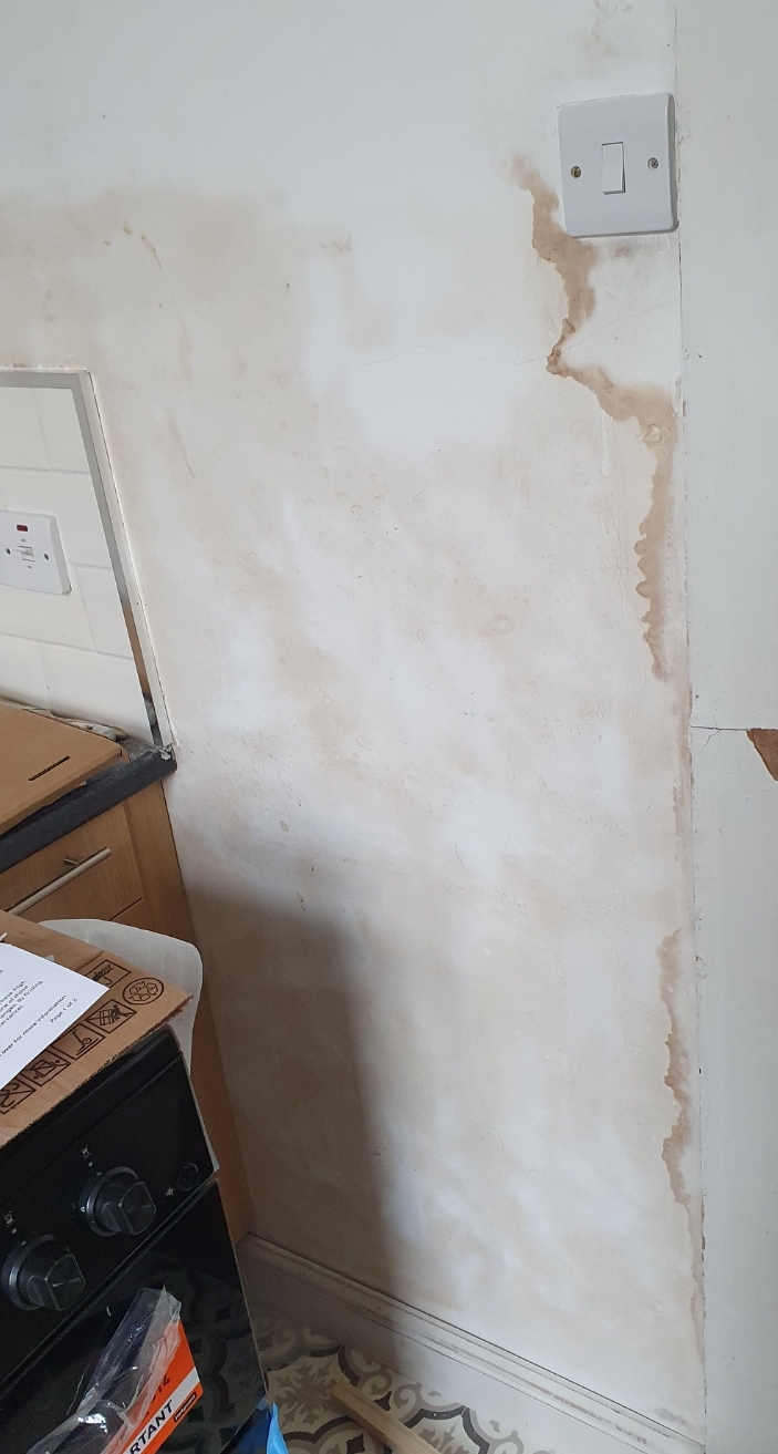

Hi Olly,
The others side is the stair case, and under there are the gas and electric meters. I have another wall in the kitchen and has the same issue. The other side is just the dining room. Previously there were tiles in that area were Im getting the discolouration. I took the tiles off, had it replastered then painted but the discolouration persists. Could it be the material the wall is made of or the new plaster? Is there a way to find out if this is damp?

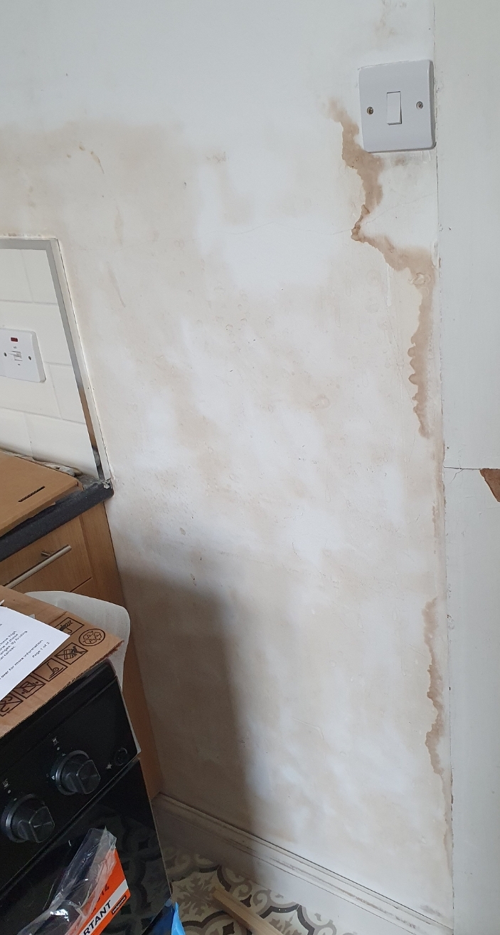

Hi Olly,
Seems you have some contamination withing the masonry. As said use a stain blocker before painting.
Thanks Olly, could thos contamination be dangerous?
You could try a neutralising solution for the salts prior to sealing and painting with stain blocker.
Is the area well ventilated? If there's moisture being generated in the area, your plaster [being porous] might be absorbing it.
It's in the kitchen so lots of moisture. I'm just going to wall paper it plain, then paint over the wallpaper. The stain won't be visible via the wallpaper. Saves getting expensive blocking paint this forum is wonderful, thanks for your help
Looks like condensation/hygroscopic grease stains.
The stain will leech through paper. You need to stain block it.
Also, without warm walls and good ventilation in your kitchen, you're still going to get surface condensation. In my view, it's better to spend a little more time and money to eradicate a problem.
