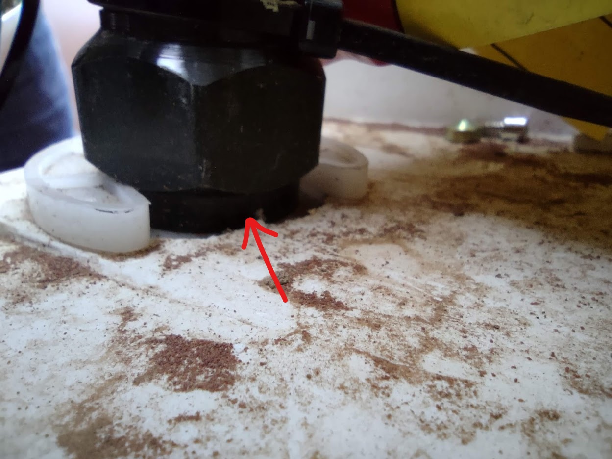

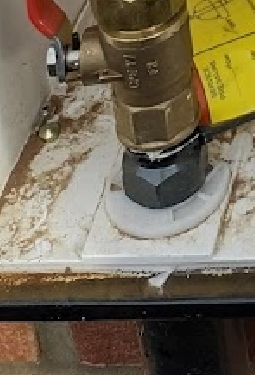

Is this earth wire a problem?
Would you please confirm if the supply pipe is metal or plastic?
Good question. Is it going to be possible for anyone (other than the gas supplier) to be sure, given that all we can see is:
... does the nature of the couplings perhaps enable someone 'in the know' to tell us?
Kind Regards, John
It'll be plastic with a "metal" convertor fitting to allow the brass ECV to be fitted.
As I implied, it certainly might be, but can one be certain?
Well it looks like most MDPE connections to meter boxes i've ever seen. And as a new build it will be as near to guaranteed MDPE as you can get.
I can't be much more certain if I don't actually visit the installation.
