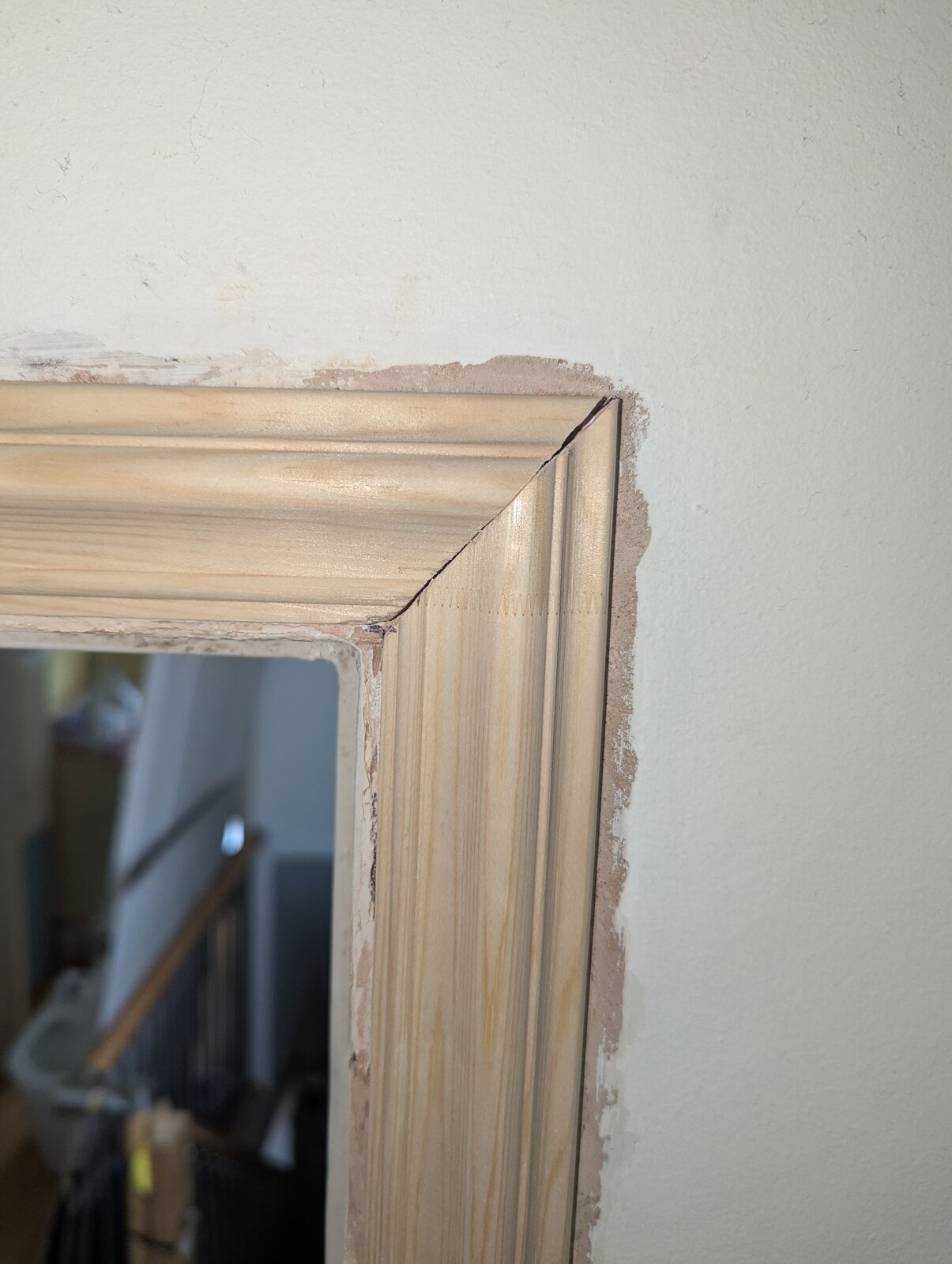

Is this imperfection ok on the architrave?
18 Feb 2025
169
7
Cuts far from perfect as you can see but wondered if this is ok if I fill on with caulk/flexible wood filler?
It's up to you, you have to live with it, I daresay with some good filling it won't really be noticeable, not really acceptable to have paid a professional for it though.
I'd just fill it with caulk or wood filler. It's going to be painted after anyways.
I'm guessing you did it yourself?
If done by yourself, its fine. Wood filler will hide it.
Thanks guys. Yes I did it myself
It's acceptable and retrievable. The casing has probably shrunk a wee bit and/or the wall has had a skim. This means the archies will tend to angle in toward the frame instead of sitting flat. This in turn means the mitre is hard-on or fouling on the outer most point. It can be overcome if you have a decent mitre saw or decent caulking skills.
Be careful with caulk as it can shrink back, causing a bit of recess which will show when you paint. Apply some caulk - remove the excess with a damp kitchen sponge and apply a wee bit more the next day. Otherwise, use a filler.
Great tip. And I think you are spot on with the slight different levels and angling in. Have sanded it all down but still a lip where plaster begins.
Sorry, have one more question. I know normally, you would glue and use lost head nails to hold it in position. But I was wondering if I could skip the nails and clamp it in position instead?
The architrave I got is quite slim and has complex pattern over it. Worried nail would split or ruin the carved pattern.
Frustrating when even the truest of mitre cuts are bamboozled by out of square frames or don't sit nicely on the casing edges.
We have a method of fixing now that allows us to glue the mitres together, before fully pinning them back to the casing. It does mean that there can be a little frame stand off, but this can be corrected with caulk. Otherwise, we glue and fix knock-ons to the casing edges, prior to fitting the archies, especially when we re-skim the walls.
