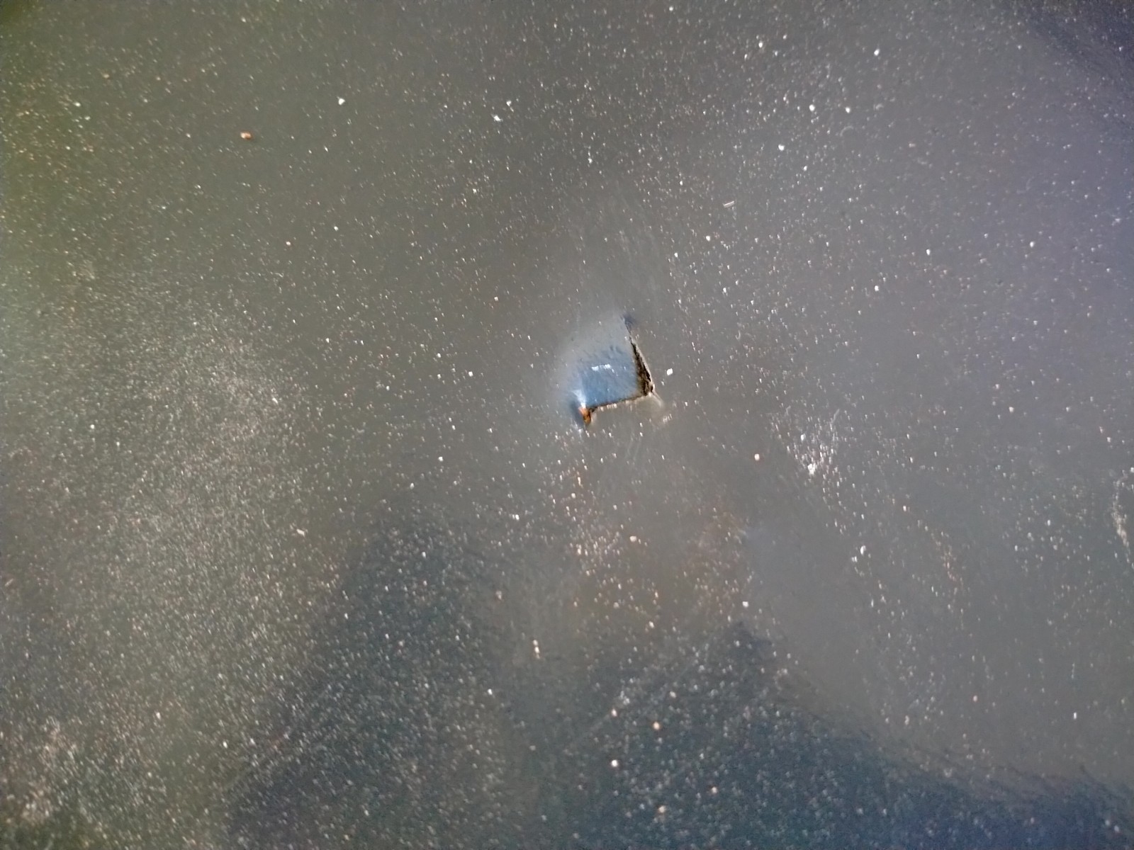

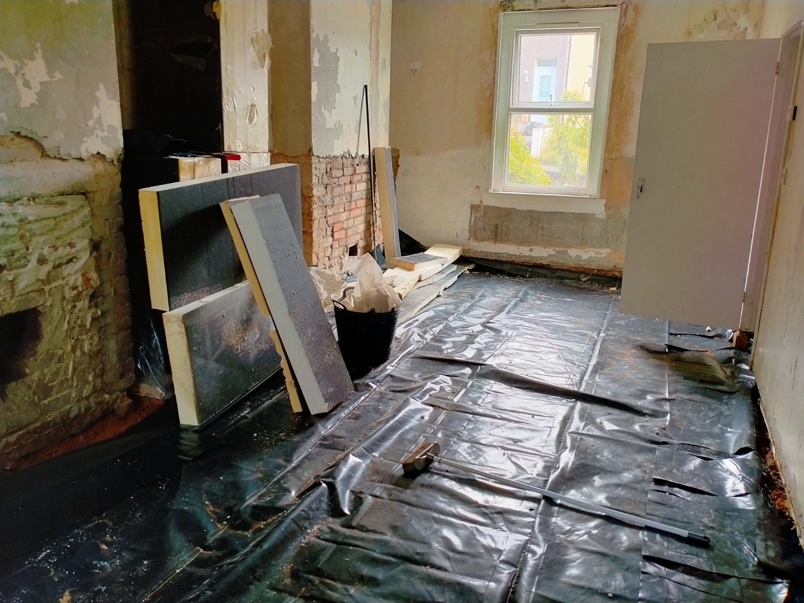

However, we are now at the stage of laying the DPC and insulation. Let me list my concerns. Pictures are included for reference.

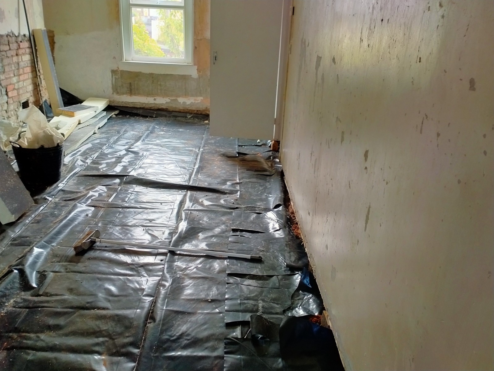

1. At no point has the MOT1 hardcore or sand blinding layer been leveled out. A whacker plate was used for about 10 minutes on the hardcore layer, but not on the sand. As a result, the both the hardcore and sand layer is very bumpy and uneven.

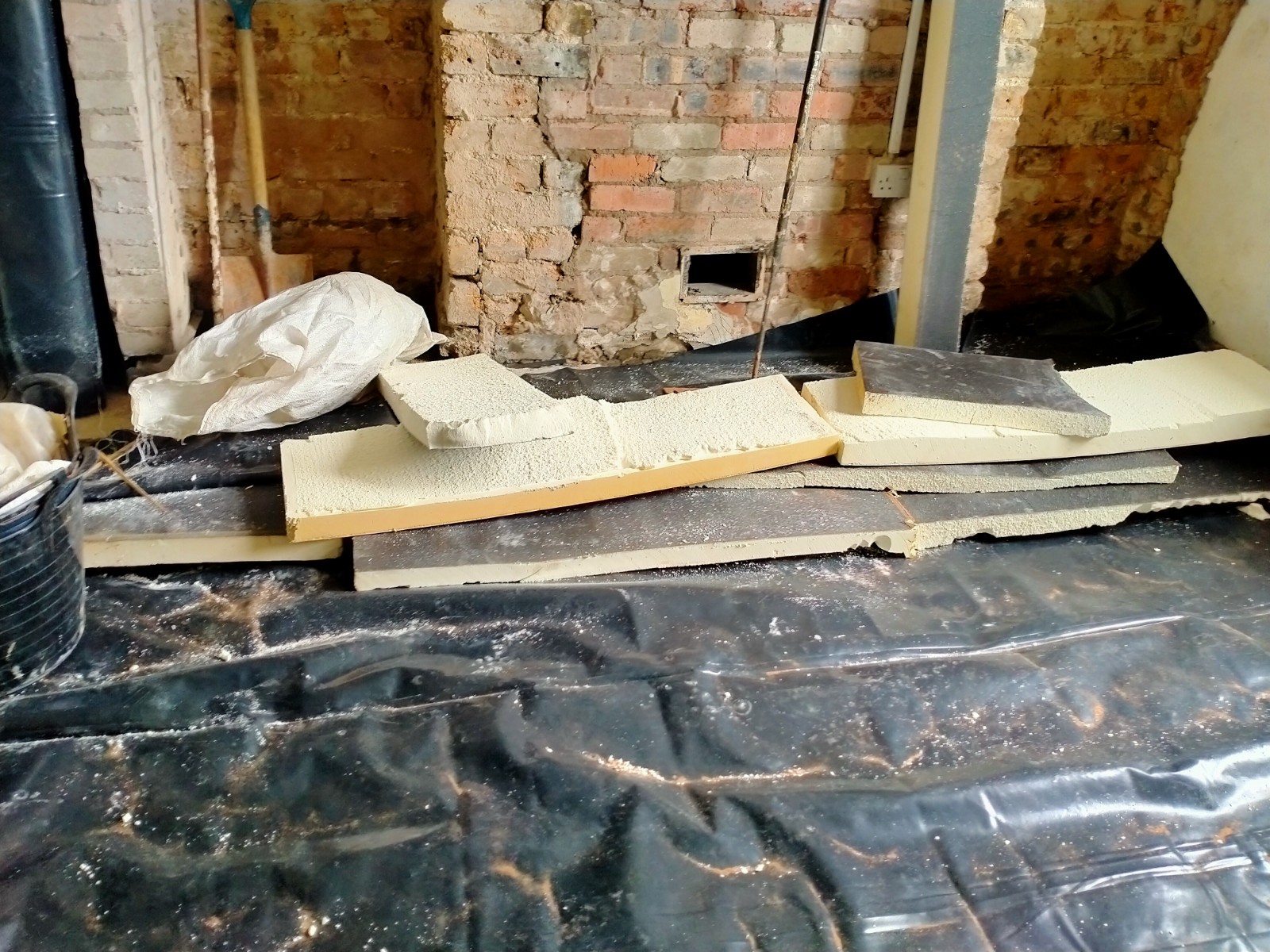

2. The builder purchased 120mm thick insulation boards. These are too thick to allow the correct level, and so he has attempted to cut them in half. As well as being messy and ineffective this has left the boards broken, uneven and with the protective layer on one side only.

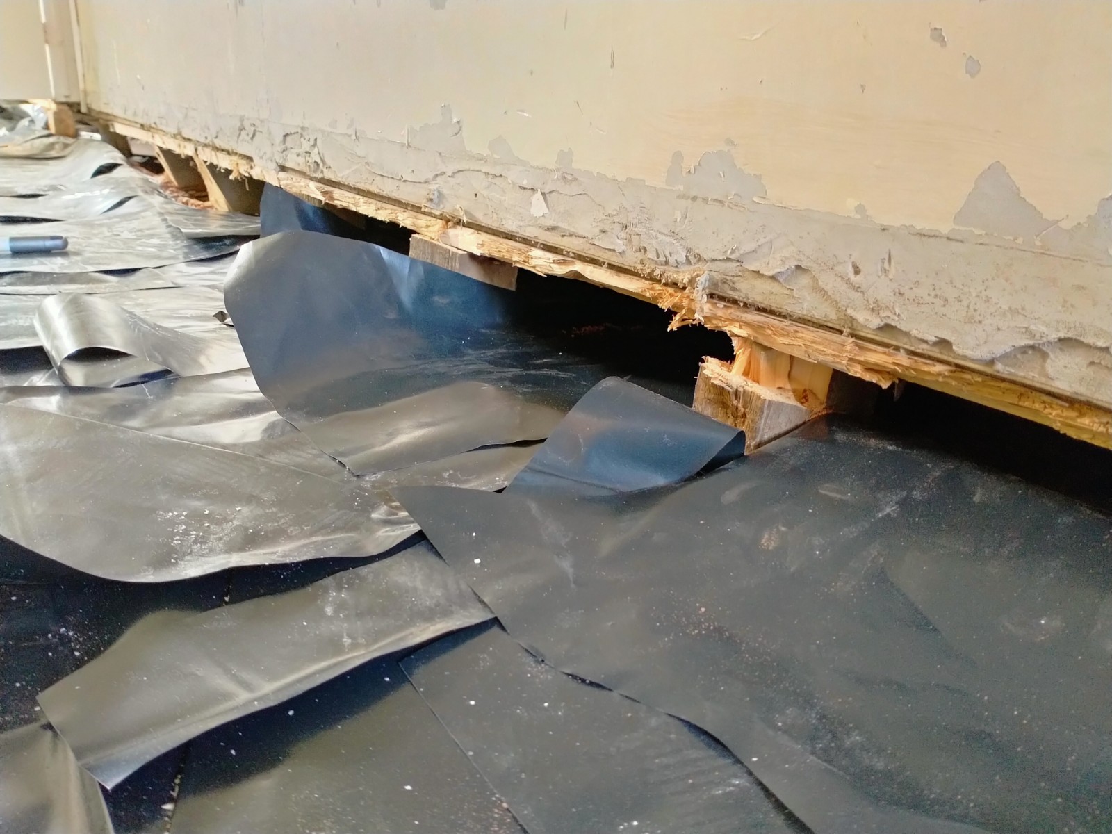

3. During works, a stud wall was propped up on blocks of wood. The wood sits on bare earth. He has cut the DPC around these block to fit...
I'm becoming increasingly concerned of a lack of care and attention to detail. As I understand things, the hardcore layer should be level and completely flat before being blinded with sand. In addition, the insulation boards should have an intact moisture barrier layer on both sides and should lay completely flat on the DPC without any rocking. And I am sure that the blocks holding the wall shouldn't be like that.

1. if the insulation is above the dpm, it doesn't need another protective layer as long as your builder positions a dpm above the insulation as well, but this second dpm can be thinner. It's to prevent moisture from the concrete pour seeping down the joins of the insulation. Normally taping the joints would have been sufficient.
2. Your floor insulation is now not sufficient, I think.
3, Your wall support is a nightmare and is liable to rot pretty quickly, unless your builder removes one support at a time and feeds the dpm under the wall supports, and properly seals the dpm. It will also need a great deal of attention with the second dpm layer to again prevent moisture from the concrete pour seeping down into the insulation.
4. And yes the MOT should have been tamped to refusal, and level, and the sand tamped again. The idea is to get the smaller MOT particles, and the sand particles to permeate and settle between the spaces of the MOT, and to provide an even base for the dpm and insulation.
5. Your builder has cut the insulation sheets into thin strips. They're normally 8 X 4 sheets.

He does plan to put another layer pf DPM on top, but with all the rocking around of the insulation on the uneven ground I don't know how they'll manage the pour and keep it intact, let alone stop the insulation cracking.
The strips were cut there I think to allow fitting around the temporary wall supports.

Out of curiosity, what’s the plan with the wood wedges holding up the wall? Take it these will be left it once the pour starts??
@Mr Chibs Thank you. I can't wait to get stuck into it.
I'm no expert, but I'm guessing a small brick dwarf wall to hold it up. There's a staircase on the other side.
The builder claimed this morning that he was going to take them out. I asked him why he turned my DPC into spaghetti in that case. I can't repeat the reply here.
