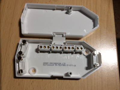

You should replace the rose with a junction box ,a maintenance free one.
The unused earth conductors should be connected together in the junction box.

A ceiling rose is merely a junction box, it`s a bit better looking that a bog standard ordinary junction box because, traditionally, they were often on view. Simple as that.
The Ashley J501 is stocked in just about every electrical distributor. So ask in your local Edwards, CEF etc. Screwfix/Toolstation are not in the same line of busines.
PS It will wait for a day or two. You can buy one from Amazon, delivered to your door, next day.
But, any 4-terminal junction box of a reasonable size would do the job. Like this 20amp, 4 terminal Screwfix item.
Note, these do not have any cable clamps, so you will need to cleat the cable, (once the junction box has been screqwed to the joist)

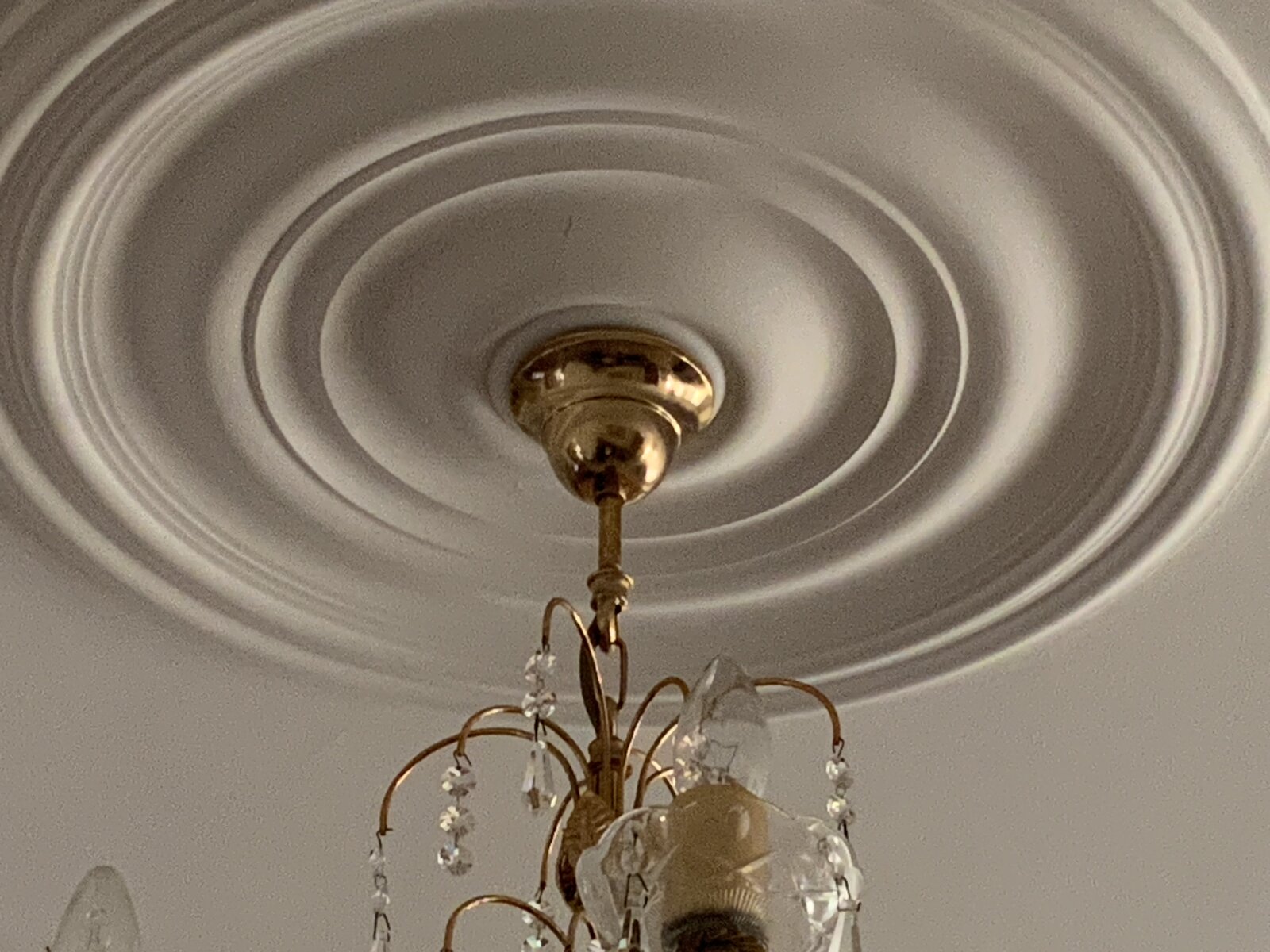

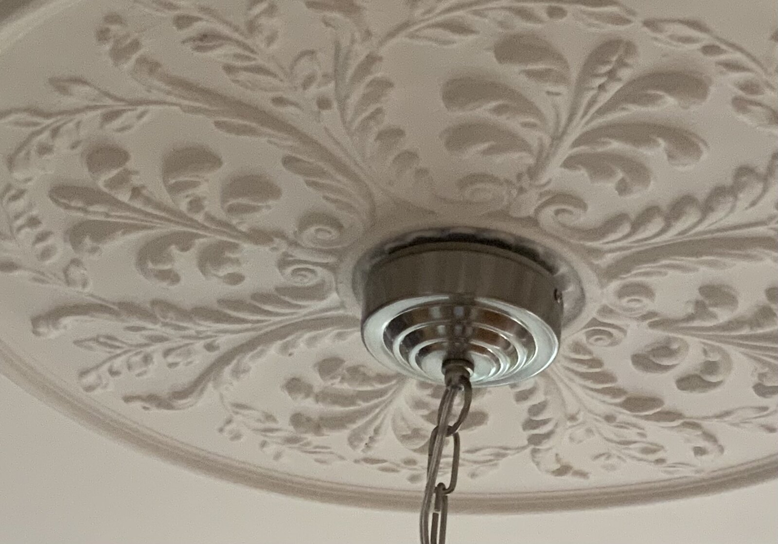

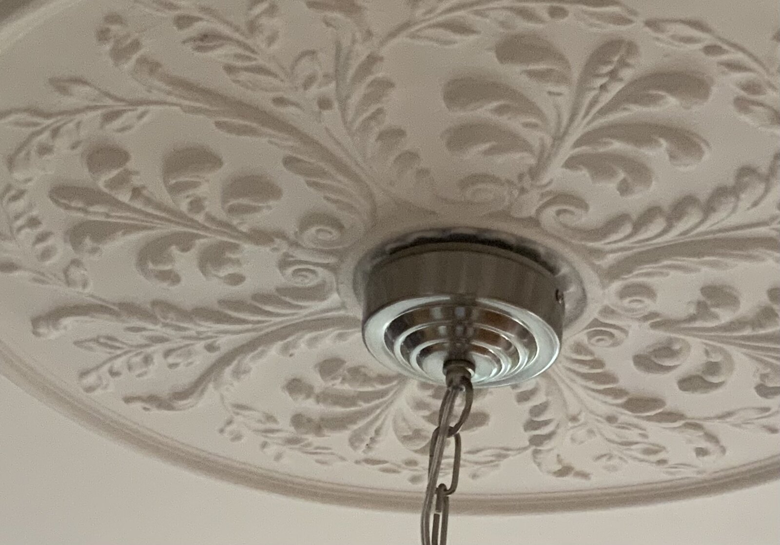

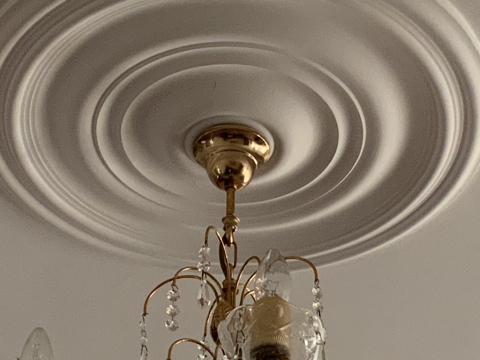

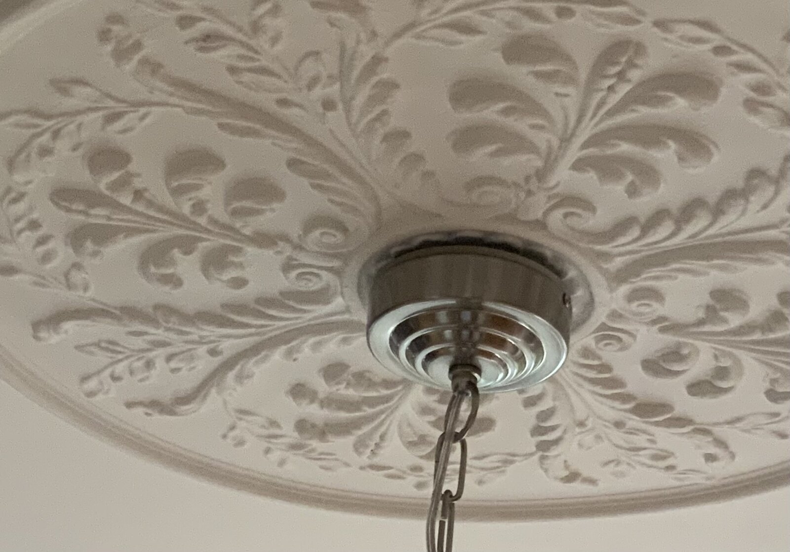

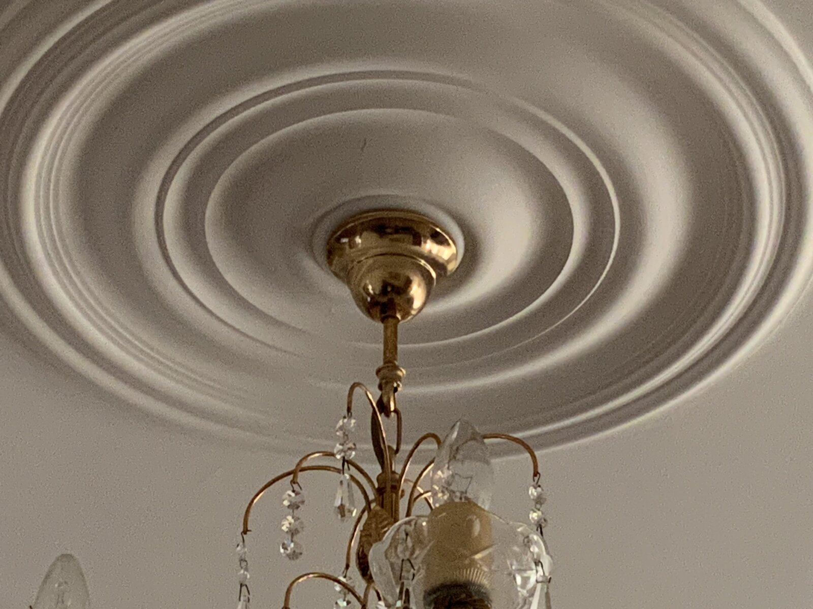

Most of my ceiling roses both upstairs and downstairs are above the ceiling with the flex connecting to the light with a connector block. The light support brackets are securely supported by screws going into noggins above the ceiling. I don’t see how I could fit lights with fittings like this any other way.
View attachment 320273View attachment 320274Most of my ceiling roses both upstairs and downstairs are above the ceiling with the flex connecting to the light with a connector block. The light support brackets are securely supported by screws going into noggins above the ceiling. I don’t see how I could fit lights with fittings like this any other way.
Eh?
Your mansion may well have a "octopus" wiring system, or loop in at the switches...
But that's your problem, and nothing to do with @Sprogginz little issue.

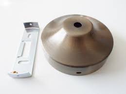

Remove ceiling rose cover. Connect the light fitting then offer it up so the cup part of the light fitting covers the junction (The ceiling rose base plate).
Of course that only applies if the cup is big enough to safely enclose the junction and is properly earthed .
Store the cup away so you can take down the light fitting and re-instate if required later - you move home and want to take the fancy light fitting with you.
Do not attempt this method unless you have sufficient knowledge to make a completely safe job of it.

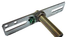

I don’t think that would have worked with mine - what would support the weight of the light? Mine have fittings similar to these which is why I had to have the ceiling rose above the ceiling with just the lamp wire coming through.

It’s not a problem for me and if he follows my example, it shouldn’t be a problem for him.
Ok....but you've just shown pictures of a couple of light fittings. Can you reveal the magical trick you have used that will help @Sprogginz ?
But that is the basic problem that the OP has. Ceiling roses are designed to be screwed to the ceiling. they are not suitable to be used as junction boxes in ceilings voids, lofts etc.
Says who? They have connections inside and all the wires are protected. They've been like that for 30 odd years and several different types of lights so that’s good enough for me. The OP can follow my example if he wants, or yours. I don’t care, I’m just telling the OP what I have done with mine. If he is bothered about the rose protruding above the joist, he could always drill a hole through the centre of the joist, feed all the cables through the joist into the rose, connect up and just have the flex going through the ceiling, making good in whatever way he likes.
There's two ways of doing things. You have bodged it and it will work, maybe it wont, maybe someone will catch their foot in one of the cables when they are up in the loft.....
