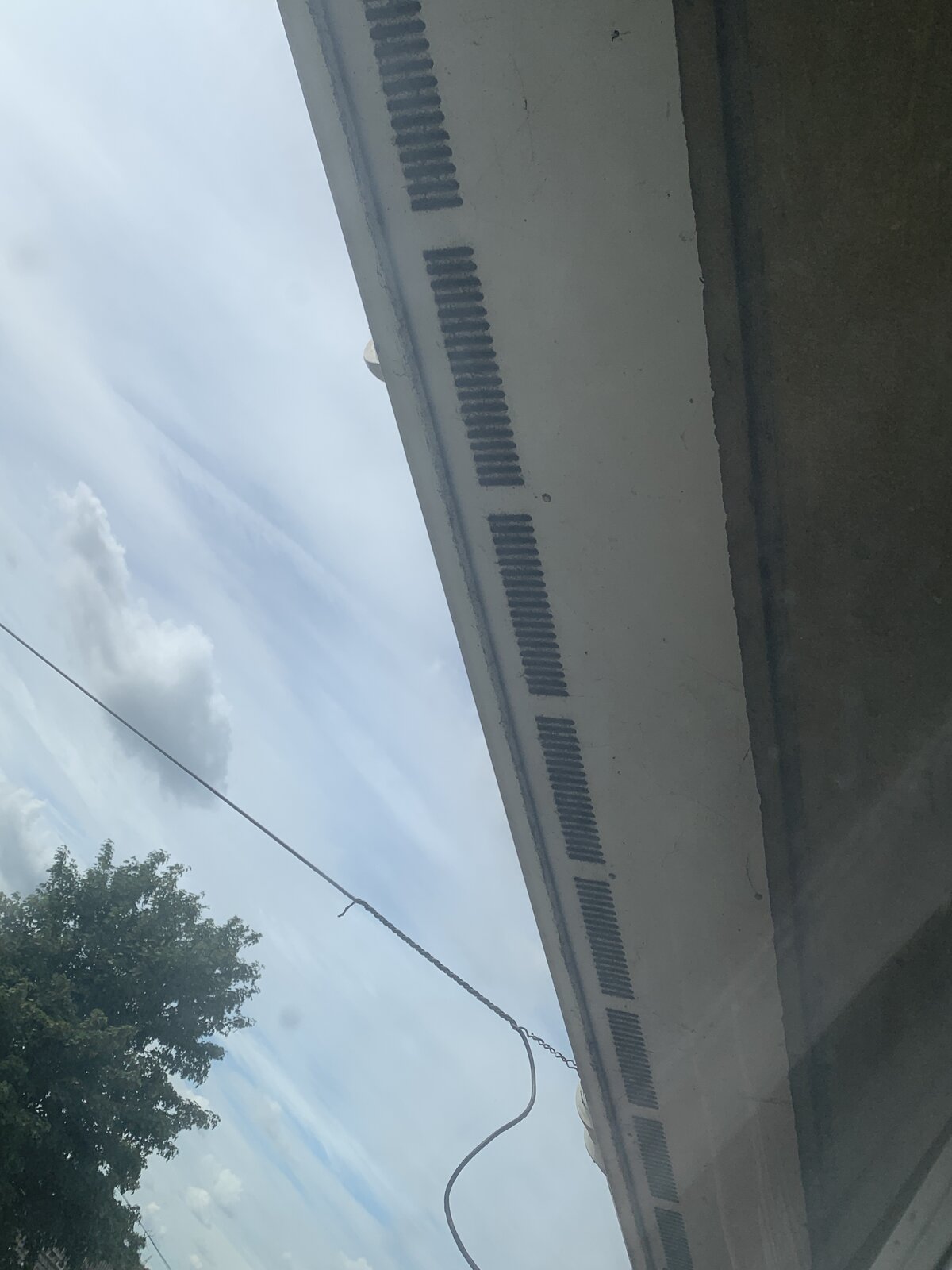

Need to know whether it‘s in poor enough condition to be replaced or can be left alone. None of the images of AIB soffit online look like this one so I’m struggling to tell. Any help is great thanks!
Plus 1 for looking like pvc. An age of the installation/building can help too.

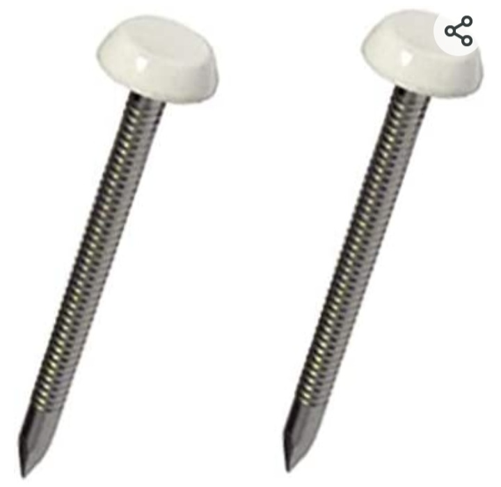

Fitted with capped nails:
It just needs a good clean :)
...although beware, there still could be nasties lurking underneath those soffit boards, should you ever replace them!
