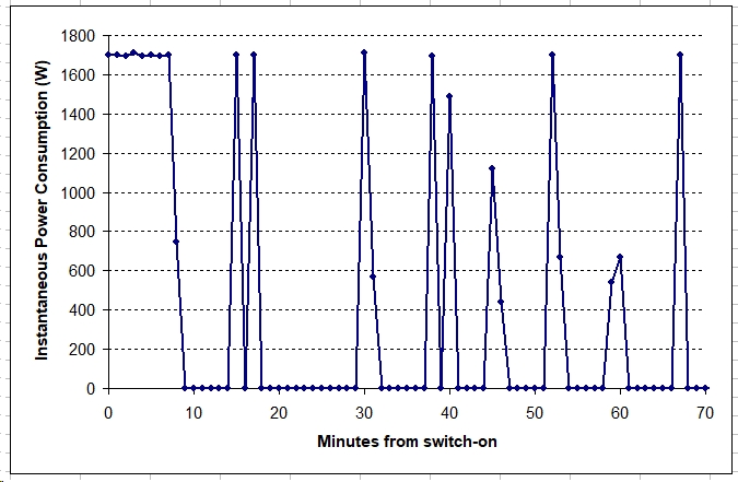

.... "I have no electric cookers, ovens or hobs, so, as I have reported before, I have undertaken experiments using a 1,700 W deep fat fryer, which I switched on from cold and ran for an hour or so at ‘chip frying temperature’. which is probably not a bad model of the likely behaviour of an oven. What I found is illustrated in the graph below."
[ Before someone asks, I should explain that the data plotted are averages over one minute, so the plotted points which are less that 1,700W are due to the element only being 'on' for a portion of the minute in question ]
As you can see, although the frying was 'on' continuously, and keeping the oil at the desired temp (similar to an oven maintaining its cavity ) temp), it was only consuming energy for brief (generally 1-2 minute) periods not all that frequently (roughly once every 10 minutes) - hence a pretty low 'duty ratio' (probably less than 20%).
