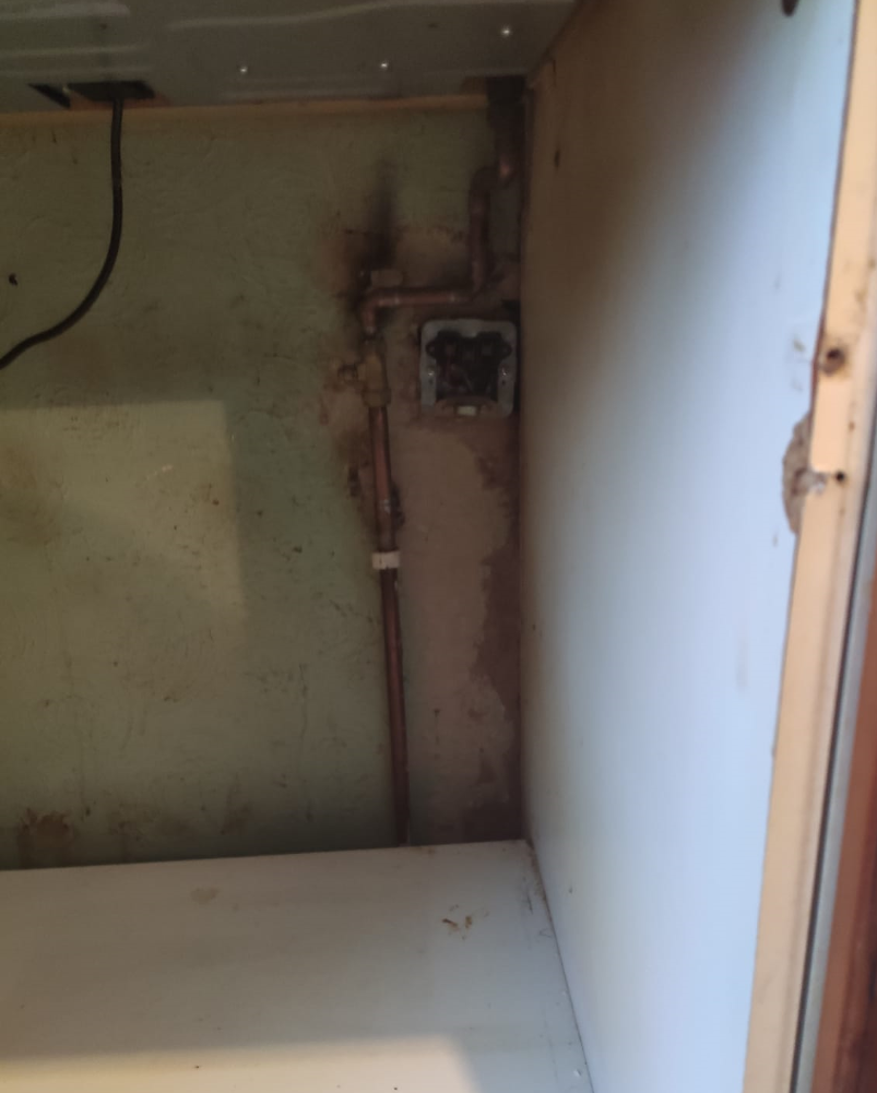

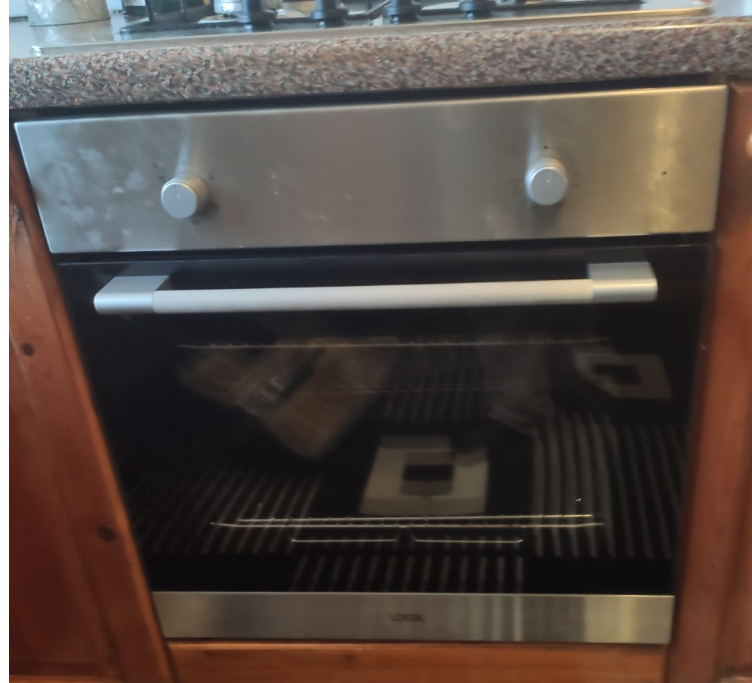

Cable on new replacement oven
They don't make a product suitable to replace that existing cooker panel which contains a fuse.
You could make something out of the grid system but............
Far easier to pull the oven out again, and rid of that nasty T+E too.

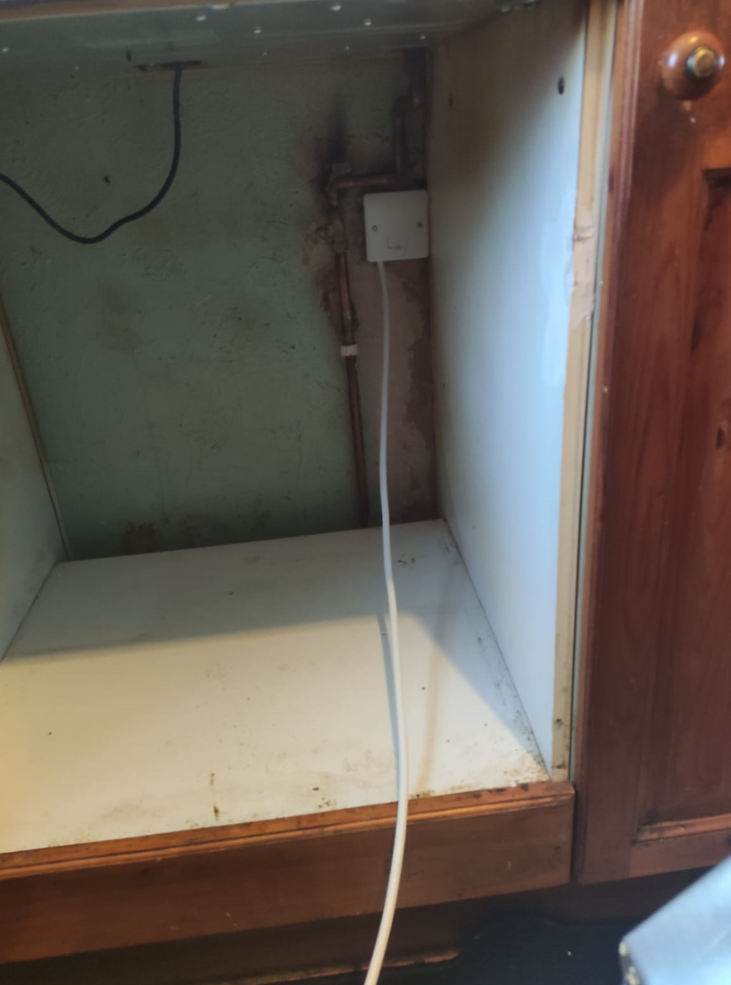

UPDATE: Replaced the connection plate with a 13amp unswitched FCU and ditched the T&E cable for a heat resistant cable
