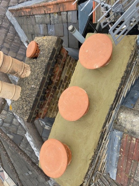

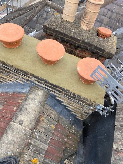

Is this watertight?
First time I've seen chimney pot vents fitted into the flaunching as opposed to being sat in the top of the pot.
Hmm. where are the pots? It should be more water tight than the terminal on the other chimney.
I like the careful way they removed the 9" cannon and replaced it with a 7" spigot. Class. Remind them never to take up plumbing.
i would be concerned that any of the 4 could get blown off.
the vents can only be sunk into the mortar by an inch at most , the actual spigot can be clearly seen on the three
