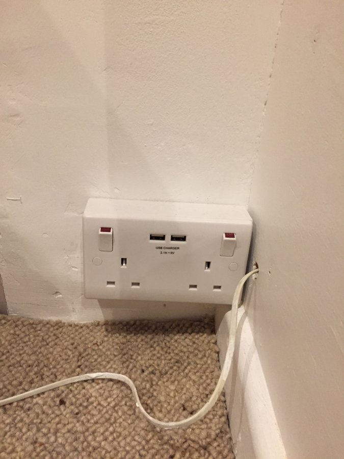

Hi, I have an electrician who installed an extra plug socket by running a wire from an existing socket, please see the attached image. Does this wiring meet safety standards/is it legal?

Assuming the existing socket was suitable to be spurred from, then yes.
Not beautiful, as you can see, but otherwise ok.
White flex would have been better but few seem to care these days.
Did you not discuss the method before he did the work?
The rules about where wires can go and how they should be protected are mostly to avoid hidden wires being damaged, for example by nailing into a wall to hang a picture and hitting a wire that you didn't know was there
If the wire is run along the surface, like this one, it's clearly impossible to accidentally nail through it.
So this is "ugly but not dangerous".
If you were expecting the wire to be buried in the wall - that obviously take much more time for chiselling the slot and plastering over afterwards. That might cost more.

Is this what you expected? Why would you want that fugly mess in your house when it could have been done properly?
I am more concerned about the other side, if the cable is not properly secured it might be pulled out of the socket exposing live wires.
We should be alert to the possibility that maxo is a tenant, and the electrician did discuss it with his customer, i.e. the landlord.
But if maxo is the customer and he didn't ask and just went and did that then I would question his claim to be an electrician.
It's also worth asking where that socket in the photo is, seeing as there is no skirting on the wall on the left suggests it's hidden behind something and not on show anyway.
Not saying that's an excuse to leave untidy wiring, but could explain why he thought that would be ok.

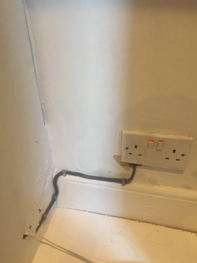

Hi, please see attached the other side with the new socket. The older plug socket in the first photo from which the cable runs from is in a cupboard.

I made same mistake, I did not detail where every socket should go or how it should be wired, I relied on some warranty of skill on the part of the electrician, however there is nothing which does not comply with regulations, even if it does look bad. Odd as it may seem if he buried the cable then it would have likely not complied.
