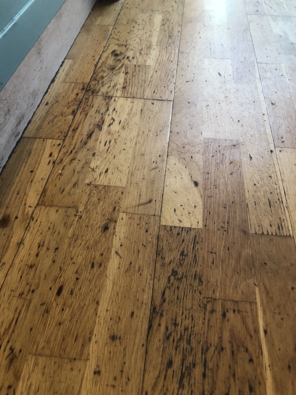

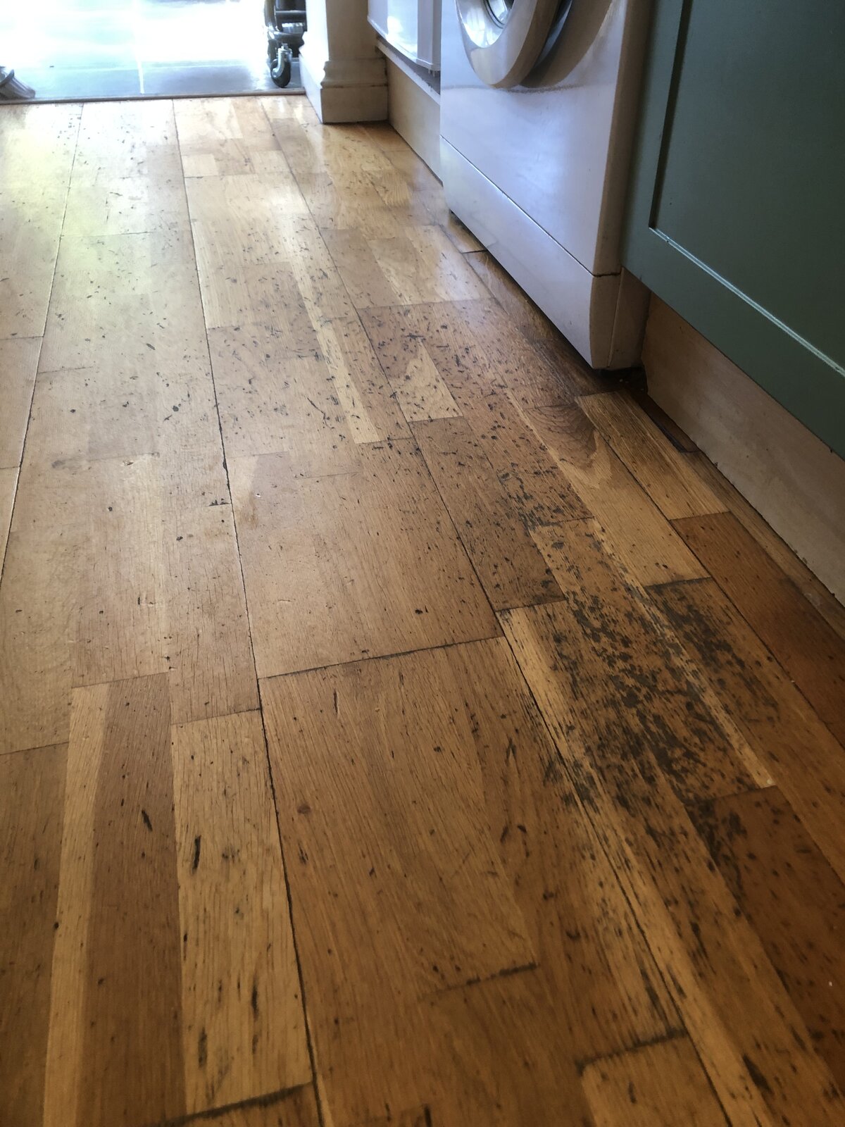

Hi there,
after a long (2 year) property purchase, we moved in! But savings wiped out cos of flipping rent!!!
so need to save as much as possible.
the wood floors below, are they real wood, and if so can I get rid of the scratches by sanding them?
thanks
mark

They look a lot like laminate, although they might be engineered wood, it's difficult to tell from a photo. Sometimes fitters leave offcuts around (beneath the kitchen units is a favourite), or if there is a slot in washing machine it might be possible to pull that out and get a look at the edge to determine what you have. You could alwaysxyry hand sanding a bit - if it's laminate you'll go through the printed paper pretty quickly
Either way, either engineered wood or laminate, they are neither of them good materials for use in a kitchen (as you can see). A short term solution which should last a few years would be to lay a low cost cushioned vinyl floor over the top of that floor. This will probably cost less than the hire of a floor sander, abrasives and finishing materials. I did this on our current house to cover up the ropey-looking stone floor and it was down nearly 5 years before I got around to replacing it

Yes, but you'll need to be careful, as it looks like engineered oak, so the 'oak' layer may only be 4mm+ in thickness, the rest being plywood.
Don't use any wire wool on there, as this can leave fibres that turn the oak black. (similar to what you have).
Oxalic acid can be used to bleach dark wood, cheap on ebay, but you may see where you've applied it, that said it will be better than it is now.
I finished my floor, solid oak, in OSMO hard wax oil, looks great.
Are you sanding the damaged area or the whole floor?
A point about oxallic acid - the wood needs to be clean, grease free and all finish stripped for itvto work properly
