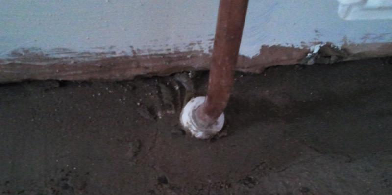

Is this work acceptable (pics)? Central heating system.

Ok it's not great but it's fine, if it doesn't leak I wouldn't worry, big big issue is if that one pipe goes to both valves? If it does it's very wrong on an actual working issue.

It was and still is a one pipe system. I was advised to replace all the old rads. Most of the ground floor pipes have now been renewed. When I saw the corroded old copper pipes I asked for plastic where set in concrete, which the plumber misunderstood as pipes everywhere to be plastic. I did not know that you are to keep plastic fittings accessible. In fact I later asked for the downstairs pipes to be re-located to be behind the skirting since we had to dry line the lounge walls. The builder agreed but today concreted them in. I was, er, surprised to see how this looked:
There is no insulation on the pipes under floorboards Surely this wastes heat? I have tired of challenging the builder - he now just replies "it's fine", or "you never clip pipes under floorboards" and "plastic pipes never go wrong".

The TRV looks like a normal cheapie which almost certainly won't be designed to work on a one pipe system. If that small rad's a single you might get away with it
If this is under the ground floor, pipes should deffo be insulated. (Building regs)
The cemented fitting is dumb -has he entombed the whole pipe?
A bit of pipe insulation could have sleeved it. You never get all the clips the manual says, but this guy's gone a bit far.
If you're going to get a leak it'll be most likely where something's strained at a joint, or a pipe's damaged before it's shoved into the fitting, or things can't move when the pipes heat up & cool.
But woud it "work ok" -as is? Probably, for years. We can pick it to pieces but this standard is depressingly common practice.

So why leave it on a one pipe? , surely it should of been converted to a two pipe considering the pipework required replacing. :confused:
