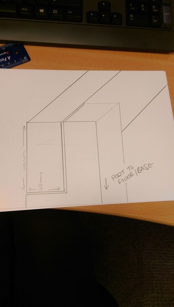

Hi could i not does this?
or would it not be strong enough to carry a boarded roof etc?
If not ill use 100x100mm posts and tops bars also
cheers
not sure I understand your drawing. If the 100x100 is the leg, are you looking at it from above? Or from the end of the carport?
The beam should be running horizontally, on end, so your drawing should show the 100mm width of the leg, with the cutout, and the height, which is much more than your drawing suggests, that's what I had in mind. But cut the leg to the full depth of the beam, and bolt together, will be less able to tip over during construction or strong wind. The depth of the beam is much more important than its width. e.g. you may need 170x44

I see, like this full depth of beam, and with the 107x44 you can sink into the beam as such but cutting down 170mm and using some coach bolts to secure it.
Surely this would make a nicer solid fit, than having a 100mmx100mm post stuck on top bolted down?
Thanks for your time replying :)
yes, that's it.
I would only use one large coach bolt, perhaps with penny washers, in each joint. If you use two screws in outdoor timber it may cause a crack with expansion and contraction from the weather. I am near the coast so I used stainless bolts and screws, not very expensive as you only need a couple of dozen of the big ones.
BTW I used decking timbers for some of my frame, they may have been something like 150x37 and are easily obtainable, pressure treated. Avoid any with big knots.
