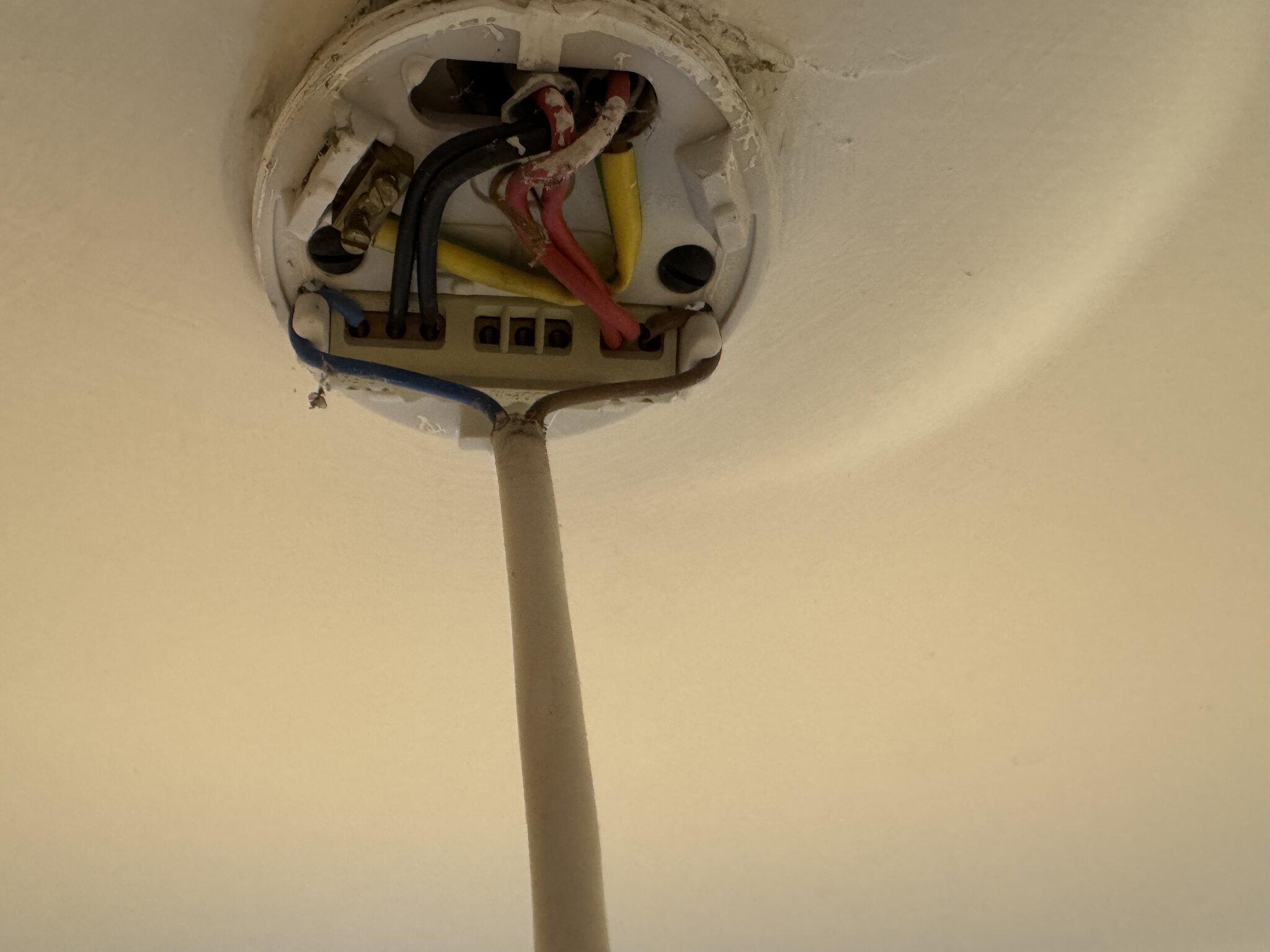

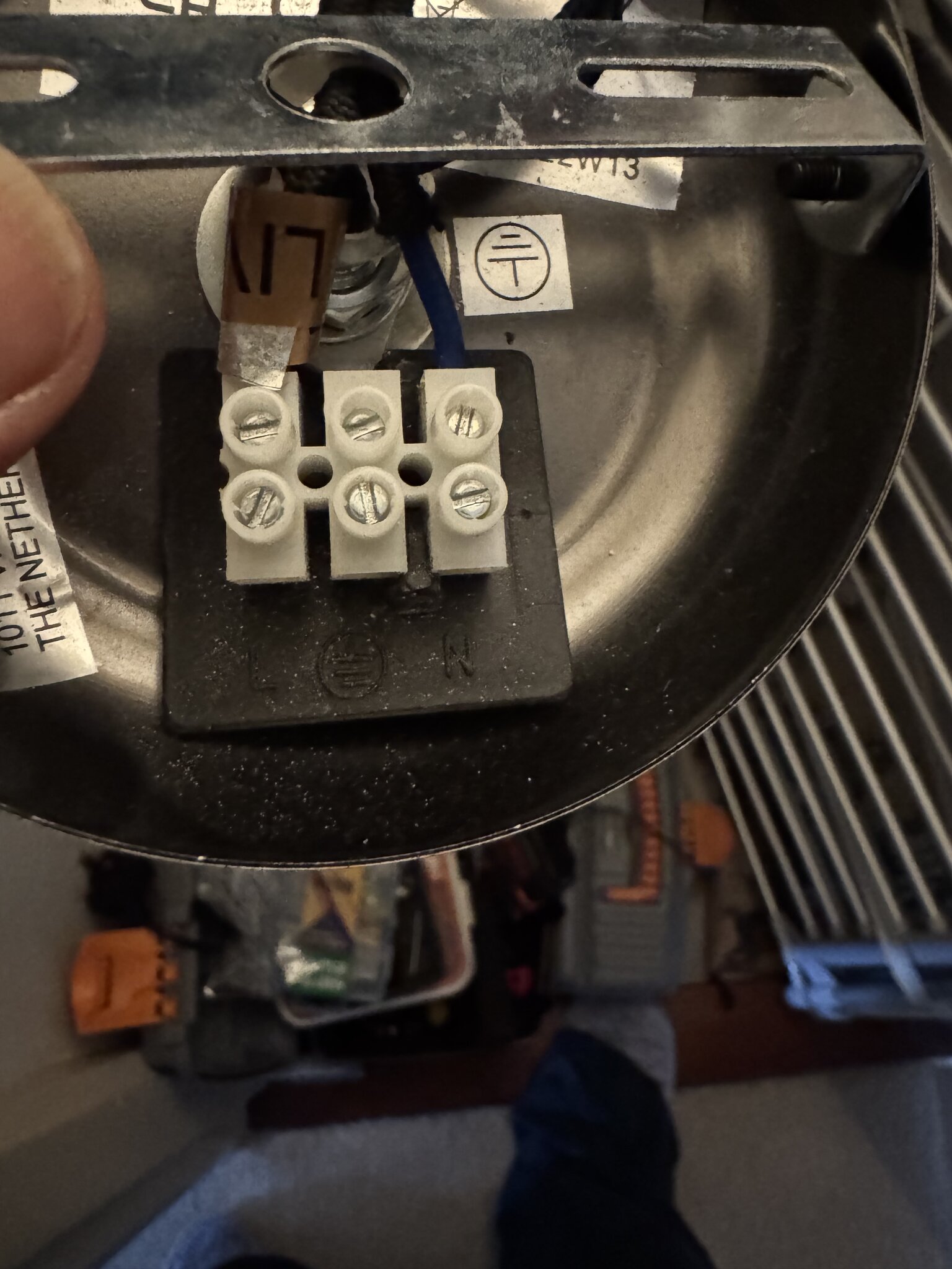

I’m trying to remove this light fitting and fit the 2nd one. I’m guessing Wago is what I need not just shove two wires in one hole!
Also where does the earth go?
Thanks in advance, I’m new to this two switch circuit stuff!
There should be more than one earth wire. They need to go into the new lamp terminal marked with an earth symbol. With suitable earth sleeving.
There is a metal tab connected under the fixing bolt that goes into the other side of the centre terminal.
So when you connect the two earth wires from the lighting circuit to the centre terminal, they will connect to the fitting's body.
