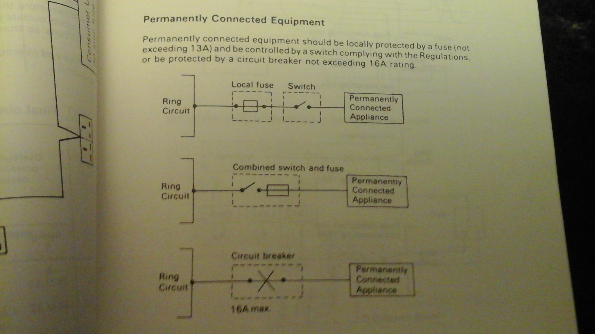

When i trained to the 15th regs there was no appendix 15 and it was acceptable i recall to even put a 16a mcb on the Ring and i believe was shown on early diagrams but not on the current one.
Interesting - and I suppose not particularly illogical - after all, the 13A max for FCUs and SFCUs is fairly arbitrary {in relation to a ring final} and probably essentially reflects the fact that 13A is the largest BS1362 fuse available.
At least now, the regulation itself does not say anything at all about the fused spurs (nor, indeed, 'MCB-protected spurs') hence says nothing about the maximum rating of the fuse rating for such a spur, merely indicating that a ring final may be "with or without unfused spurs" - so I suppose that one could probably argue that MCB-protected spurs (analogous with fused spurs) were permissible, perhaps even ones using a 16A MCB? After all, a 16A load applied at one point of a ring final is 'no worse than' (in fact, 'not as bad as') the load which could be applied at that point of the circuit if a double socket were installed there.
