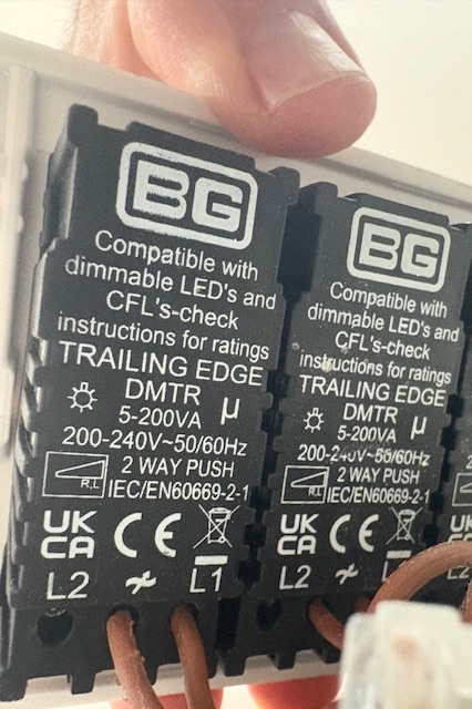

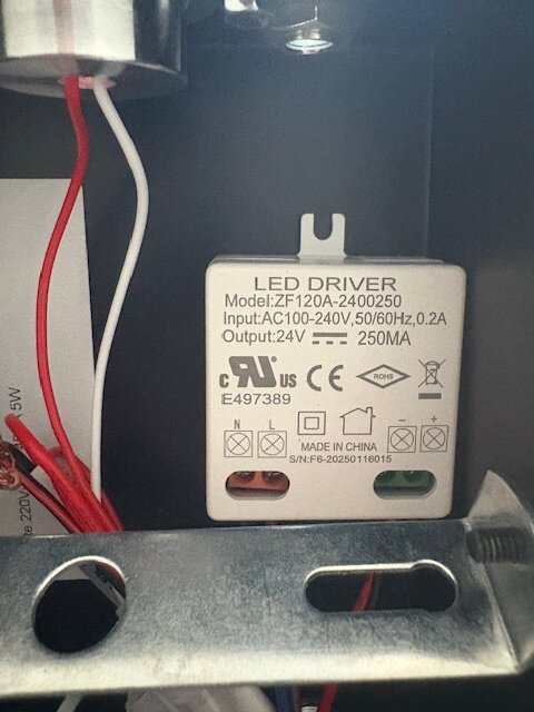

Hi folks - I have an issue with some LED wall lights.
I have 2 wall lights on a dimmer circuit. When both are connected, neither are working (they flicker occasionally but don't light up) - but when only one is connected it works fine - doesn't matter which one it is.
I've tested the lights by hooking them directly to the mains away from the circuit and both are working fine. I've also tested the circuit connection when one of the lights is powered on and its showing 220V.
The attached pictures show the LED driver in the lights and the dimmer switch module.
Would really appreciate it if someone could suggest a solution! Thanks in advance.
They’re advertised as dimmable but I don’t need them to be.
I think the best option will be for me to switch out the dimmer module in the 4 gang with a dummy dimmer 2 way switch module.
If you are confident about doing that , please update us
Replaced the dimmer module with a dummy dimmer 2 way switch and its worked a treat.
