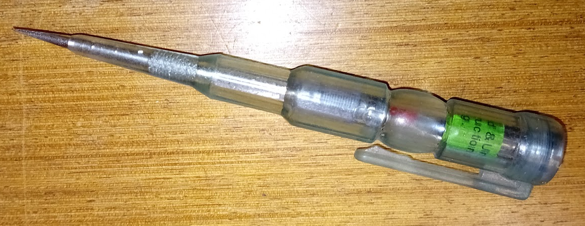

Can you afford a multimeter?
That's because you've connected it wrong.
You didn't note the old connections, did you?
That’s only a voltage indicator, no good as a multimeter.
Correct but completely adequate for resolving the problem in this case.

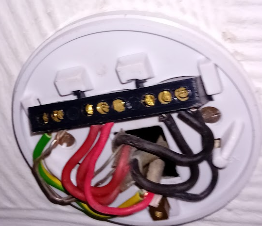

I didn't bother getting any of these out:
The light was about 5ft from this rose which tested as the 1mm² T&E, I suspect the customer had removed the original light fitting and fitted this rose in it's place as a junction box lthough he made no comment tpo that end.
I wonder if they kept the 'spare' earth terminal screw, or if it had fallen out first, which may have helped lead to this predicament?
I don't know, I took the 'spare' from the loop bar to bring it back into use and of course added some earth sleeve.

In this case it was reported as just started blowing the fuse and when I asked what changes had been made it was a blatant 'Nothing has changed'. the 'remaining' light in the centre of the room looks new and this rose was near the window, I could see a metal fitting in the wheeliebin. So I believe what happend was the new light was fitted in the new position using a piece of red/black T&E and the rose added as a JB, of course I don't know that to be the case but everything pointed that way.
