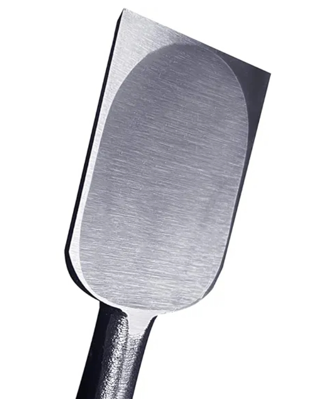

Is anyone using Japanese wood chisels?
I've been looking at trying some out, and seeing what everyone is raving about, but one thing that bothers me is the apparent small scope for resharpening.
The backs are hollow ground, so it occurs to me that after a few sharpenings, there is no flat edge left to form the bevel.
Is there something I'm missing?

It looks like you eventually need to grind the back of the chisel as time progresses
Yes, there may be. I did try a small set of Japanese chisels back in the early 1980s when Roger's were the only people importing them (remember them, pre-Sarjents of Reading and Axminster?). Amazingly sharp (when properly sharpened - but it requires the right stones), but liable to chip far too easily on hardwoods such as oak and maple IMHO.
To maintain them you are supposed to flatten the back every time you sharpen them, in which case the hollows will retreat up the back, thus (image found on the 'net):
That hollow is called Ura or Urasaki (I've just had to look that up as I just couldn't remember the exact word) and is created by hammer forging. From a couple of books I read on the subject at the time, I recall that if you do grind the back flat you should either get an anvil and a hammer and reforge the Ura or send the chisels back to the maker to have them reforged - supposedly every 5 to 10 years in Japan... (like that was ever going to happen with mine)

Oh I see. Seems like it's a case of not just a lot of sharpening but a lot of work on the bottom edge too. I think that would put be right off unless there was a massive difference in performance to offset this.
