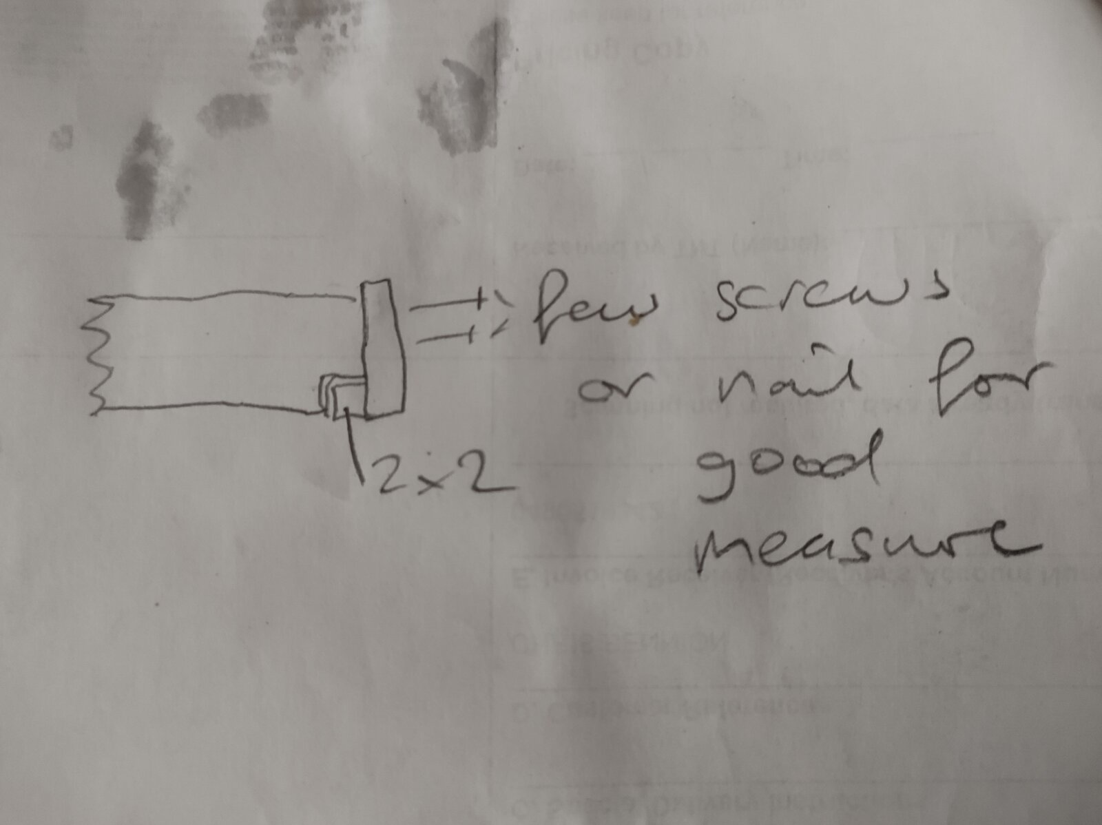

Cheaper than a 2x2 and notched joists?

Old skool:
Ah ok! I've already got it all in place, taking it all apart for that would be a nightmare! :) Next time maybe.
I think it'll have to be joist hangers, I just dont know how to tell if the ones I am looking at are 'strong' enough - it'll be an office and gym, some heavy-ish equipment (running machine, maybe a weights machine/setup.
A couple of stout nails, partly pre-drilled to ensure they hammer in straight and don't split the wood.
