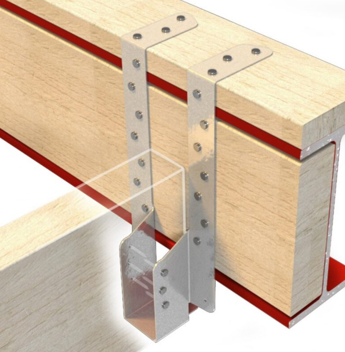

Just fold(hammer) any proud part of the top of the hanger down over the relevant joist
If your complaint is that a right angled part of the hanger is proud, hammer and chisel to split it into two fingers on the right angle, then hammer them flat
I used the 3mm face fix ones, they are much thicker and don't bend like those ones.
