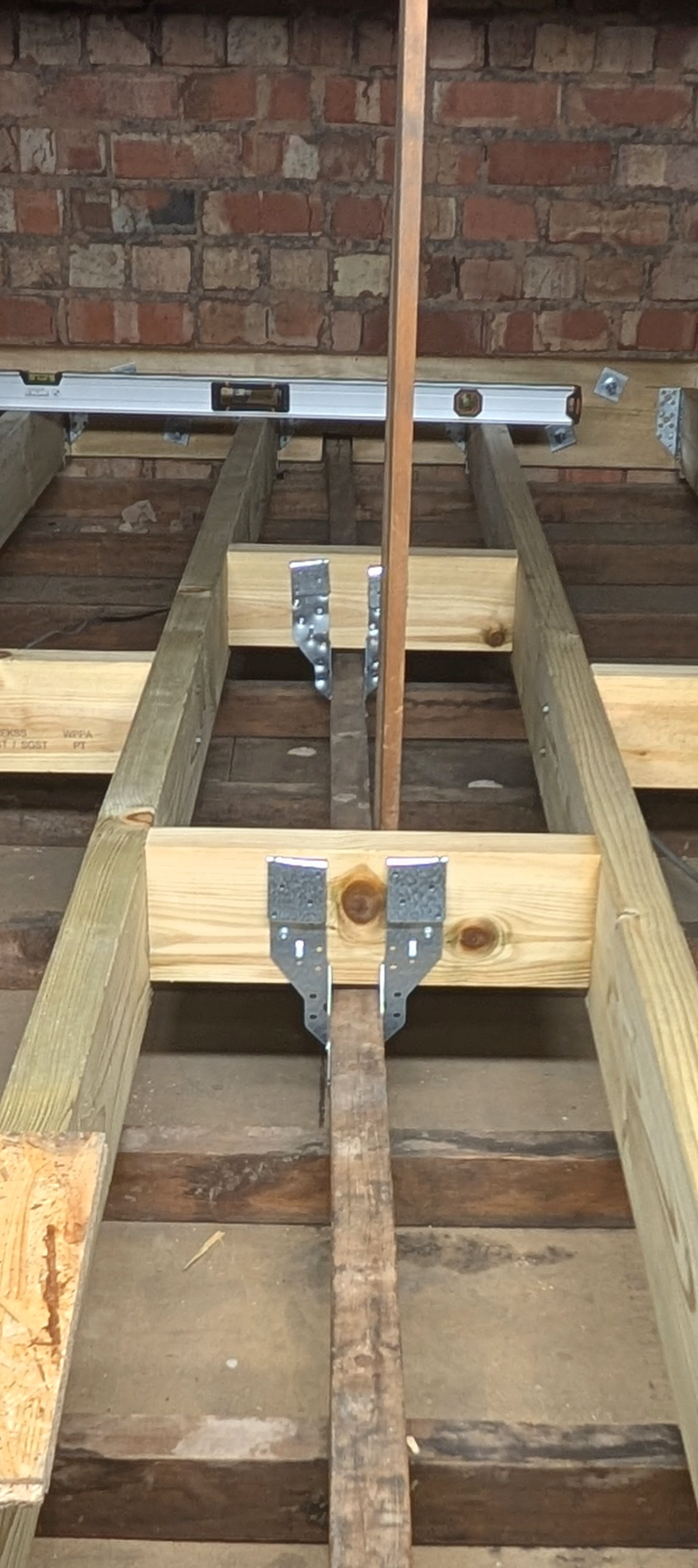

Joist hangers too big for joists?

Plane it now. It will take a few minutes, vs trying to fix it later if you do find it noticeable.
I don't know what to do now. I wanted to get the job as perfect as possible. You can't see any deviation in the floor when looking at it visually but if I put my level across it it pivots on the high spot so that it's a 3mm gap either side. But it might settle on its own?
Just plane it….. I cannot imagine a scenario where you wish you hadn’t made the floor flatter.
You may not notice it by eye, but if you have a hard floor things roll around.
I put a level all around the last one I laid, and got it as flat as I could. I spent as much time getting the tools set up as I did planing!
It's a bit annoying as the rest of my loft floor was flat as a pancake I didn't have any issues like this. But these longer 2x6s were more awkward to get right.

Yeah there is a big gap to the existing ceiling although it's worth me also raising something else here then to confirm I've done the right thing.
The existing ceiling is quite badly sagged/dished. A piece of timber has been hung from from the ridge beam at some point in the past to try to stop the ceiling sagging.
To try and strengthen this and prevent future sag I have connected the existing ceiling cross brace to my new joist work as extra support. Should I have done this?

Well now if there is any sag in your new floor that will definitely be replicated in your ceiling.

Yes I realise this now, if the new joists sag it will push down on the existing ceiling. Maybe I should remove these (I still can) so that the new floor is completely independent. I just wanted to try and make the existing ceiling stronger given how badly sagged it is (2" in the middle compared to the edges).

It is only for light loft storage yes, but the span was 3.4m and I didn't want to put any load on the existing ceiling hence building a new framework over (also wanted the c270mm depth for insulation which I have achieved). I used 8nr 6x2s at 400mm centres for a 3.4m span and 2.8m width, which seemed ok based on span tables. Its supported by the resin fixed ledger beam (8x2) at one end and resting on a supporting brick internal wall at the other end. I have tried to do things properly, as best I could working in the constraints of an existing loft.

Yeah the ceiling is already nicely plastered and you can't really see the sag in it from the room itself, its much more obvious looking at it from the top in the loft. The ceiling joists, whilst sagged, are not rotten in any way, and they span from wall plate to wall plate and are nailed into the rafters at each end as well. I don't really want to disturb it, but I would have liked to provide some additional support to it to stop it sagging any further.
Maybe I can do something off the existing roof purlins, that way it keeps my new floor separate.
Oh lumme, just stick some boards down on what you have and move on.
Should I remove the hangers I installed to decouple the existing ceiling from the new joists?
Looking at this instead to strap the ceiling joist to a purlin above.
