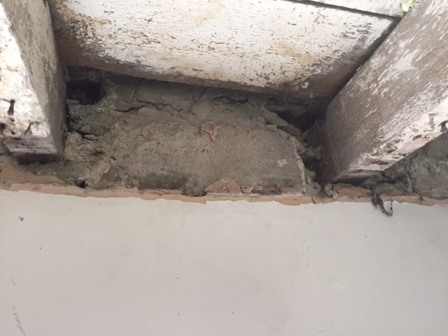

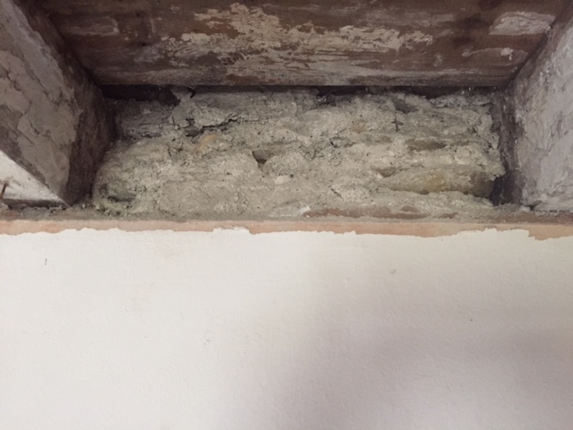

Work out where your joists hangers will fall and use the joist bay spaces for fixing the ledger bolts.
Open up pockets in the joist bays, and fill with a packed sand and cement and chippings mix.
Allow 24 - 48 hrs to dry, and then offer up the ledger using expanding bolts into the pockets.
Line the back of the ledger with DPC material.

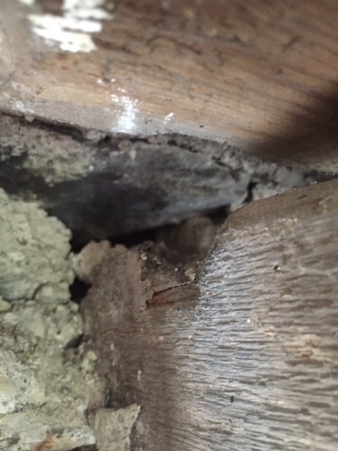

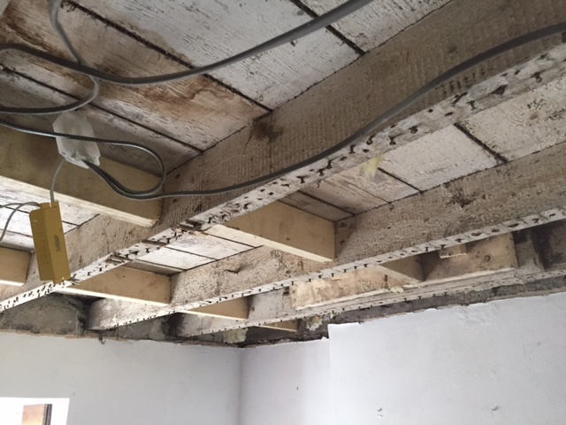

Able to add a couple of PICs, please see state of wall, and a closeup of where one of the joist has dropped over time. the cross pieces I added when we bought he property just to add some strength, which it has done short term.
The ledger still seems easier than making bigger pockets.
Just seems in my mind a wall pocket is stronger than a wall ledger, probably not, same principal as kitchen cupboards lots of vertical stress rather than horizontal, just my brain over thinking. I located some Rawl m16 bolts which seem a fair size.

Why not just use the same socket-holes for your new joists? If you are using 9"x2"s, you can notch the ends of the joists down to 5" without there being any problem. The tricky bit would be the clearance to get the joists in - that depends on how much wall-thickness you have to play with. You can have the cut-down ends 6-8" long if that helps manouver them in. If you can get at least 2" bearing, that would suffice.
Hi Tony, in reality that would be easier if I can do that.
The current beams go back about 6 inches so should be enough to make a ledge of 3 maybe 4 inches with a little fettling and jiggling.
Would cutting down not take away from integrity of the beam if down to 5 inches
1 - yes
2 - 1/packing
simply space them out.
Strange as it may seem, the answer is - no.
Look at it this way; you currently have 5" deep joists. They have not collapsed, but are a bit springy.
If your joists are 9" deep for the vast majority of their span, they will deflect (ie bounce) far less than the 5" deep joists,
even though you have cut them down to 5" at the bearings.
The only force on the timber at the bearings is shear force, and with domestic floor joists, that is never an issue.
Cut down to 5" x 2" at the bearing, a C16 joist would support about 5.5 kn (approx 1/2 ton) before it failed in shear.
