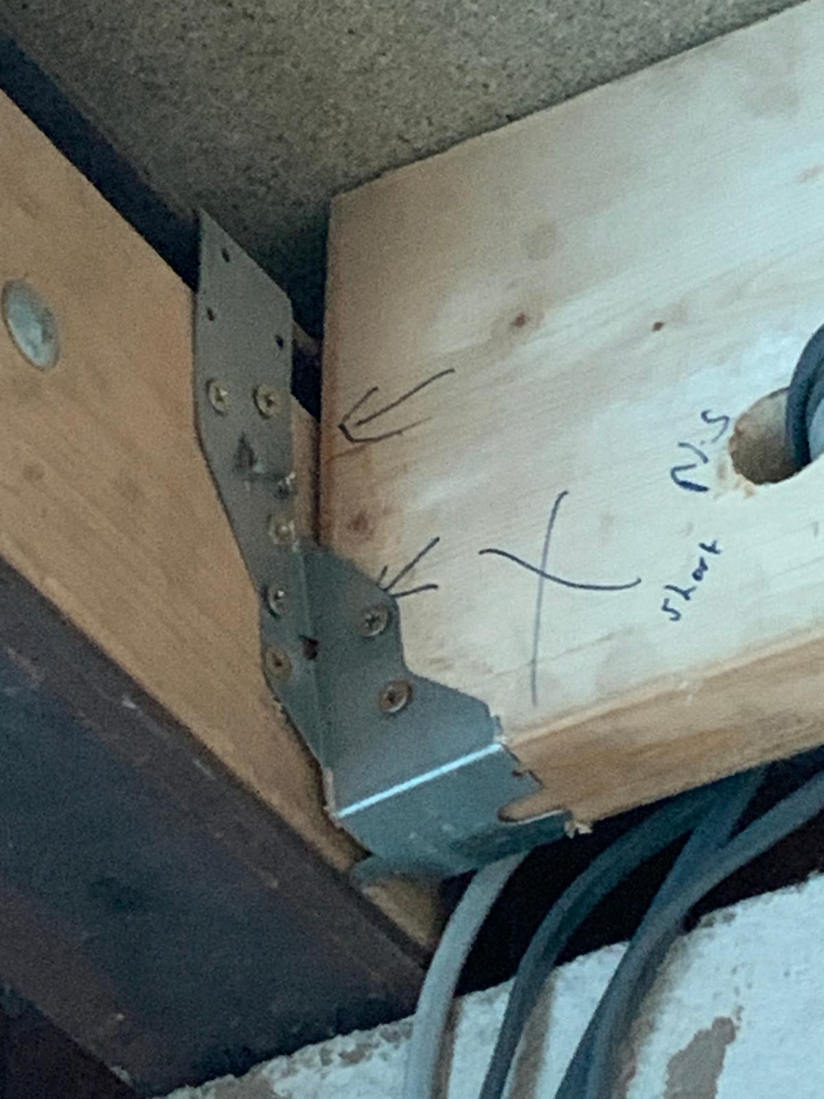

Hi, just wanted to ask….
My builder has used spax yellow pozi csk pz2 5.0x50mm screws for the joist hangers (1st floor ceiling/attick floor)
just wanted to ask if anyone else has used these screws for joist hangers and are they ok to use?
Into the joist √
Into Trimmer joist - wrapped over √; not wrapped over then 75 or longer 6mm
Into brickwork 75mm or 100mm 6mm
If they used nails into joist then those would be ~4x45/50/60mm ring nails.
Minimum of 75% of holes in hanger populated.
That what I do, use.
Usually the spec calls for square twisted nails and not screws although CSA screws are designed for hangers.
Generic wood screws are not suitable.
Would I need to take all these out and redo? The whole first floor has been done using the spax screws…..
Into the joist √

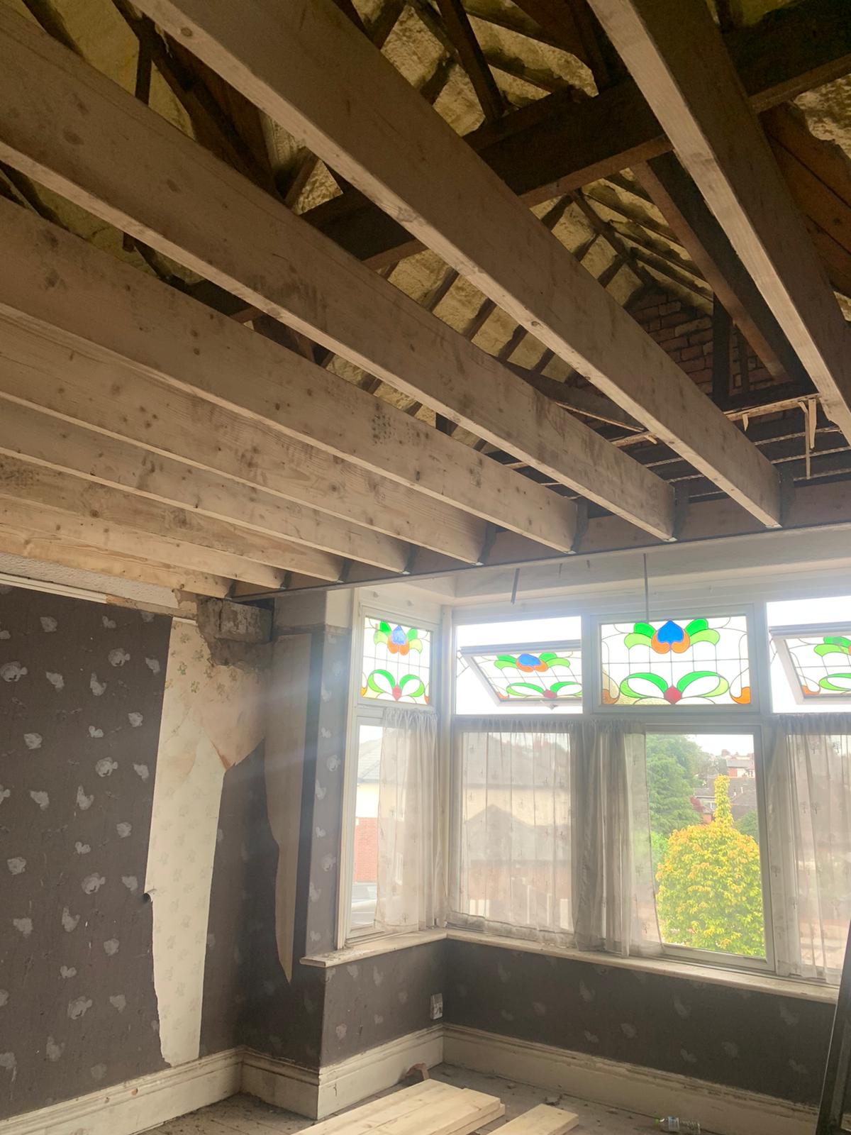

Yes they go into the joist, i am so worried because the builder has completed the whole first floor. The joists will become the attick floor and ceiling of the first floor. The building inspector didnt bother asking what screws they were and said everything is fine.
All the holes in the hanger are populated

And the BI let them off not wrapping the hangers over the top of the trimmer joist! I'd be questioning that approval failure.
The joist hangers will be wrapped over. Ive just rang the building inspector and he said these screws should be fine and there is so many of them that it shouldnt cause a problem…… what are your throughts? Should i leave or re do it all with different screws or nails?
