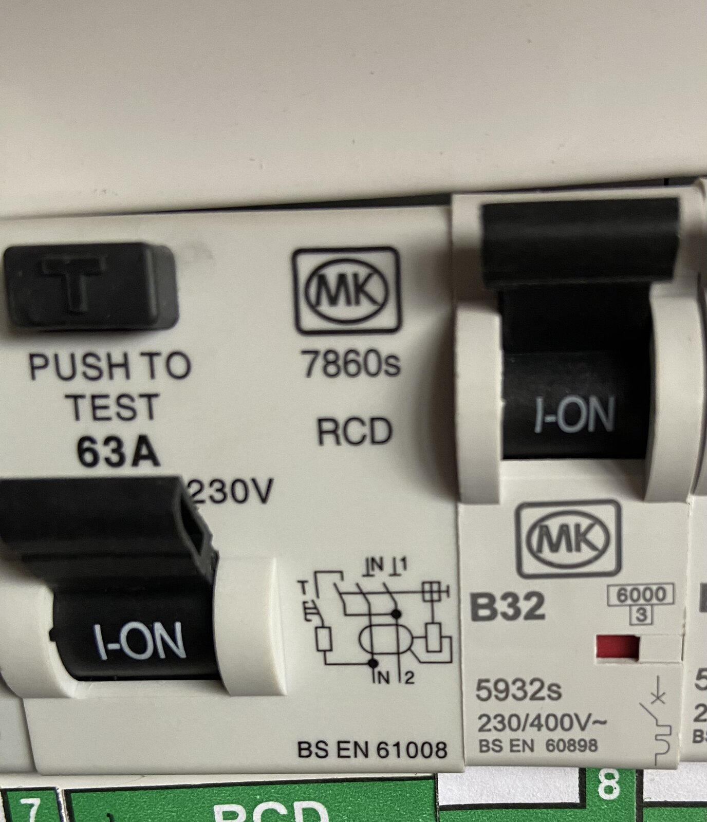

Hi, quick query, without all the extra info.
I want to add another double socket in a bedroom.
The socket that is in there which would ideally spur’d off is already a spur.
I’ve traced the wiring back to a junction box which also serves another set of sockets I believe to other bedrooms (I’ve to investigate this further)
Is it ok to put a fused spur between the junction box and the sockets?
Ie - JB/2.5 TE/FCU/1.5TE/2 x double socket (bedrooms x2)
Yes, but check the other sockets are not spurs on spurs
Thanks for the reply, I’m a little concerned they are likely to be spurs on spurs from what can make out, but need to trace them properly.
B32

32 amp breaker suggest a ring main, as your cable is 2.5mm2, so one double socket per spur unless protected by a FCU as I understand it.

So just for clarity, if this junction box serves other sockets on different 2.5 te wires particularly if it looks to spur from a spur, it would be safe to put in and FCU on each spur wire prior to the first socket?
Is there any disadvantage to dropping to 1.5mm TE for the sockets after the FCU or is it potentially preferable to stick with 2.5TE throughout?
