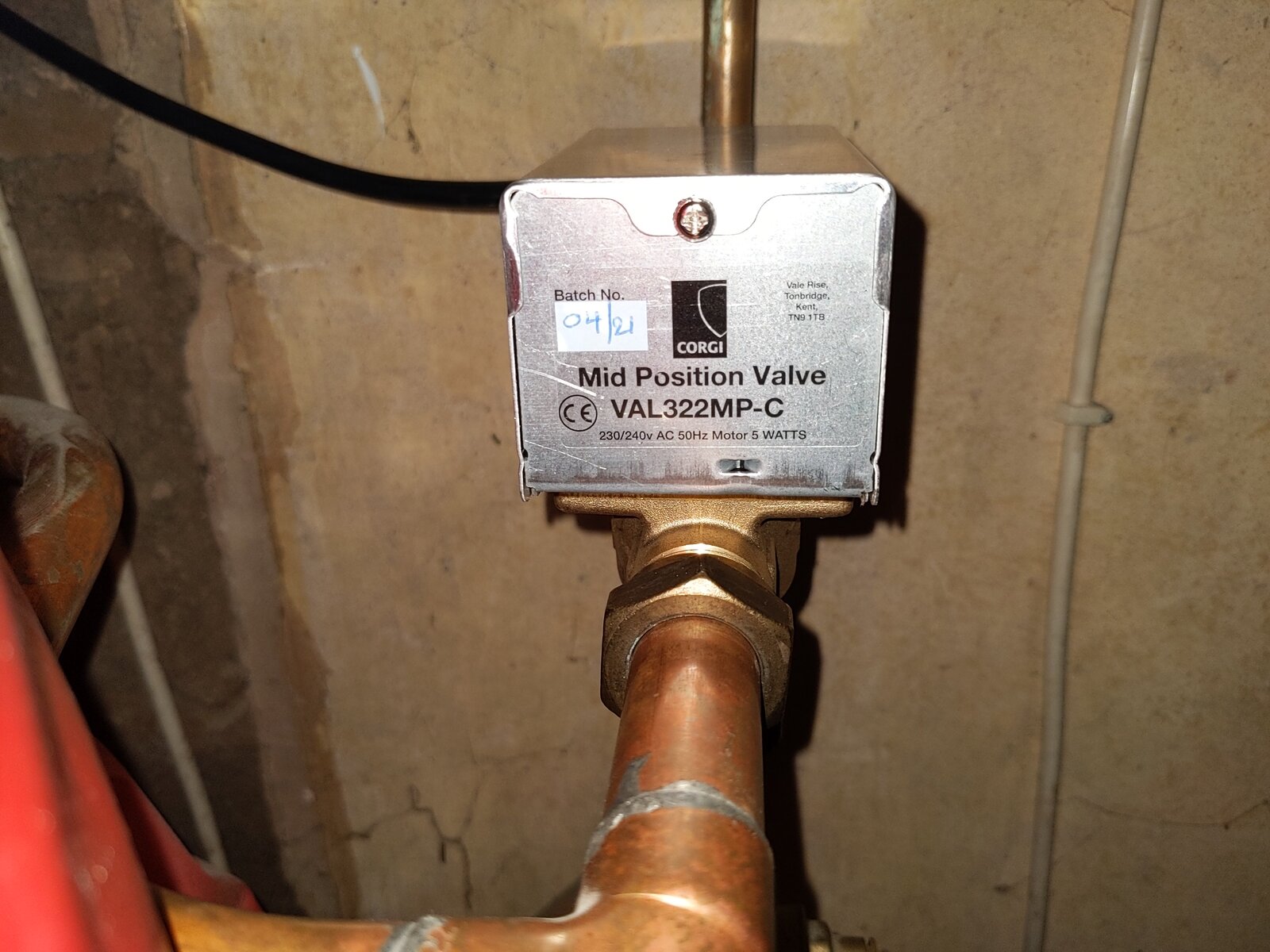

Just changed 3 port valve. Boiler wont fire up.

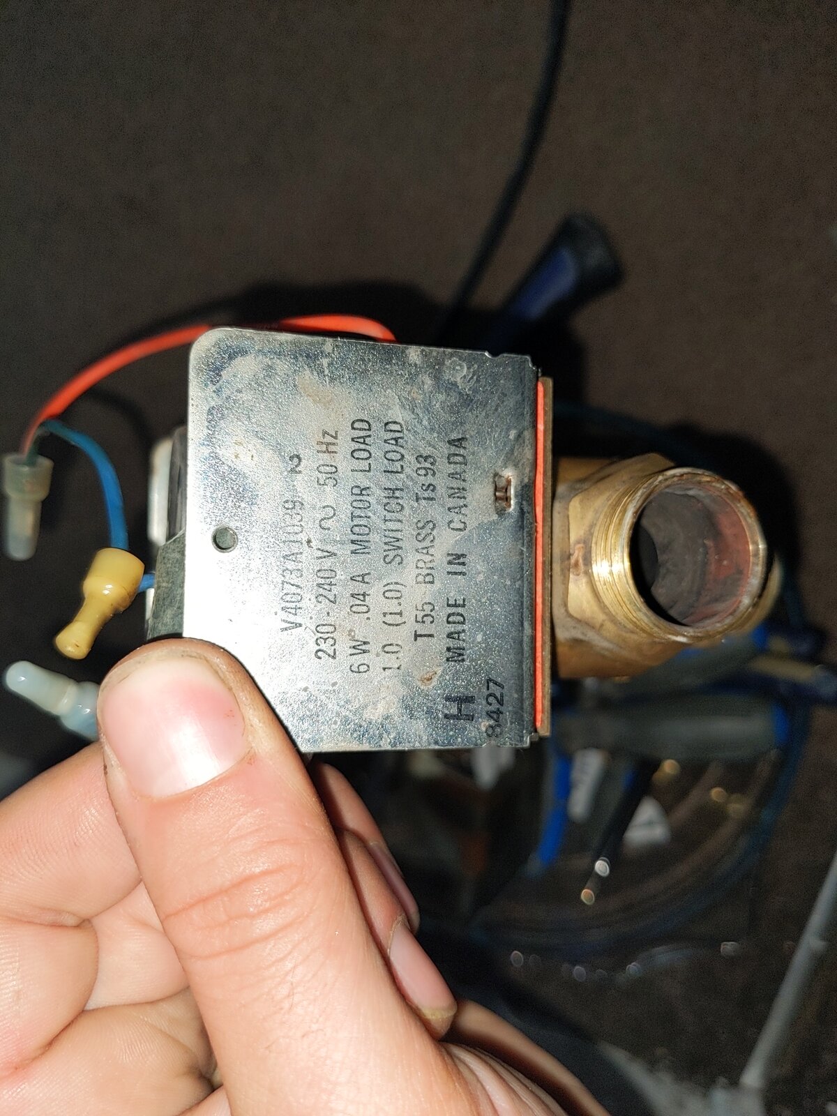

Also.. i felt the top of the 3 port valve and its warm.. as if its powerd on. So ive turned the switch that supply's the electric off. And i heard water movement.
I changed the wires like for like. One at a time.
What the hell.
Do i need a priest?

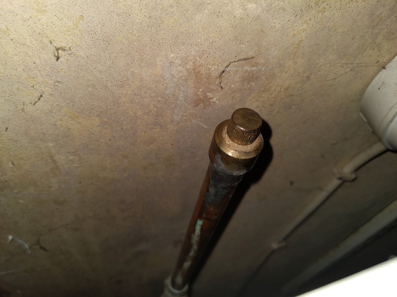

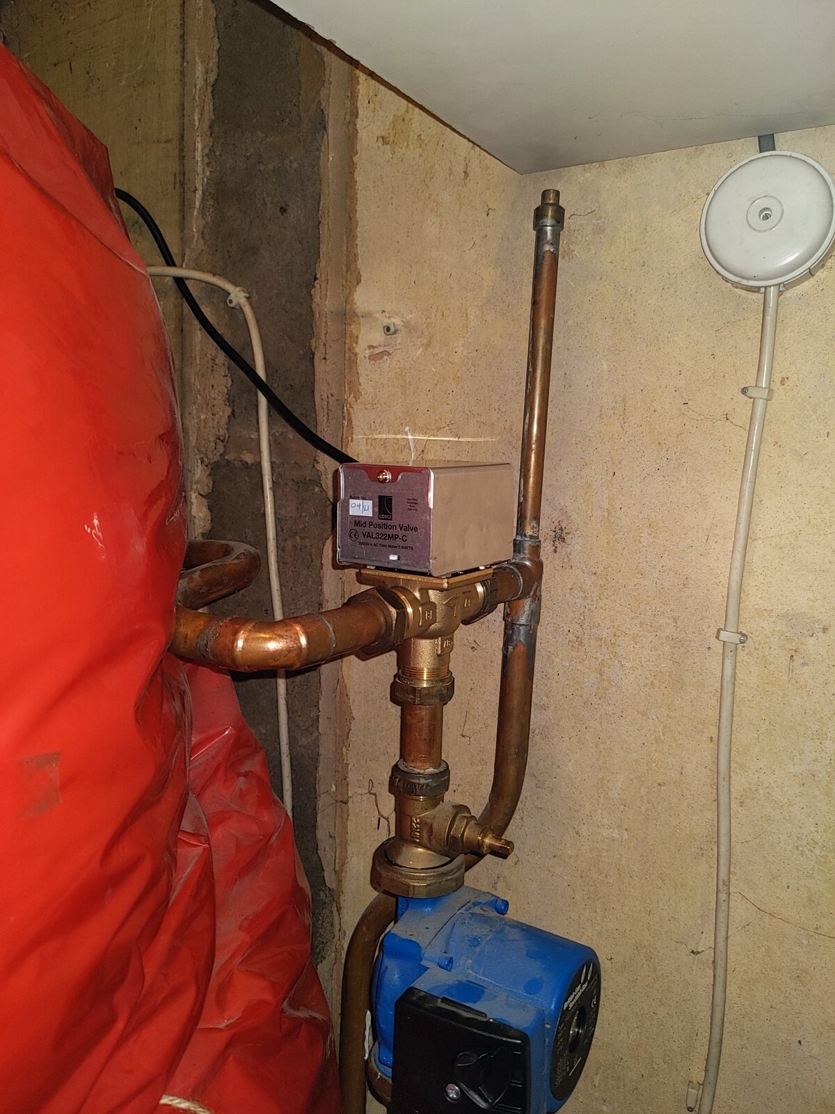

You mentioned what sounded like an air vent near your cylinder, open that to let air out (it may be blocked, you may have to poke some wire in the hole)
When you've done that, turn the boiler off, but leave everything else running, boiler won't overheat then.

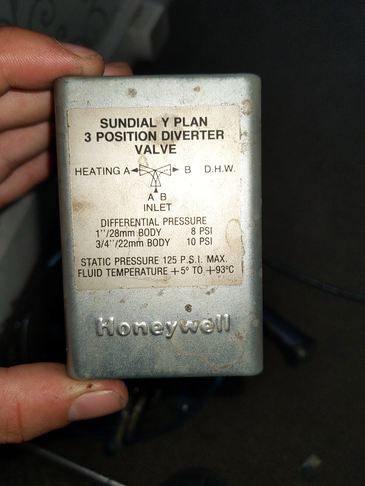

Ive attached some pictures...
