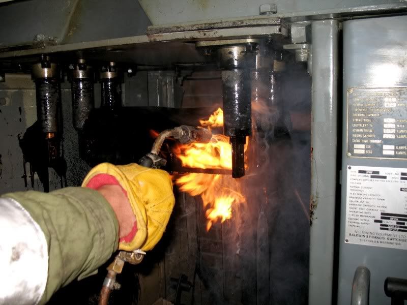

A leaking roof over an 11kv Circuit breaker casued the mech casing to start to desolve.

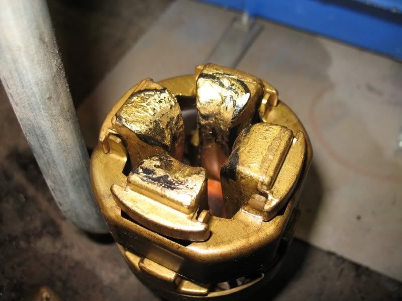

A female 11kv circuit breaker contact after opening/tripping on a fault.....Actually not that badly damaged and have seen worse put back into service :wink:

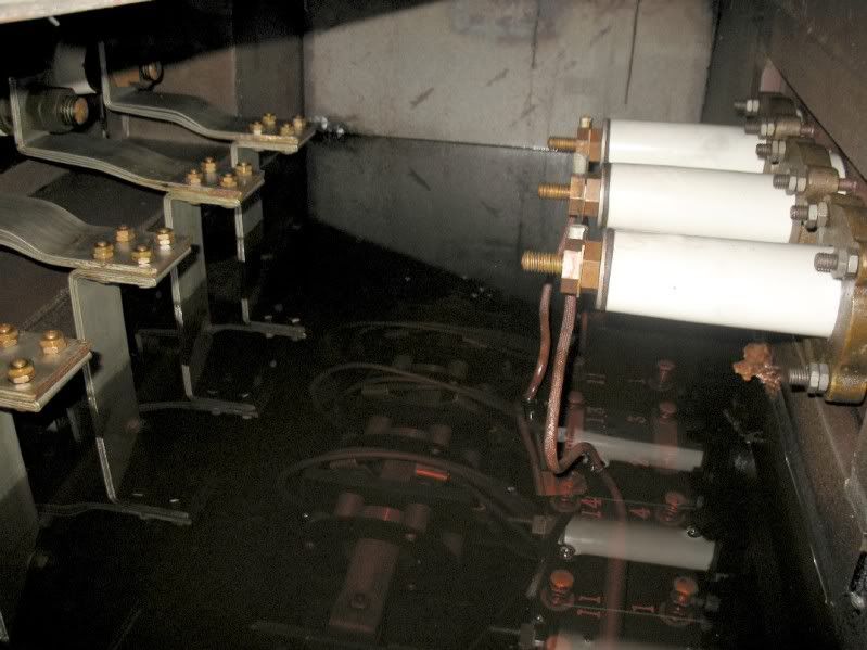

a 1937 11000/415V Transformer that has spent the many many years with a low oil level

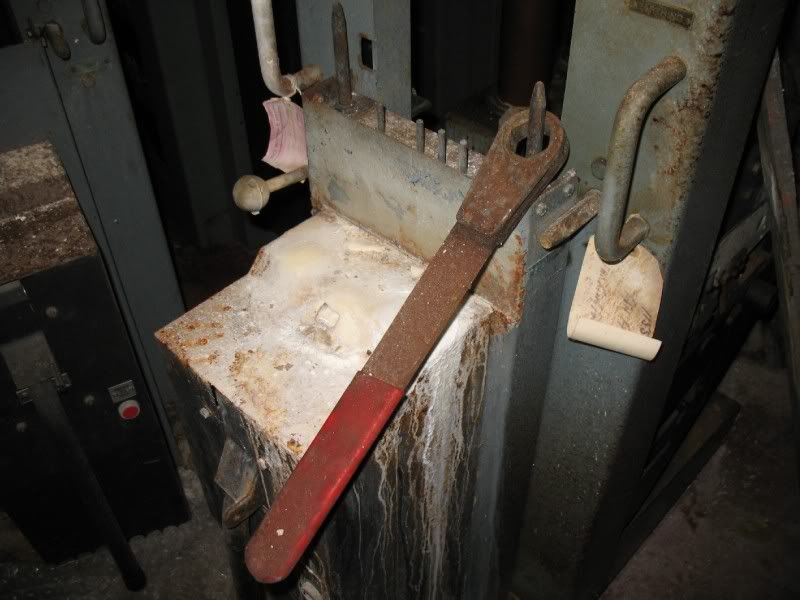

And whats more or less an 11000v Connector block having its TAR compund melted out
