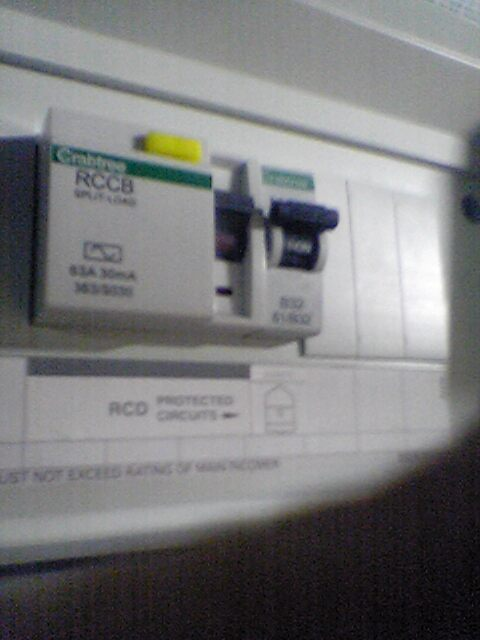

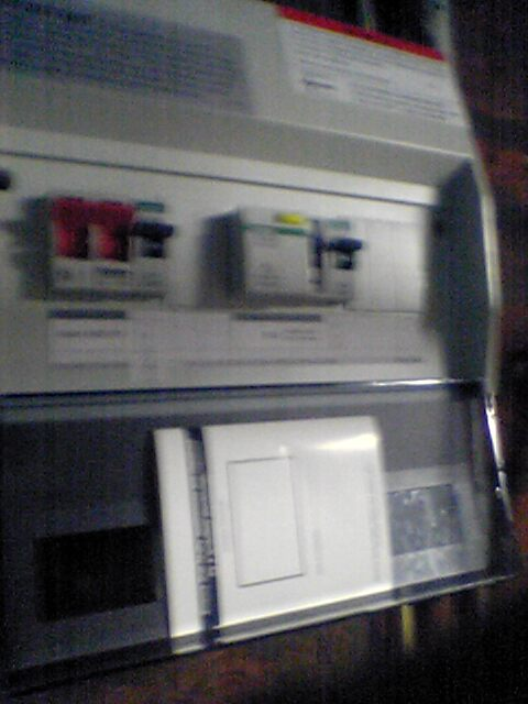

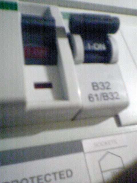

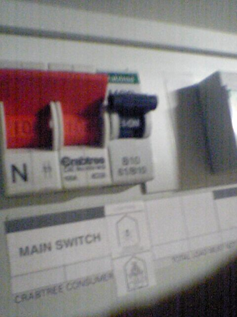

OK well the circuit is a new one quite recently installed an extension to the house blue\brown\bare earth wiring The breaker box from left to right as my pictures are not very clear (i have a vga camera phone...want to get a new phone)
two red switches
Lighting/smoke detector mcb I used this when I changed a light fitting in the extension to a four plate spotlight (lights in the old part of the house stayed on)
RCD I dunno what this is, but it has a switch and a T button
sockets mcb - I used this when I changed the white sockets downstairs in the extented part of the house to brass ones(rest of the house's sockets stayed on

You currently have a 10A MCB for the lighting which will allow you to have upto 2300W of lighting on this circuit, so there should be no problems with your proposals
Say the light you want is say 5 x 60W bulbs it is a straight replacement for the existing fitting - 10A breaker would be ok for upto 2300W (at 230v)

All the wires feed different circuits around the house. You will probably find that there are more wires than fuses as a ring circuit (for sockets) will have two cables per fuse.
mo2 said:
so if i dont have any probs with the breaker will there be any issues with fuses
You do not actually have any fuses in you new consumer unit. Breaker is an abreviation of Minature Circuit Breaker (MCB), which are fitted as standard these days instead of fuses.

Thank you for clearing that up for me, what are the red switches in the tripper for?
The two red switches are actually joined together and operate as one. This is a double pole isolator (your main switch) which will disconnect the power to everything connected to that particular consumer unit. It is the same as the main switch on your older fuse boxes (red switch on right hand side of top two fuse boxes). It is red so it can easily be identified in an emergency.
