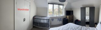

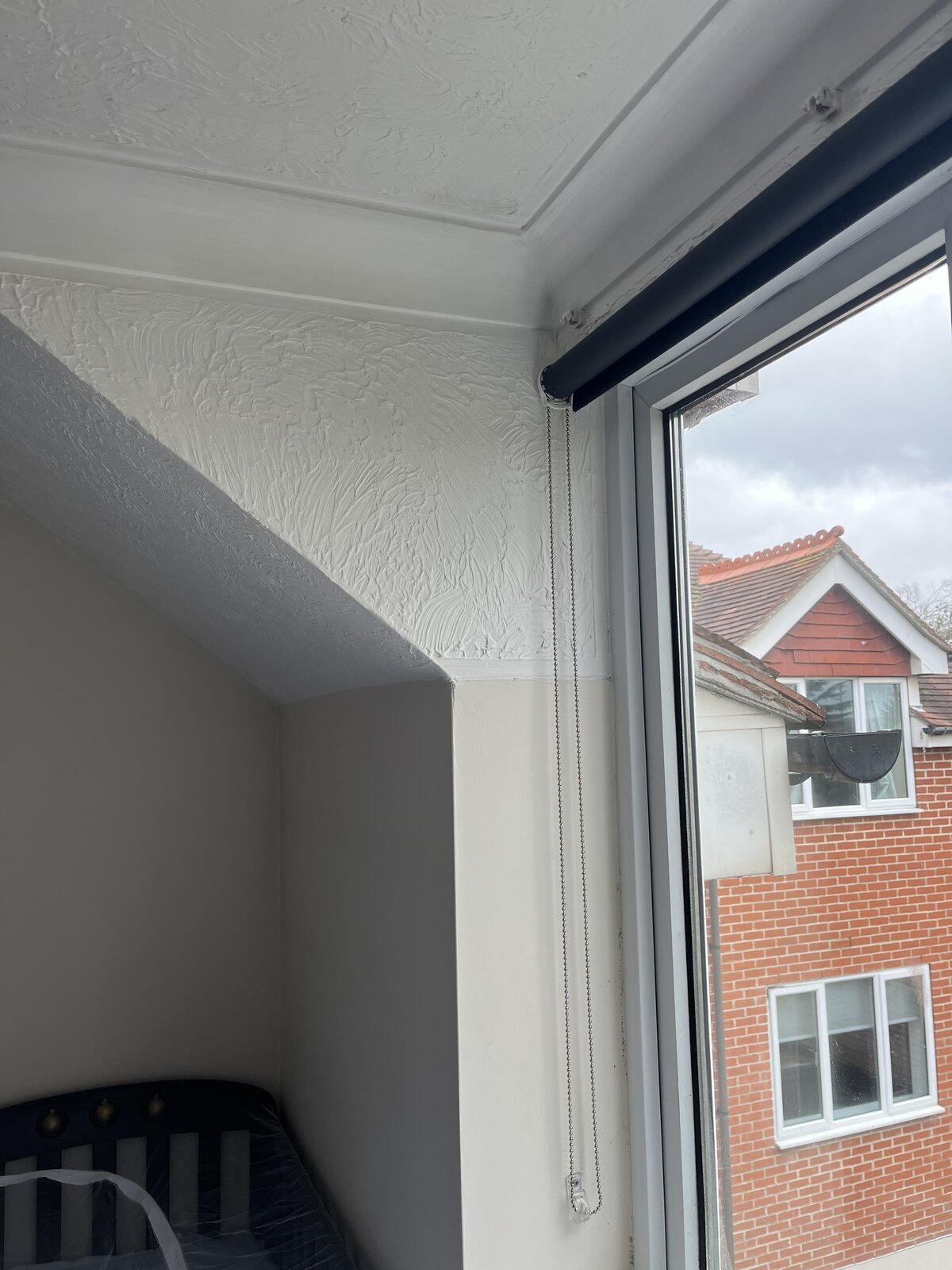

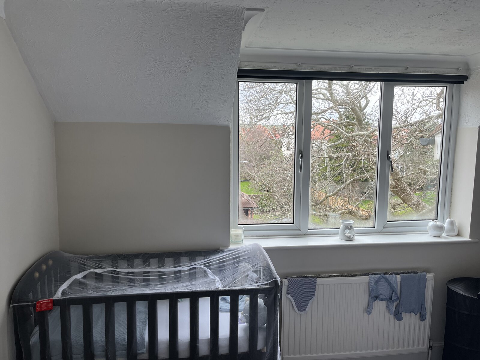

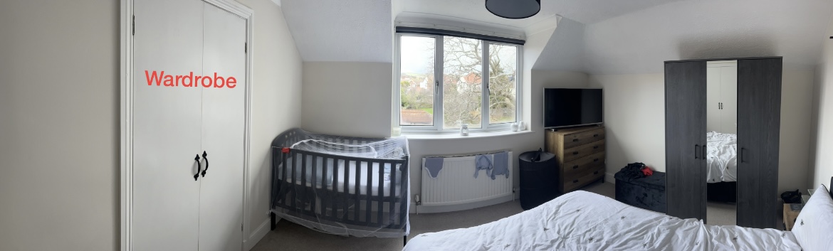

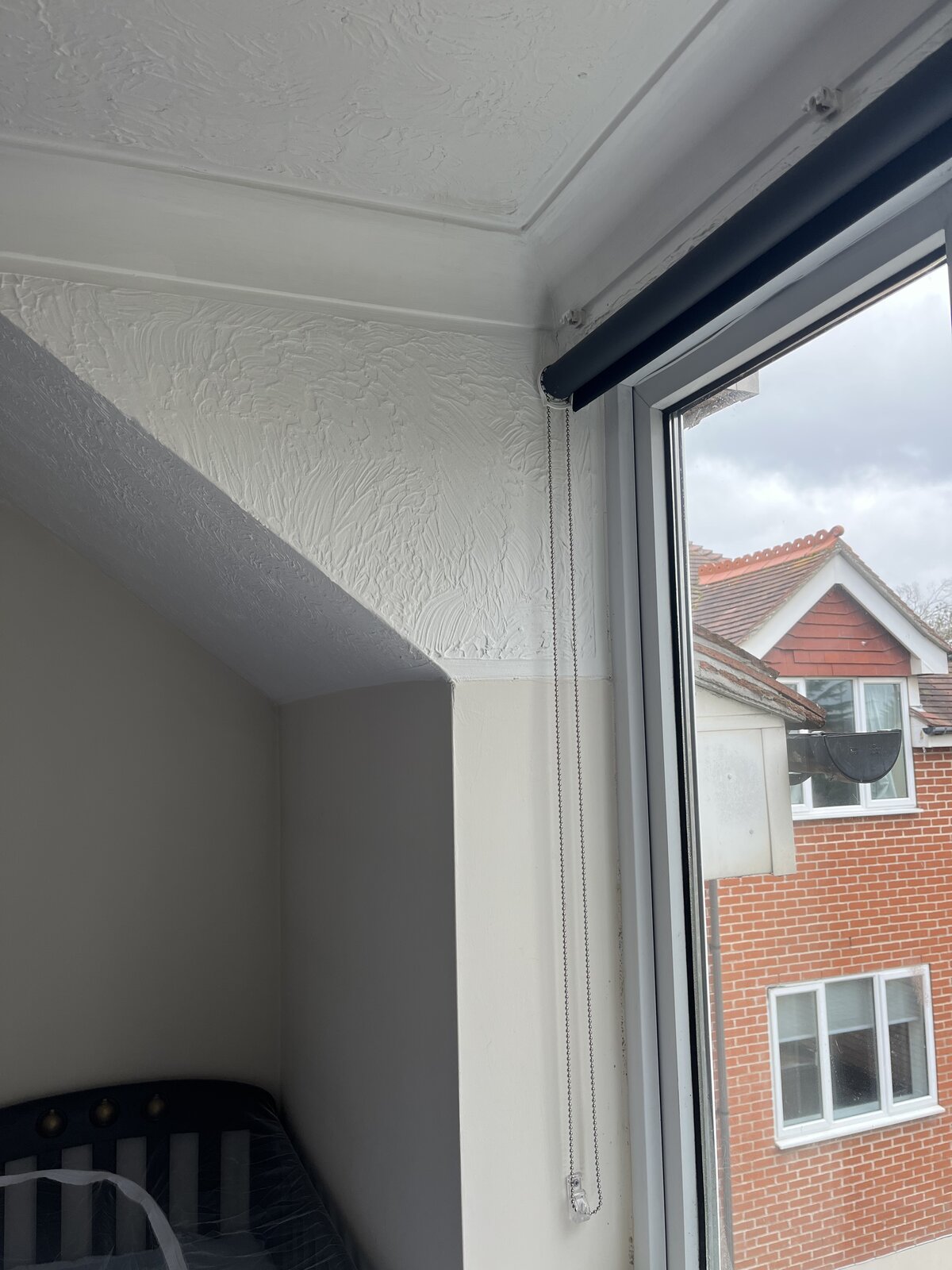

Hi all,
Our bedroom simply will not get hotter than 16 degrees! We’ve got a baby on the way and his cot is in our bedroom so we’re trying to work out how to make it warmer for him.
I’ve re-sealed the windows, which are double glazing. I’ve put the heat reflective foil behind the radiator. I’ve sealed any tiny gaps or holes I can spot.
It’s made things slightly better but the temp still won’t go above 16 when other rooms are much hotter (20+ish degrees)
One issue I think it could be is as we are on the top floor on the block of flats - we are basically right in the pitched roof; I’m wondering if there is little to no insulation in the roof space but from what I’ve previously been told by the managing agent there is no access to this part of the loft as it’s sealed off.
Does anyone have any ideas for what else we could try? Or can spot from the pictures anything glaringly draughty? Or even is there such a magic solution I’m not aware of like stick on insulation to go on the ceiling?
The only other option I can think of is cranking the heating temperature up and leaving it on all night, baby is warm but pockets will be empty haha!
Any help is much appreciated!

It's got to be due to the level of insulation in the roof space. When I bought our place, there was lots of insulation in the attic but it had been chucked about to lay the boarding onto the joists. As a result, there were areas where there was little-to-no insulation. Once it was properly fitted, it made a big difference to heat retention. Sealing gaps helps, but I think the area that needs to be checked is the roof space.

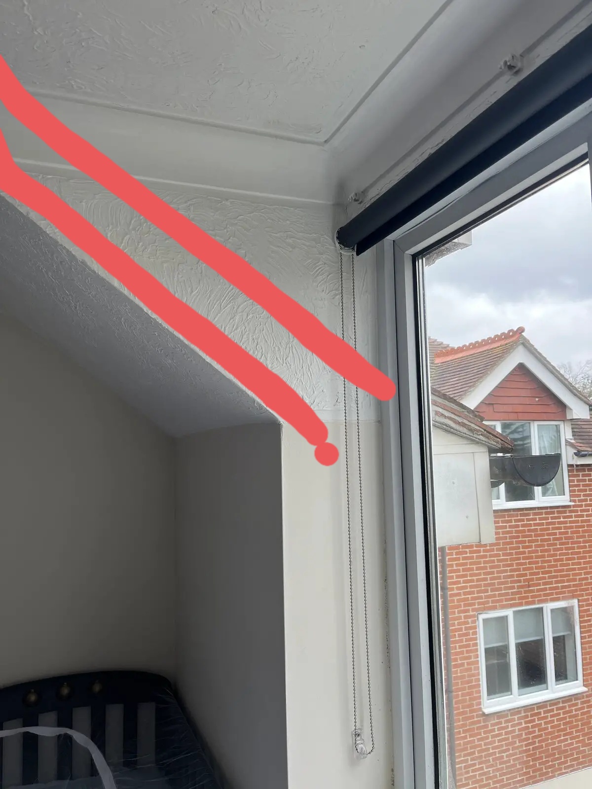

That looks like the late 1990's barrett's finish all that hand dobed wall adhesive on the ceilings doubling as plaster...I would suspect the dormer window being completely uninsulated and a single skin to the outside side walls again uninsulated. If you look across to your neighbour the dormer has a tiled finish which with a barret build will just be to some osb with nothing behind it bar some membrane, Basically that void is a fridge.
You could check the dormer ceiling by making a small hole in it and popping a finger through, not going to be hard to cover that up with the wavy davy ceiling finish.
If it was me I would be screaming at the agent if your renting...if its yours I would be getting a hole up there and insulate the bejesus out of it.

The window will be the coldest part of the room. Maybe relocate the cot?

Excluding any insulation issues in the loft space, it looks from your image (and that of the other houses in the estate), that you may not have much insulation in your sloped ceiling:
...and as your room is in a hipped edge, any heat loss will be exacerbated.
As above, some exploratory holes (cheap endoscopy cameras are available), or borrowing a thermal camera, may be required, to determine what you are up against.

Check online for radiator calculator yours looks way under size for that room.
