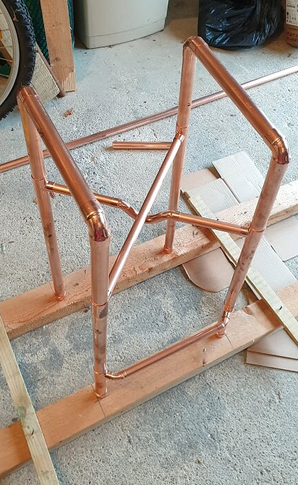

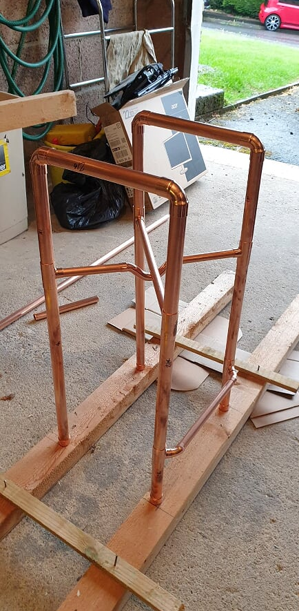

The images show the fram for a copper pipe bar stool I am making. All the other projects I have done have been simpler than this but I have a particular issue with this one which is what is the best way to keep all this square while soldeing?
Should I assemble the whole thing or try to do it in setions?
Any advice or ideas appreciated.
At present it's held upright by the bottom of the legs being inserted into stop end that I have screwed to the wood.

Stool is not very high about 60cm, 22mm pipe with 15mm cross braces.
First one is a prototype anyway. I will try to get the pics posted again.

To me, those back legs need a lower cross support L>R and F>B or they will easily be bent out of shape.
Soldered joints are not IMO going to be strong enough to provide a strong support.
It may look nice when finished, but not very practical.
Would compression fitting be a better choice?

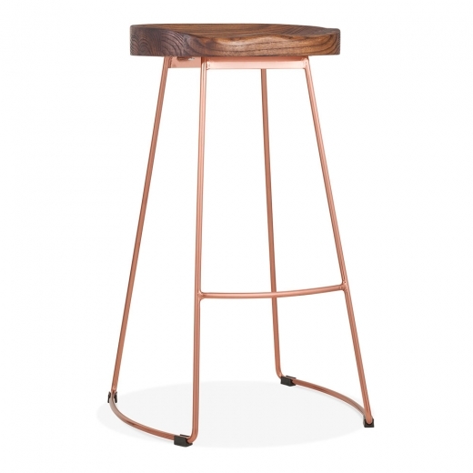

There are some quite flimsy looking ones available commercially....
cult-living-victoria-metal-bar-stool-solid-elm-wood-copper-75cm-p9635-116621_medium.jpg
You may find that's not copper rather steel that has a copper coating or does it say it's copper?
Not looking to put a damper on your creative skills but copper is stronger in compression, down along it's length but the minute you put any sideways pressure on it, it could buckle and collapse, especially with a person of more generous proportions and they then go to move. The foot rest would probably go pretty quickly too with body weight applied to it.

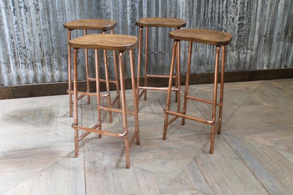

I was going for something like these which deffo are 22mm soldered copper at £155 a go..
The supports look better though
