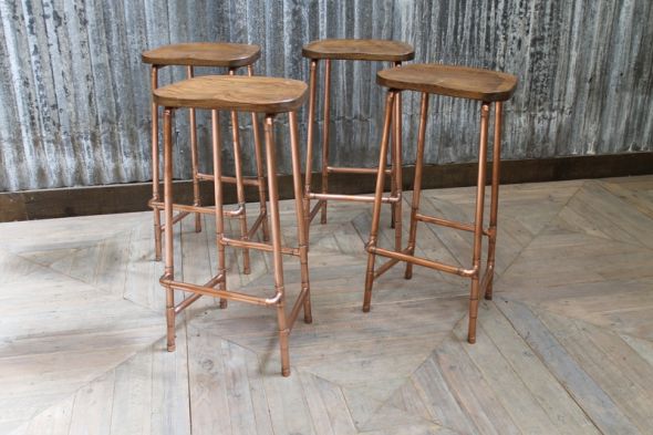

I'd be very surprised if copper pipe is sufficiently strong to make a bar stool
Threading steel rod into the copper would increase the load bearing capacity ( but could make soldering difficult if the steel absorbed too much heat )
Drilling through the copper pipe will weaken it though.
Yes but only drilling through the cross pieces at the top and the weight of the seat will be taken in 4 corners by the legs.
I thought saddle clips looged a bit too flimsy.
Munsen rings don't tighten right up on the threaded part (as far as I know) and school board clips don't often fully grip the pipe.
If the bolts don't work, I'll replace the cross pieces and use one of the above though
Use thread sealant on the threads of the munson rings to glue them in the position you want.
You could use this, instead of soldering the fittings...
My mate installed a boiler using it and said it worked fine! (y)

I was going for something like these which deffo are 22mm soldered copper at £155 a go..
The supports look better though
I think they look shyt....See enough copper at work without making stools out of the stuff..Each to their own..
haha, I'm not a plumber as you can tell so not an issue for me.
Copper pipe stuff is right popular just now
