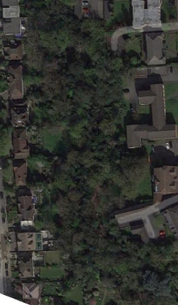

There are loads of trees in the area and so the gutters get loads of leaves in them. In the past leaves (mostly broken down bits) have got into the downpipes and blocked them in the bends at the top, leading to the gutters overflowing.

If there was an overhanging tree that might be an idea, but if there was an overhanging tree I would have said so.
There are loads of trees in the area and so the gutters get loads of leaves blown in to them, see
