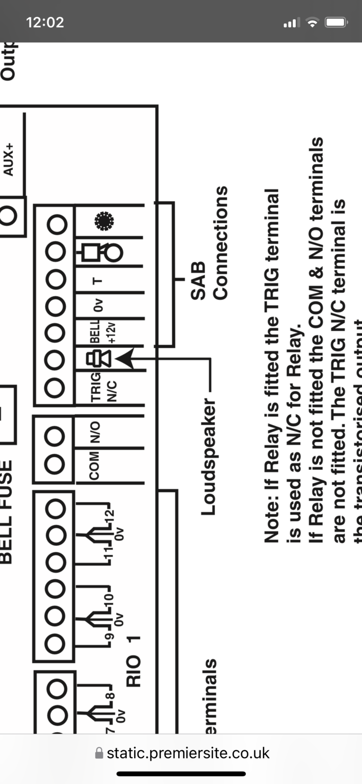

Hi, could anyone tell me how to wire a Kintec extension speaker to a Honeywell galaxy G2 panel? The speaker only has two wires (red and black) it should have been a straight swap of the existing speaker with a red and black cable going to the same outputs on the panel, however when the alarm goes off the speaker makes a tiny little noise as if the speaker is burst (it is not) so I’m looking for some guidance.
Lee.

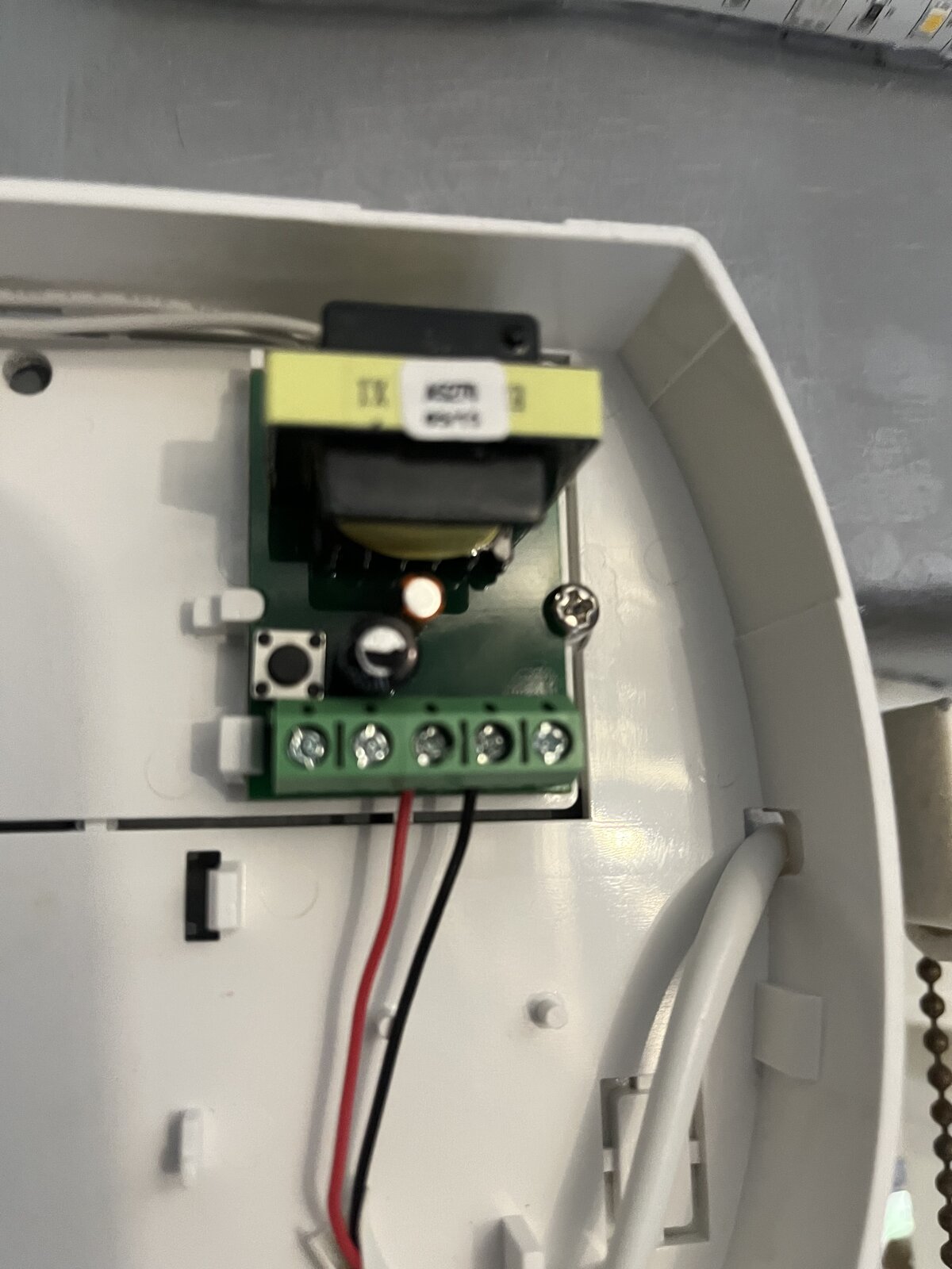

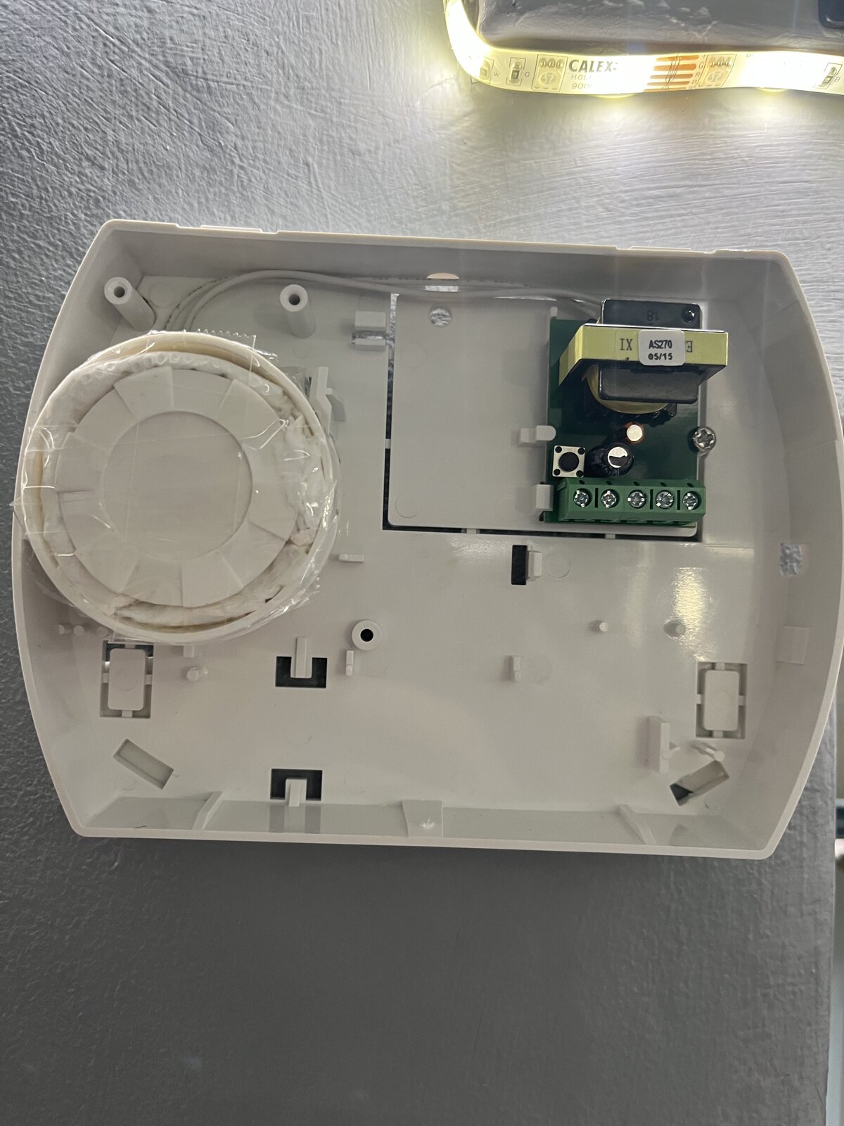

Hello Thanks for your reply. Please see below - the cable currently is connected to output 1003 on the panel and the red in the positive power section.

That’s a sounder …..not a speaker …what’s wrong with it ? Apart from its stuffed with tissue paper and tape….

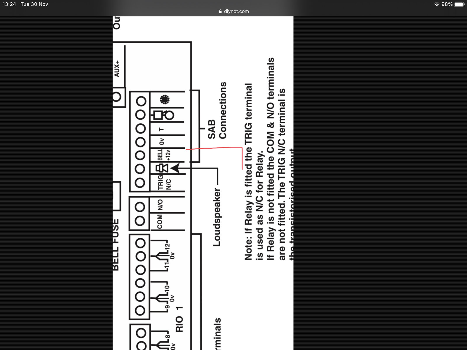

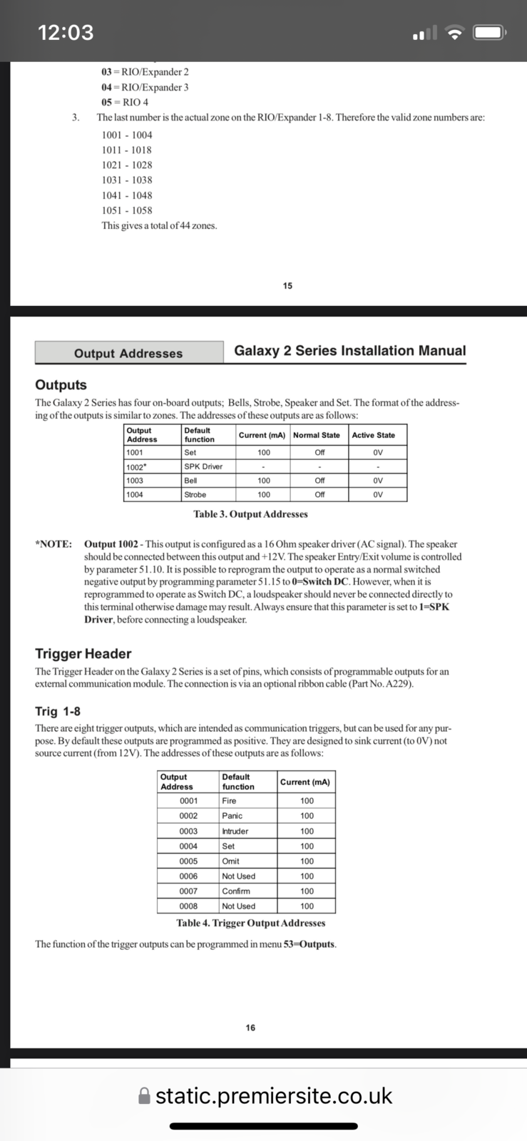

Ok if the wires are back in the panel , remove the black wire which should be in bell trig and put in speaker terminal
IF ITS PROGRAMMED FOR SPEAKER AND NOT BEEN CHANGED ! …..you may have allready damaged the speaker by wiring it in the first place !
