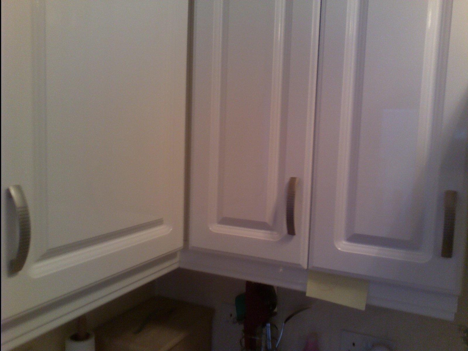

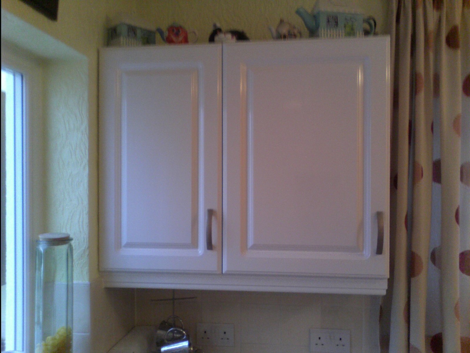

Hi Doggit, sorry about the delay but at 80 I don't get on well with the technical side of computers had to get one of my son's round to help. The first picture is where the problem is, the second one with the yellow label at the bottom of the door is the cupboard on the internal wall. Thanks

Would not be where you plug in the kettle, steamer, toaster etc? would it, you could be steaming the cupboard daily.
Hi foxhole, no we use a gas kettle, make toast under the gas oven grill, and cook in the oven well away from the problem cupboard.
