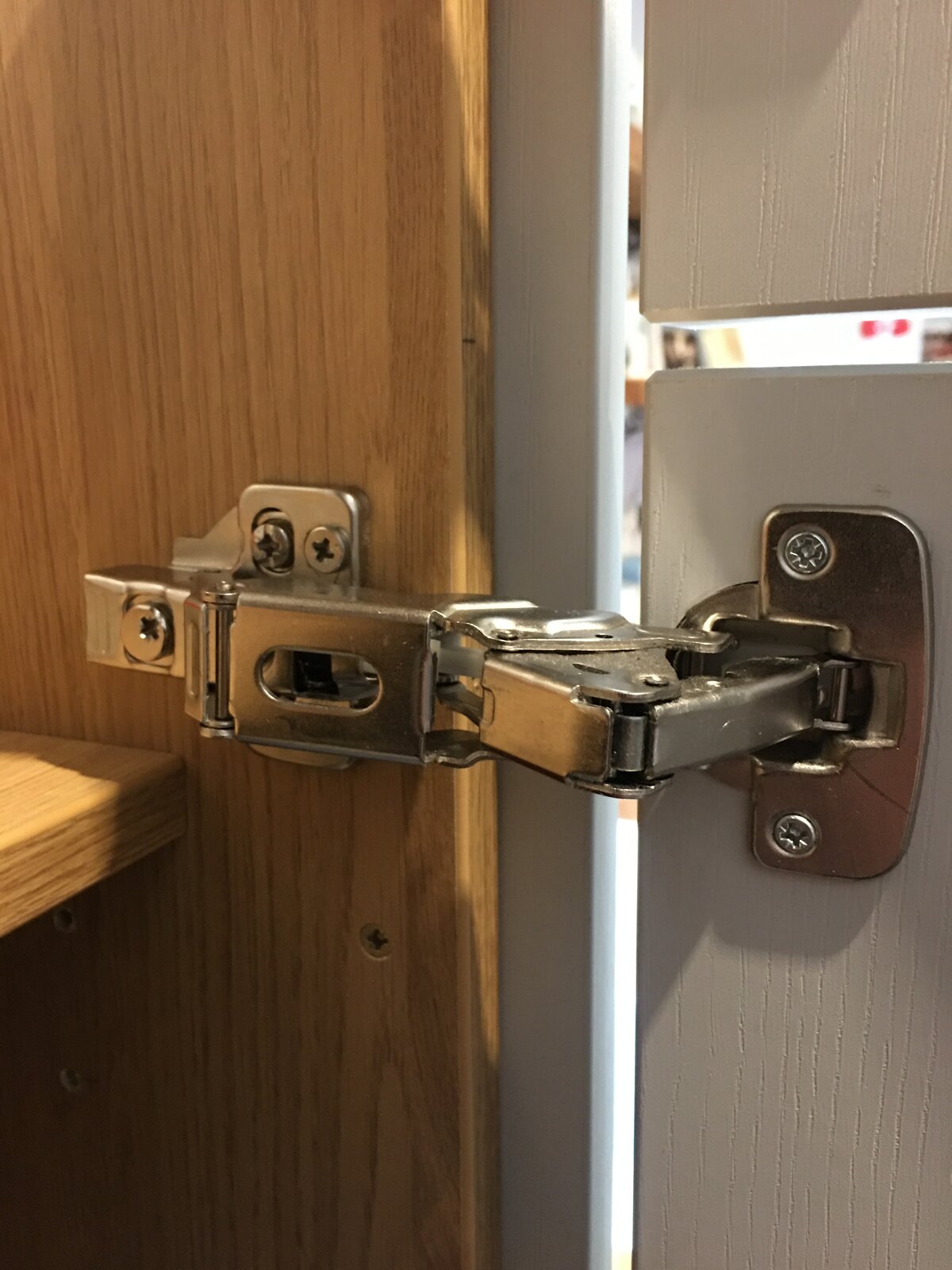

    0CA1B5C2-24BC-4E45-800A-214C87391FC3.jpeg Hi,
    the soft close mechanism has stopped working on one of our kitchen doors. Can anyone tell me how to fix or do the hinges need replacing? If so what type are they?! Thanks!

    You can replace the hinge. screwfix have a large selection or howdens. Make sure you get the correct angle of opening, that's possibly a 170 degree one. Take it with you when you get a replacement
