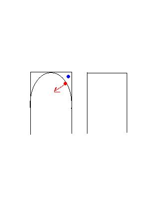

You could always duct the extraction from the outlet to the end of the passageway. A bit more expense, but at least it'll keep the neighbours happy. ;) ;)
The builder's not gonna re-route the duct through a floor and then out of the wall at higher level at his own cost is he? Didn't it occur to you that that was where the duct was gonna stick out?
Thanks John.
The neighbours agreed to that proposal but there is some internal rerouting to be done.
Look at the attached picture. The left hand side shows the passageway in profile (with arch) directly outside the kitchen extraction.
The hole is coming down via the red hole. They need to go another foot higher up inside the chimney then come out towards us where the blue spot is, i.e. down the passageway.
The rest of the passageway doesn't have an archway, i.e. like the right hand picture.
Now I just have to find a way of convincing the builders that's what they really should have done in the first place.
