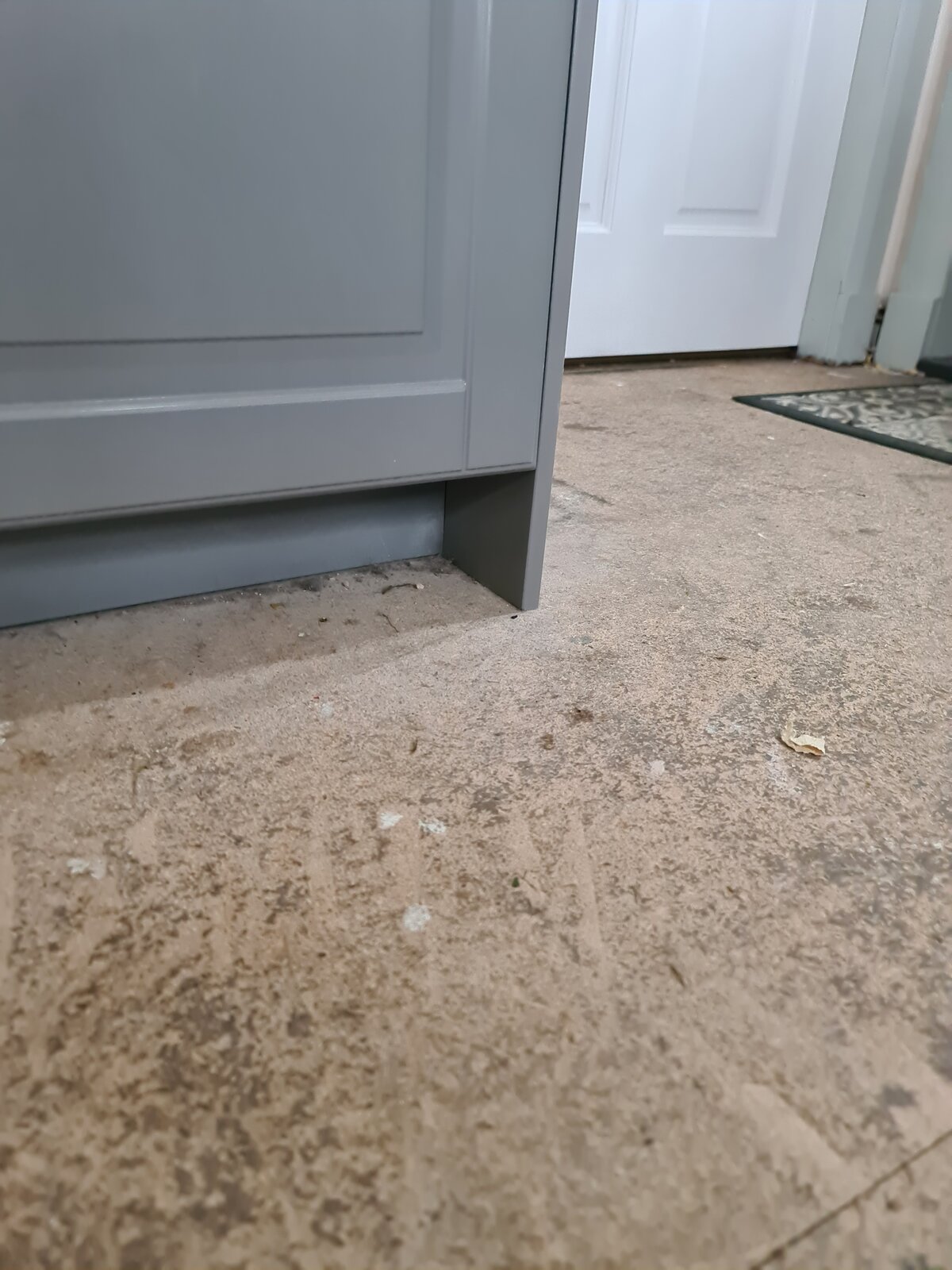

Looking for some advice please.
I have laid many laminate floors, but not in a kitchen with unit legs to negotiate with!
In the 1st picture, how would you advise to cut laminate around the unit leg? I don't qant to leave a 10mm expansion gap at the side and front of unit leg as it would look horrendous.
Any advice greatly appreciated. Thanks.
the end panel and plinth you cut to go onto the laminate flooring
The feet should be behind the plinth
At least thats how have done 4 kitchens, BUT just a DIYer
Remove end panels and plinths, cut laminate to finish inside these items then trim them to new floor height before you refit
Not just end panels to floor , kitchen would need dismantling to fit as you mentioned and with panels on top have no expansion room.
are they end panels or unit ends ??
yes i would expect them to be end panels but you never know ??
i do flooring to under plinth and 10mm clear to the sides cut end panels and plinths to cover expansion joints
