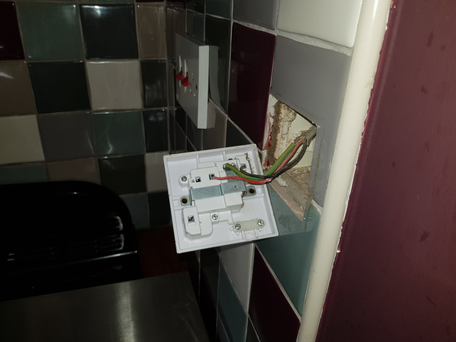

No its not normal. It could be something very simple (like a loose connection inside the isolator, if the lights are looped in after the isolator then that would be feasable), or it could be something very odd (isolator wrongly wired).
Isolate at CU, unscrew the isolator switchplate, confirm dead with your multimeter and show us the pics

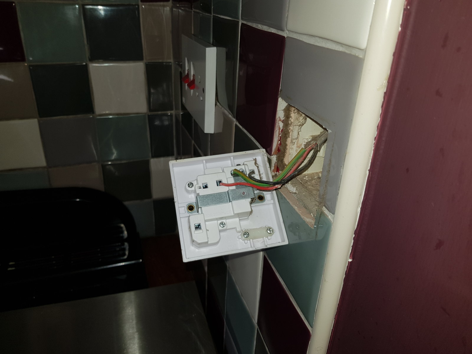

The isolator just has a single cable and seems it does its job. No reading with the meter when off. I will post picture next
John, LED lights flicker when they are on.

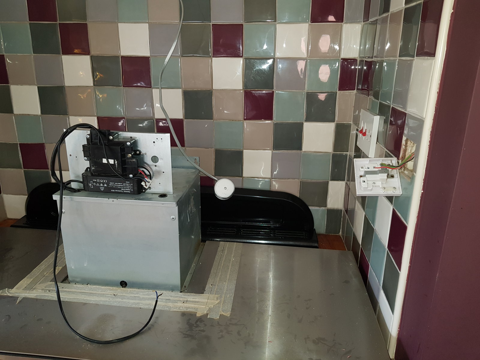

I removed the extractor fan last night
Nothing is connected to the supply. So now LED lights flicker when ON independent of the isolator.
Seems that when there is a load flicker stops....
Picture of extractor fan.

What voltage and size are the LEDs? Can you put an incandescent lamp into one of them?
Usually I'd be thinking a loose connection in a ceiling rose or switch, but the fan effect is odd.

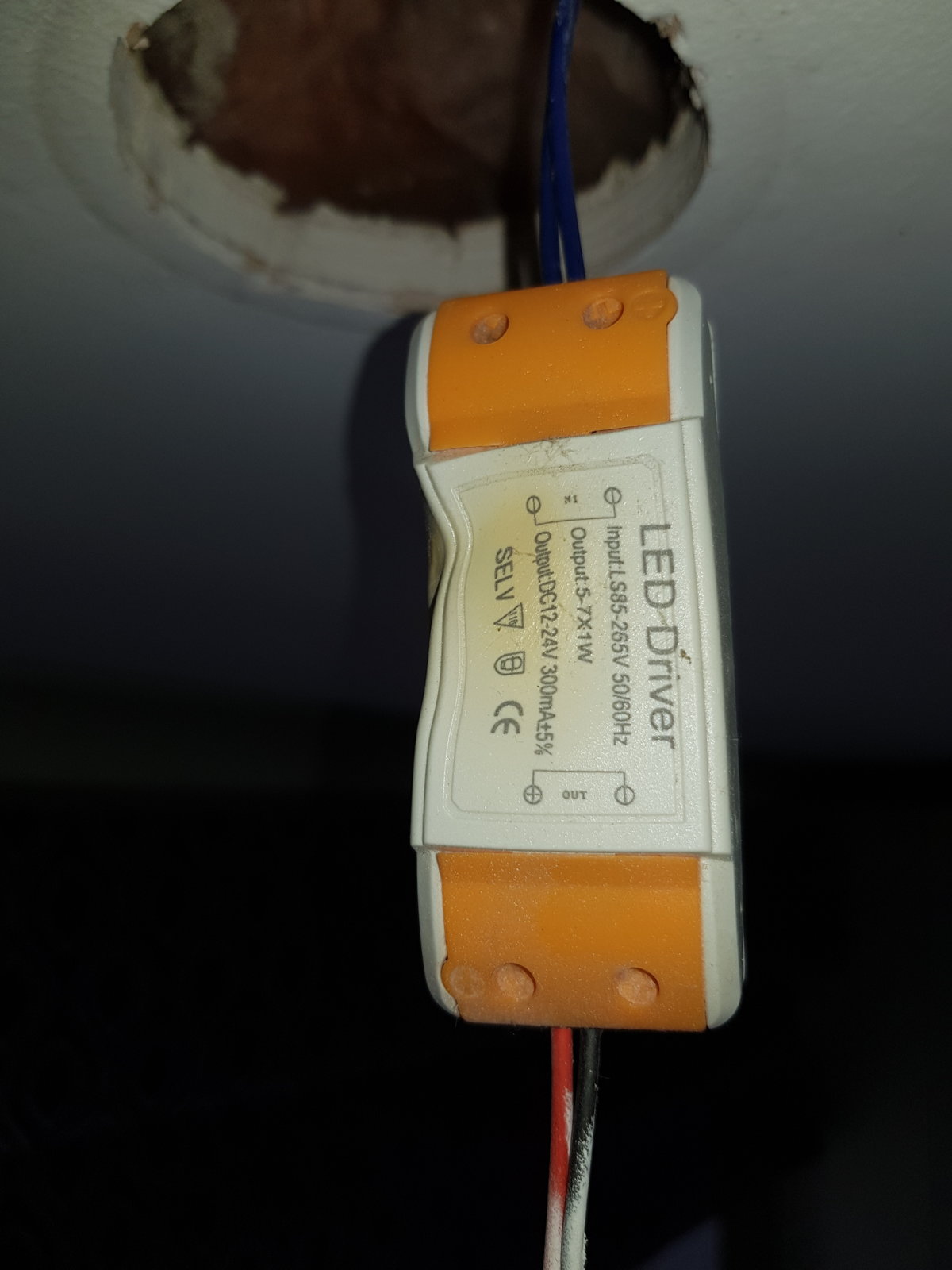

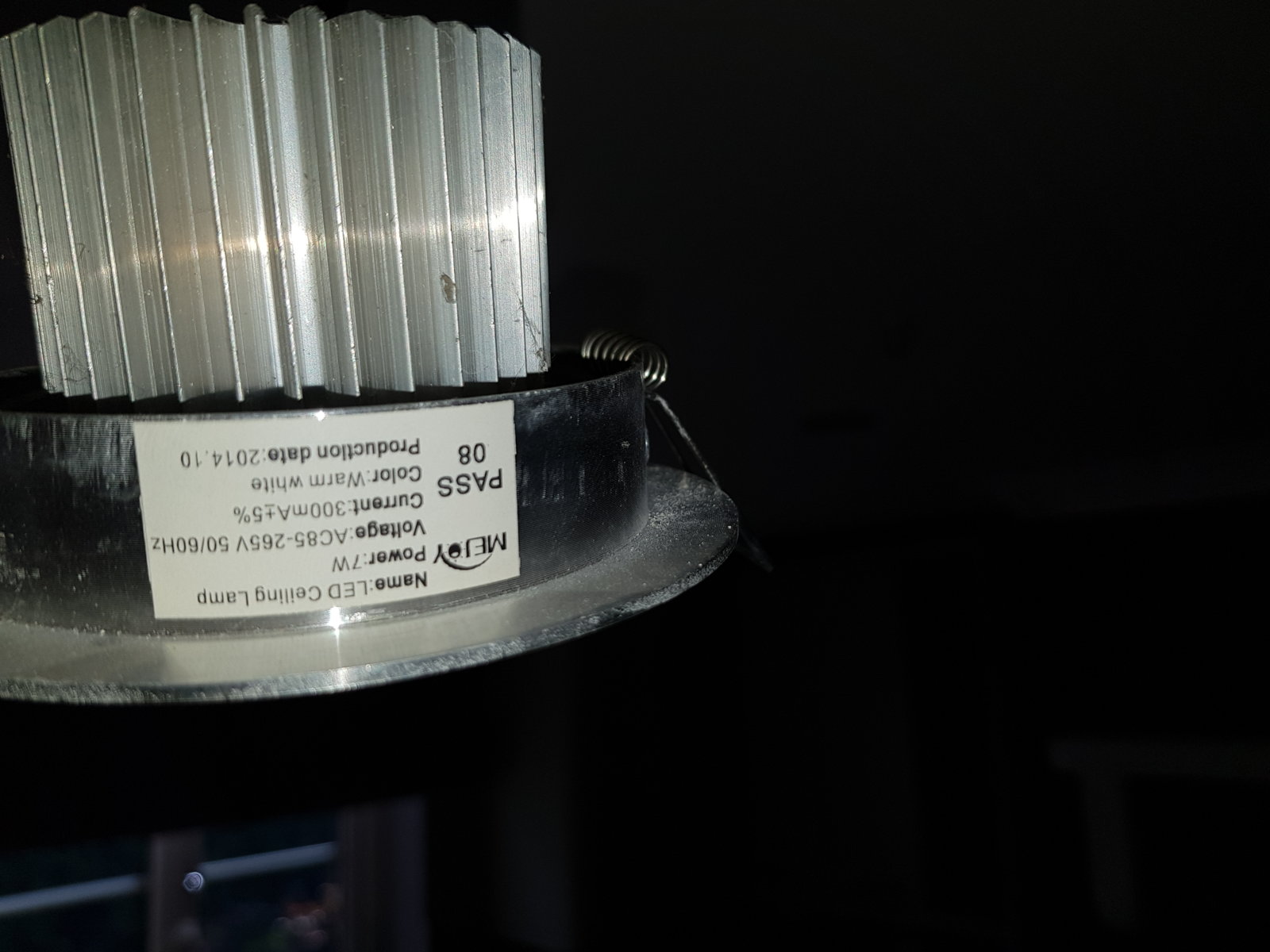

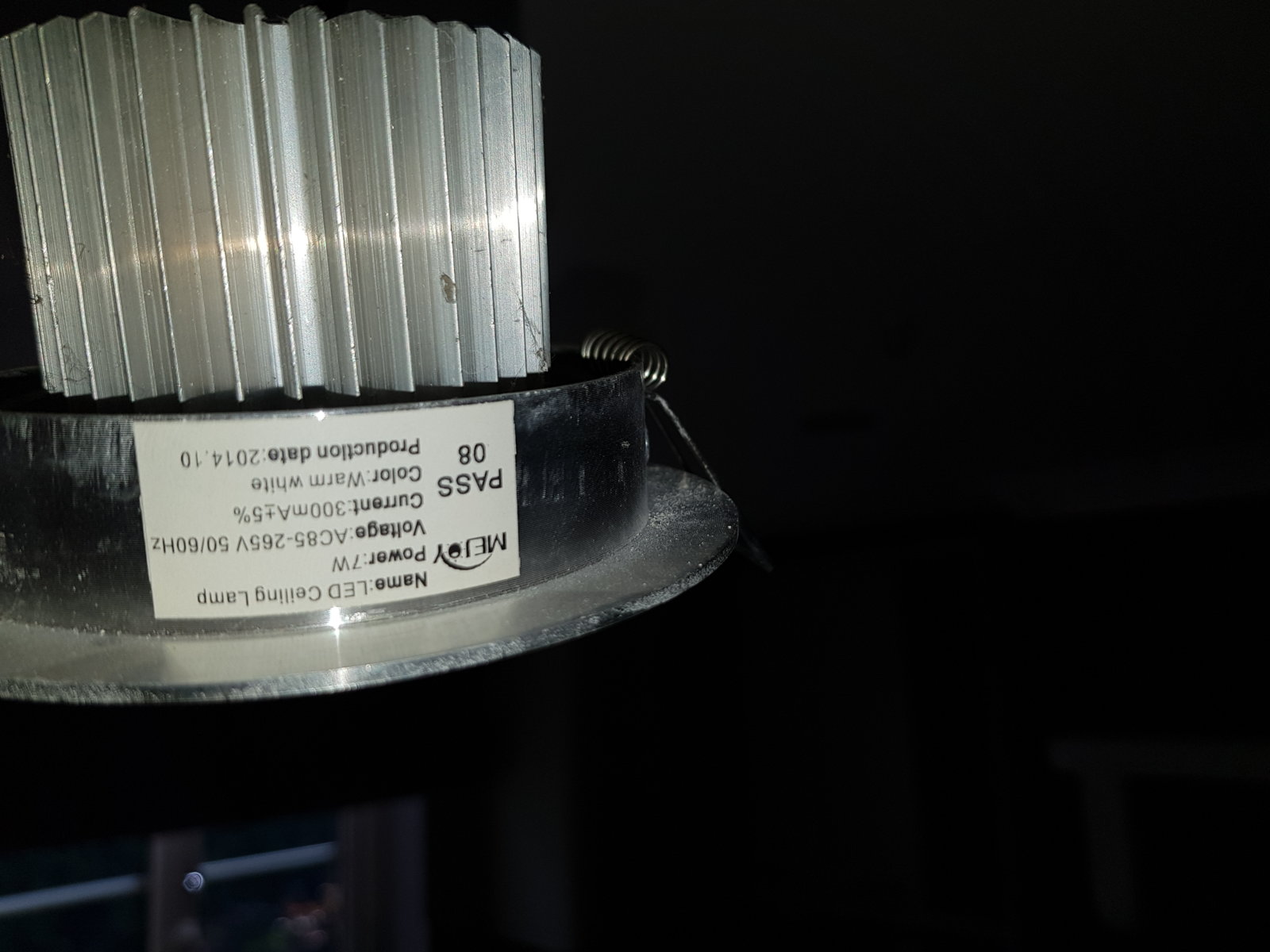

I attach picture of the lights... and drivers...
7w lights
Voltage AC 85 - 265V 50-60 Hz
300mA

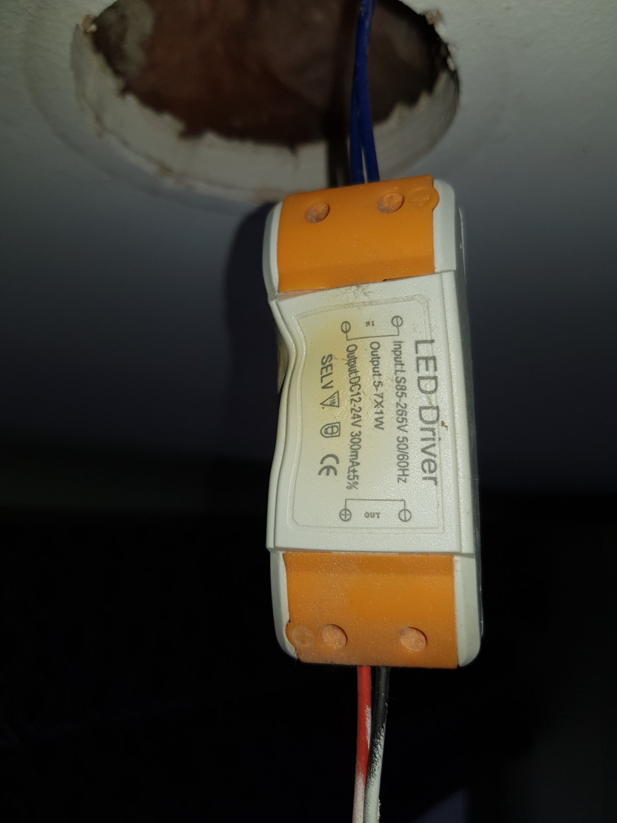

Attached to LED driver....i took a picture and it does not look good. Plastic has melted! The other 7 are ok.
Input. LS 85-265 V 50/60 Hz
5-7 x1 W
Output. DC 12-24 V 300ma
Pictures attached

7w lights
300mA
Why do manufacturers print such misleading rubbish,
300mA = 0.3 Amp
0.3 A x 85 V = 25.5 watt, ( bit more than 7 watt )
0.3 A x 240 V = 72.0 watts
The 300 mA refers to the current that the lamp drives through the LED elements and NOT the current taken from the mains supply.
It does not make sense, lamp is 85 to 265 volt so one would think connected direct to mains, and the 300 mA driver would normally power 4 to 8 LED,s (not lamps the LED chip) in series they don't seem to go together.
Eric
I wonder if the white driver module enclosed inside the lamp housing or attached to the outside as part of the lamp.
Thank you for pointing out the obvious.
Feel like an idiot not realising that led lights should have been connected to mains.
Previous owners set ot up and as soon as we moved in we had lamps flickering. Overheated transformers (no wonder why!) And one blew up!
