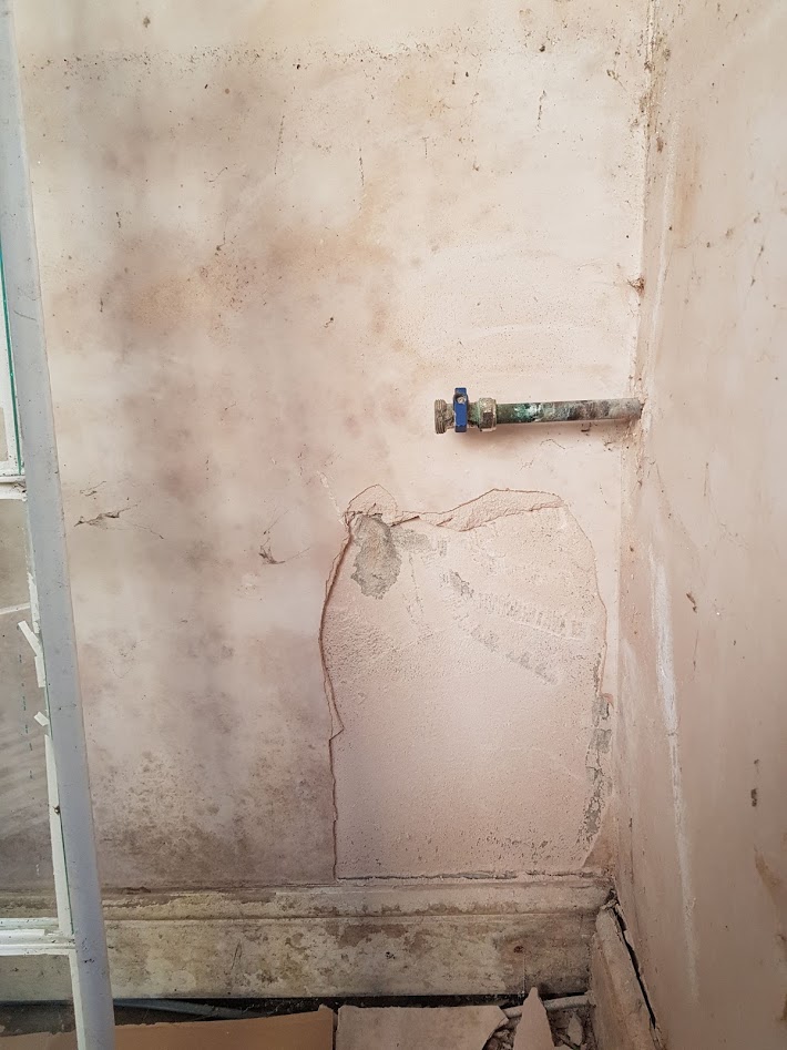

B. The kitchen has always suffered from damp problems. Cabinets and wall units, especially in the corners, have always had damp issues and a musty smell, even the cabinets on the south corner adjoining the neighbour garden, so the back wall of that corner should see some sun, at least in spring/summer.
We have lived in the house for 2.5 years, last year the parapet located one floor above the south kitchen wall has been redone due to renovation upstairs. We are aware approx. 10 years ago the kitchen had been injected at 1m high for rising damp (as if it helps).

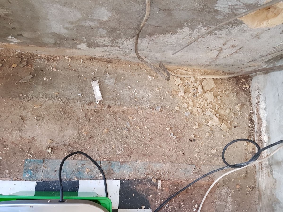

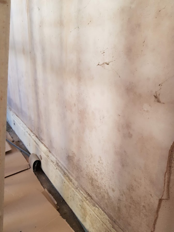

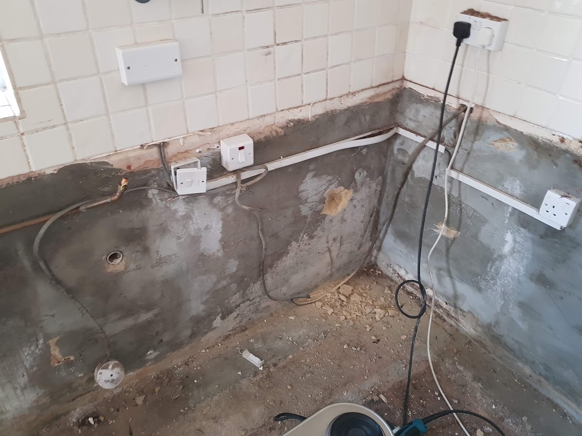

I can see now that the kitchen has been ripped out, there is light mould on the plaster in the bottom corners, screws fixing the skirtings are rusty, a backbox (1.5m height) in the south wall is rusty too.

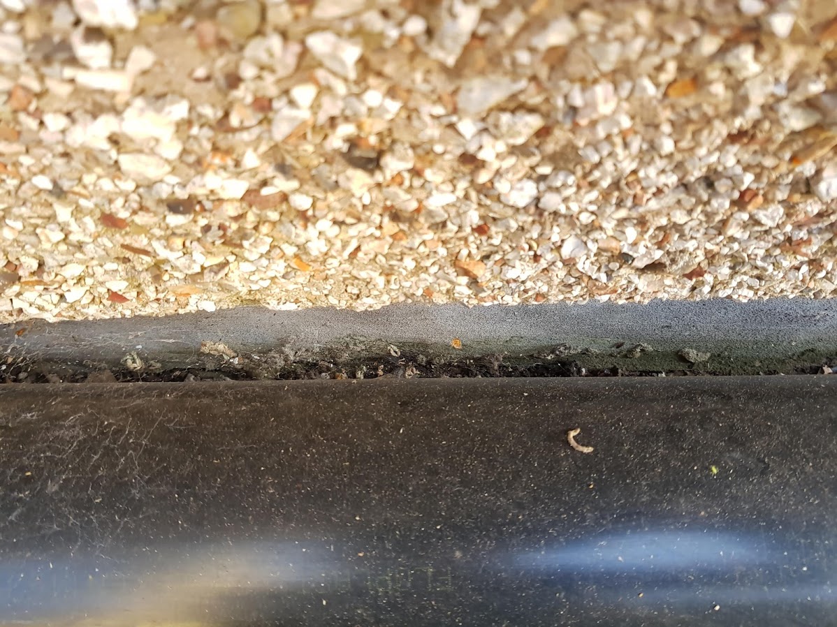

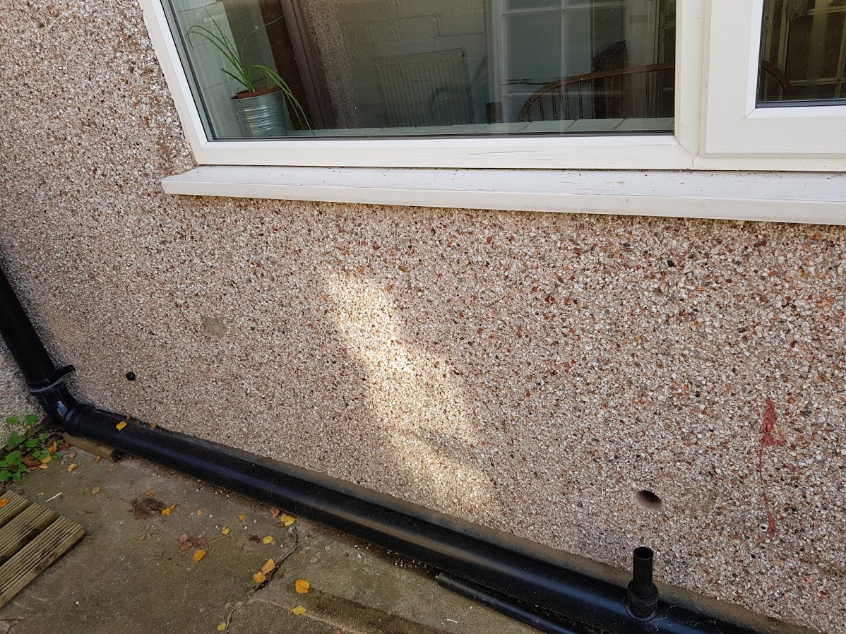

why dont you post photos of the kitchen's inside walls and floor, and outside walls at ground level?
sorry, hadn't seen you reply. Here are some pictures

any DPC in the wall(s) has been bridged over.
so far there's no sign of a DPM.
your interior plaster should not be in contact with the solid floor.
the external render, behind the soil pipe and below the dashed render, should not be in contact with the ground.
its probably best to hack off to 300mm above any damp or condensation signs - go back to brick.
and then render back up in 3:1 sand and lime render with, say a Limelite skim finish.
if you raise the floor by 180mm then the base units might be higher than the window sill, and you might meet further difficulties?

Externally, shouldn't there be then any render at all between ground and dashed render? Of course it doesn't make it right, but isn't it the norm, I think I seldom see (looking bottom up): ground, blocks, render? Usually render is covering the blocks, as they're dead ugly!
