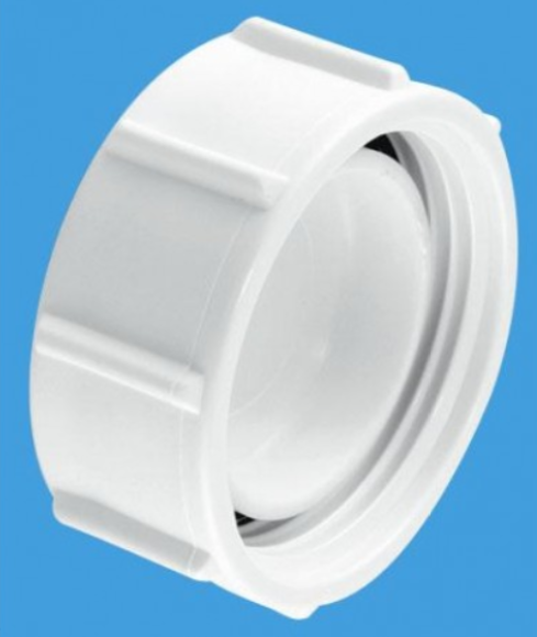

Thanks very much! Quick question, if you don't mind..
I do only have a sink with one plughole, yes. Instead of having the trap right under the waste bowl, do you think I could keep the grey horizontal pipe? So, keep the trap where it is. And then, because the grey corner bit which water flows out of is detachable, just replace that - with a closed corner bend piece. Do they have parts like that? Cheers
One of these will screw on, it's the same thread as the trap on the other end of the grey tee.
https://www.ebay.co.uk/itm/McALPINE-1-p-BLANKING-CAP-WITH-NUT-T23-/293588382866
If the grey horizontal really runs uphill you will be changing it soon anyway.
Do it once, do it right.
Get rid of grey pipe and grey strainer and use mcalpine fittings.
Then you won't have to worry about it until you change your kitchen.
