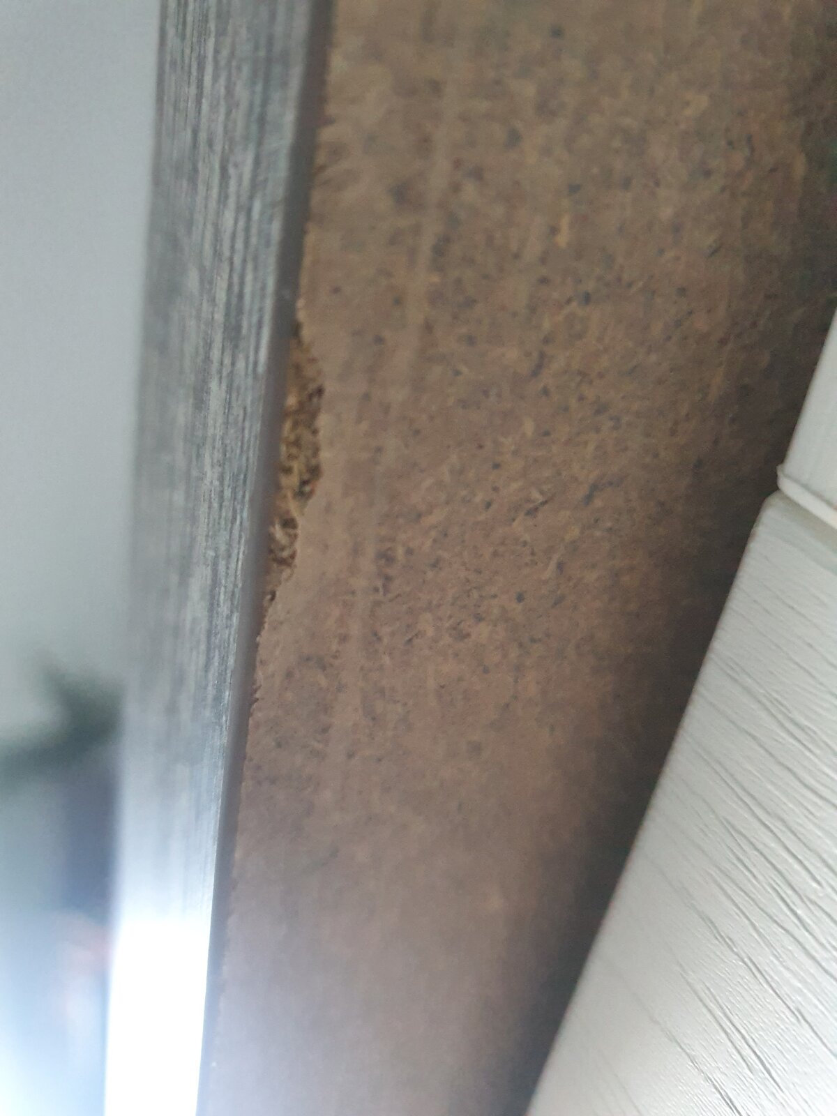

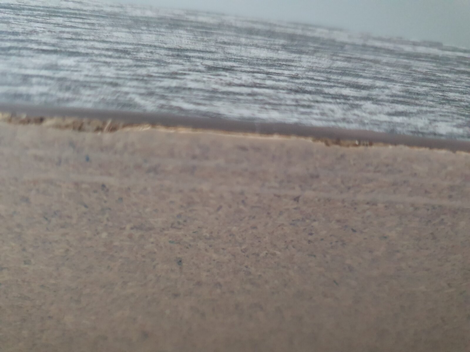

I had a brand new kitchen installed from Wren 9 months ago, on the laminate countertop underneath the edge of the overhang, it seems the wood is breaking up, must be something to do with water. the area never gets overly wet as i just use a damp cloth to wipe down.
What is causing this and how do i fix it. Would wood filler help?
The cracks are not visible unless you look underneath the edge of the laminate overhand edge.

Looks to me like some of the worktop broke while being cut and was edged in spite of that?
Maybe some epoxy brushed in to the voids then some PVA over any exposed bottom edge would help?
Normally a cut edge is sealed with PVA or varnish to prevent breakaway or water ingress
If the surface is exposed to steam, for example over a dishwasher, a kettle, or gets sponged clean, you need a moisture-proof coating.
PVA is water soluble so would not do.

I'm confused though I don't need glue I need to fill the cracks where the woods come away right?
The glue is used as a sealant for unsealed surfaces.
I'd probably fill the gaps with 2-pack car body filler
I would contact WREN and complain the kitchen is only 9 months old.
They could say it was done after its been fitted, but worth a try.
if you need to fill it, colourfill is better and if you can get a worktop reference you can get a colour match to it.

Having reviewed this with our Quality Control team, we do believe this to be a factory issue from where the worktops have been cut, like you have described.
Our initiative would be to replace the worktops for you due to this issue, however I do appreciate that this may be considerable upheaval and the damage is out of sight. I would alternatively like to offer a 30% partial refund on the worktop .
