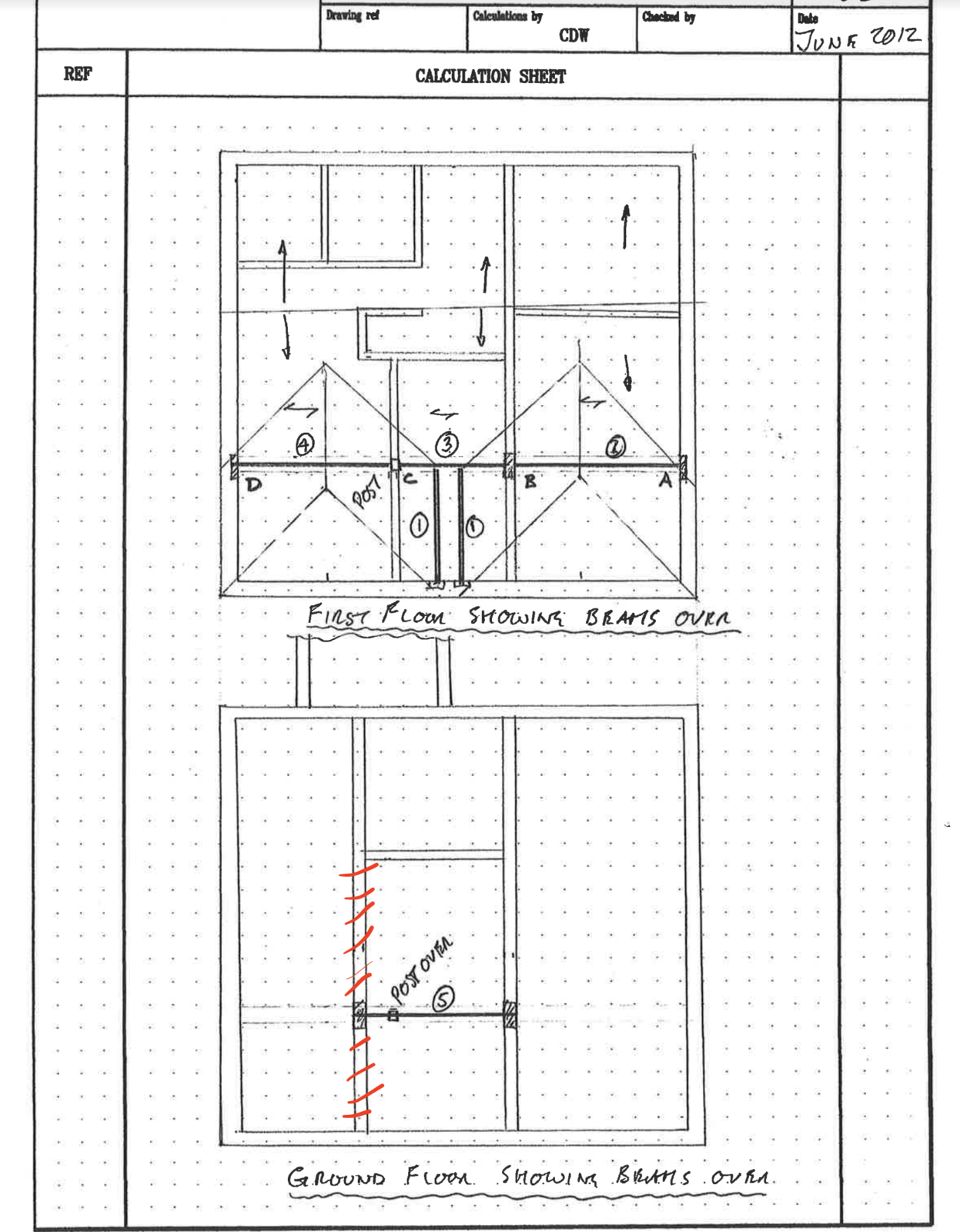

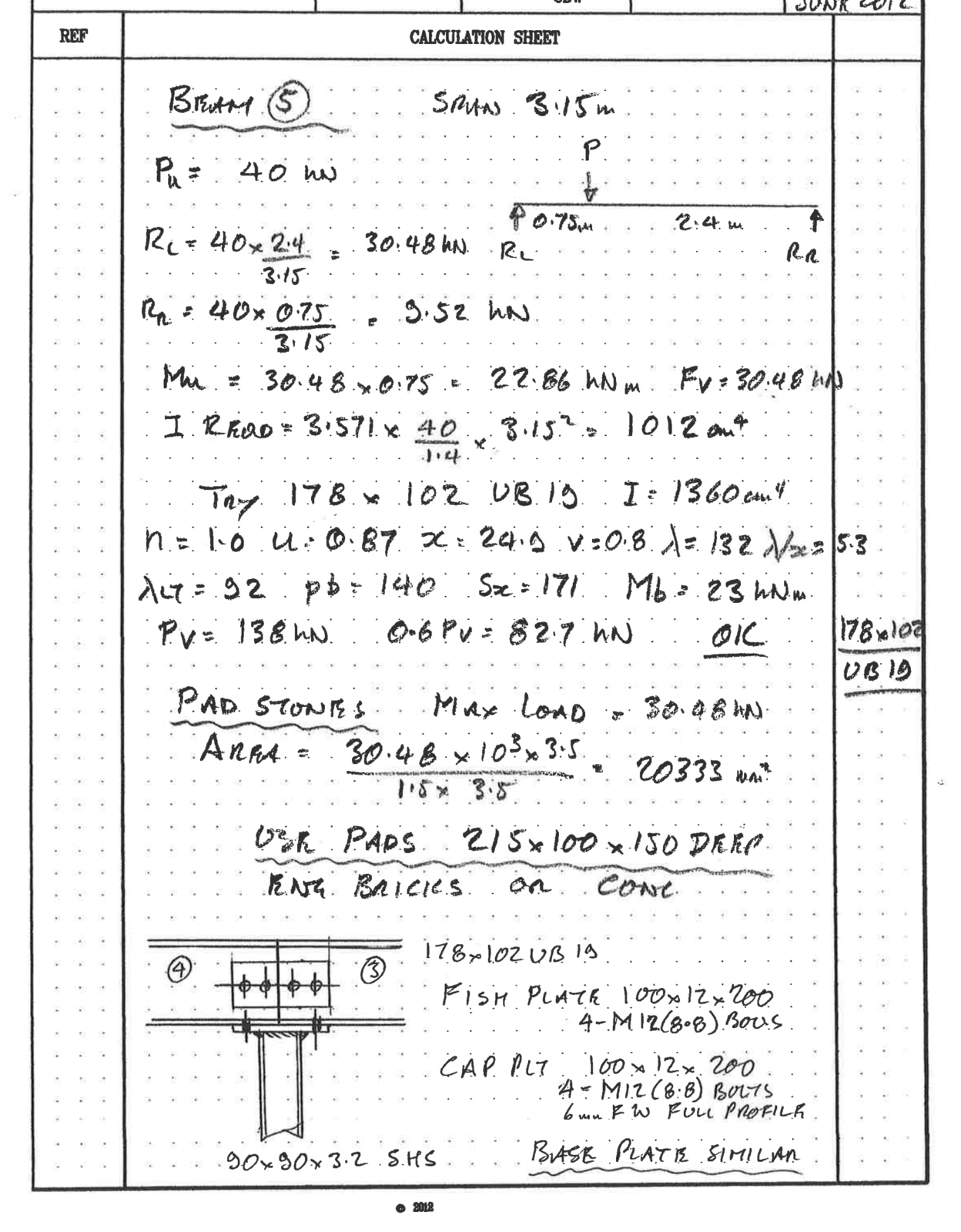

Hi, we are in the process of purchasing a house and want to know if the kitchen can be opened up by knocking through to the dinning room.
The house has been extended (2storey) and looking at the extension drawings there is a beam resting on the wall we want to remove.
Images attached.
Do you think the wall marked in red can be removed?
I am guessing the beam (5) will need to be replaced with a longer one to span all the way to the next wall?
Many thanks.
