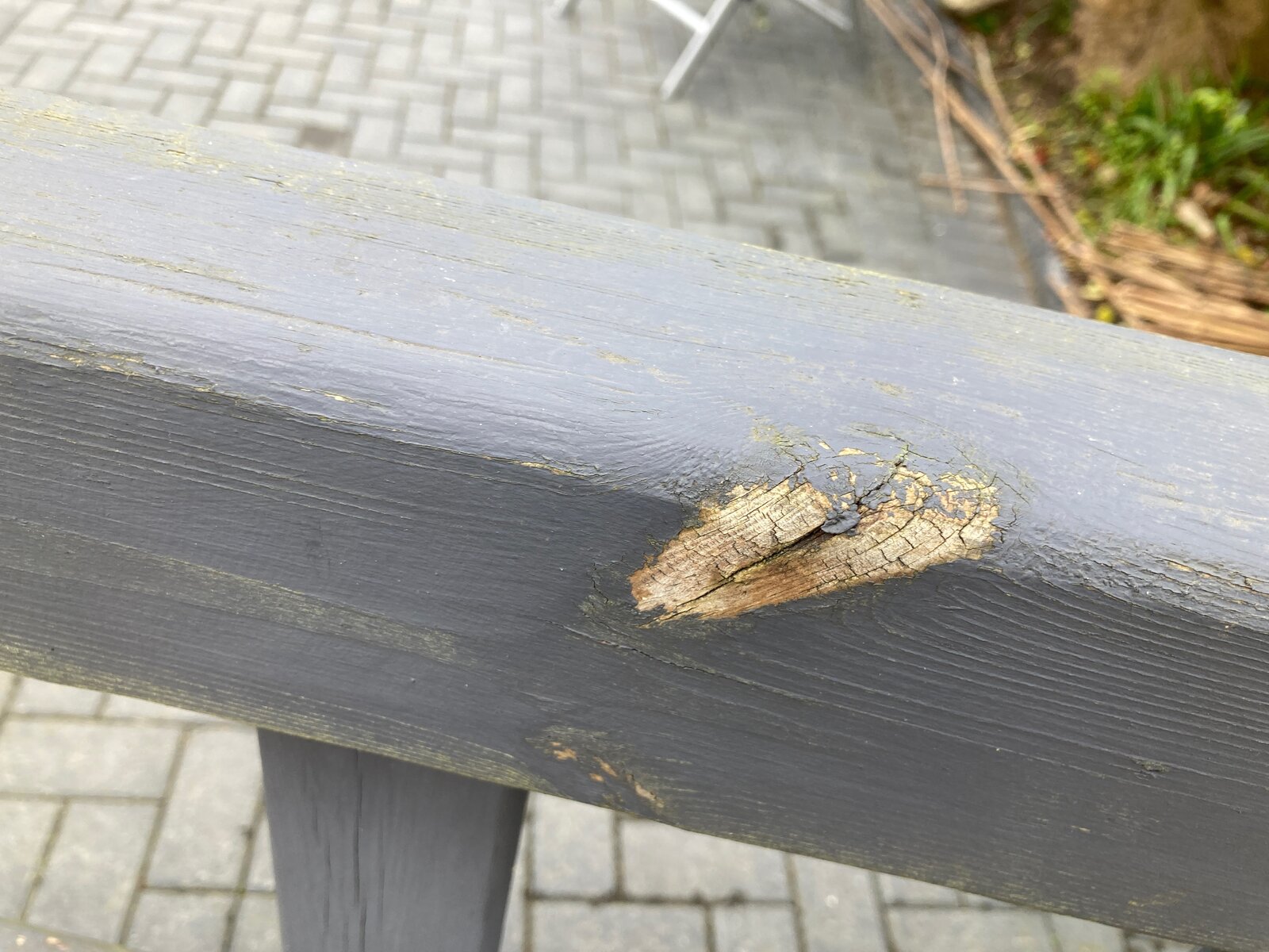

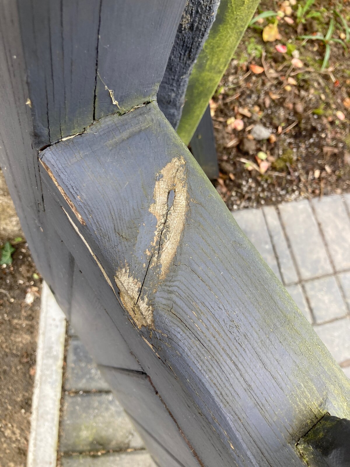

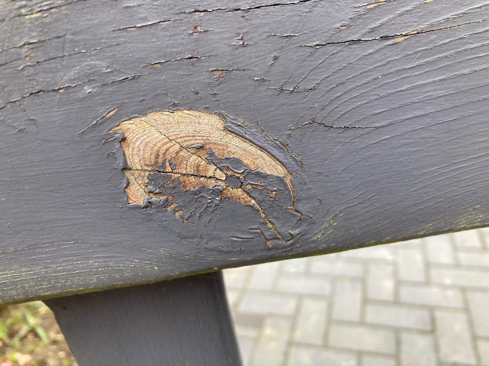

Painted these gates a while back and have noticed these knots. The paint won't stick. Used a good German Primer.

When you say a while back, you mean years?
Looks to me like the knots have dried out. How long after painting did the paint peel?
2 years ago, it's been a disaster. The Knots started appearing not long after. I gave it a good rub down then Primer. I used a water-based Primer...wondering should it have been oil. They are old gates.
Some 2 pack resin wood filler.
Aluminium primer but stir well off the bottom of can.
Top coats of whatever paint.
It's outside so will always be painting every few years
Ok, so rubbed down & 2 coats of Alu. primer. Was planning to use Cuprinol Ducksback. I have used it elsewhere in the Garden, and it's excellent far better than Ronseal.

Surely you don't use Ducksback over the old grey paint and aluminium primer anyway???
I take it you only applied the aluminium primer over the knots?
If you want an opaque colour finish, you could try Sadolin Superdec.
You will need to sand the surface first to get a 'key'.
You will need to give the aluminium a light sand, without damaging the surface, to ensure the Sadolin sticks.
You should get three coats on on a warm day.
Yes, unfortunately I Primed the whole door!! The Aluminium stood up well to the rain..That Sadolin seems to be what I need. I used Ducksback on my Shed and it worked well.....so I thought........ Thank you.
It may be an idea to use an oil-based undercoat on top of all that aluminium primer, then use the Sadolin Superdec after that, and in years to come.
Can someone help wit paint recommendations please?
10 year oil based primer and 10 year oil based gloss. All the cracks and holes should be filled. All the algae and mould should be killed (I use thick bathroom bleach). The knots look spent and have no sap left in them and shouldn't affect the paint once the cracks are filled.
If you are tempted to fill cracks using paint, it will looks good at the beginning, then fails. Cracks and holes are usually filled using 2 part wood filler. For non-load bearing surface, use of hybrid polymer sealant is also possible. I am testing the hybrid sealant, but don't have long term results. I know they are good, at the least, for a couple of years unprotected by paint.
Thanks, I have used 2 part filler. Now using wire brush and pressure washer to get the Ducksback off. Surprisingly it doesn't affect the All primer...

No sign of Mould/Algae. Going to dry them out for a week, as been bucketing down here, then an oil based primer , then Superdec. I assume when it has been gone over with a wire brush and Power washed it will not need sanding again?
Can't you spot them with Knotting solution a.k.a. shellac?
Then prime, and go on with the top coat?
