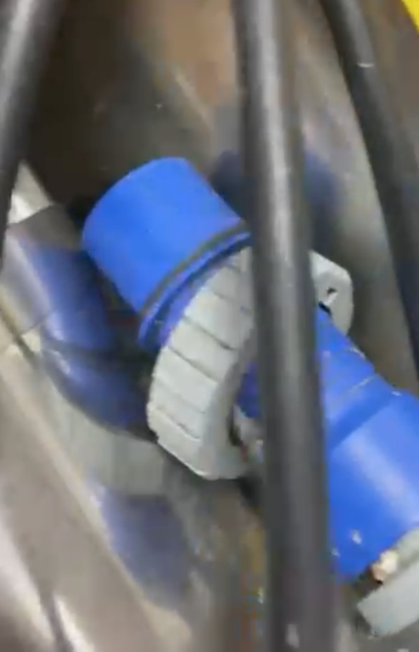

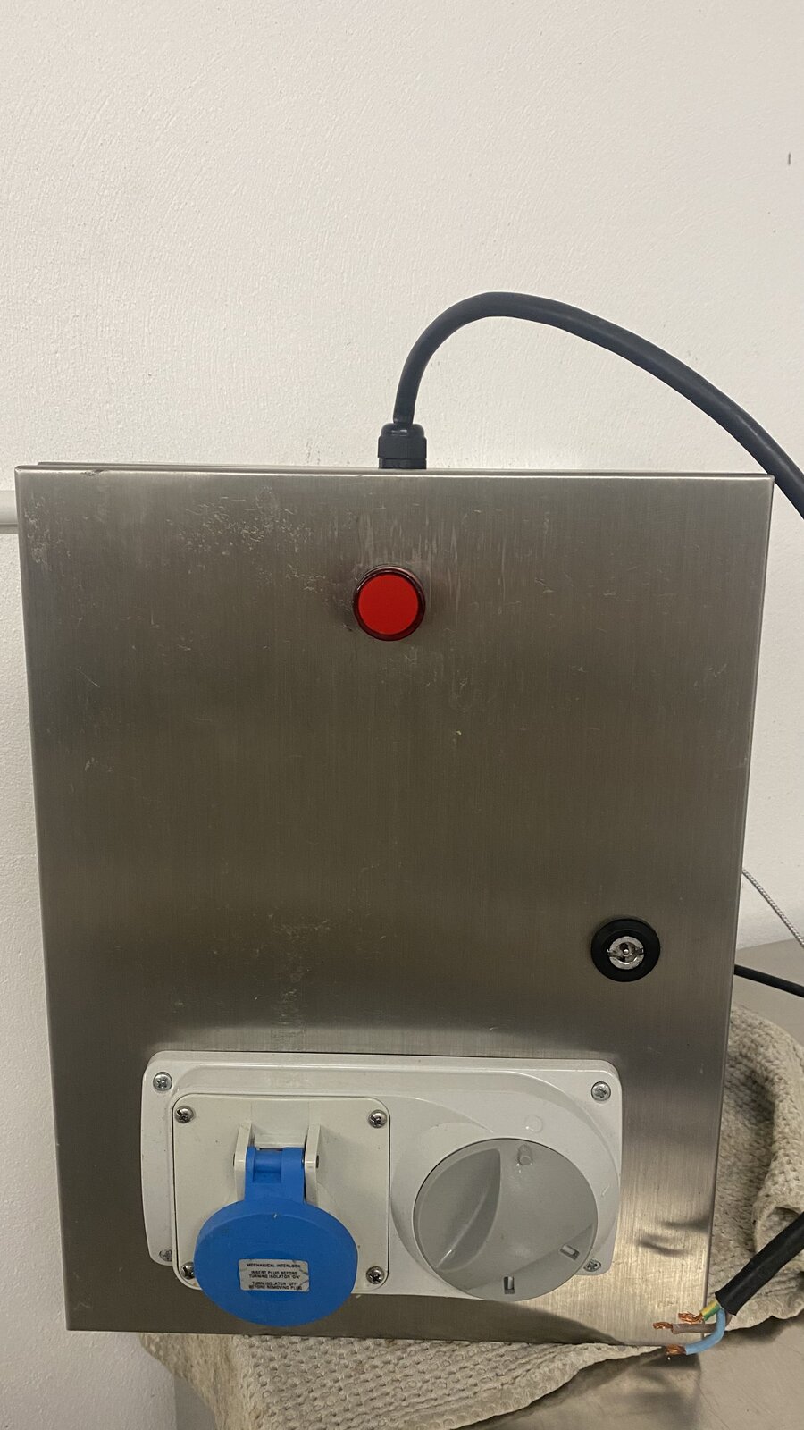

    Hi guys, I'm in the process of buying a small commercial grade machine and the power is:
    "L6-20 Plugs; Recommend 15 Amp breaker"
    Any I able to buy an adapter or convert this somehow for standard home use?
    Many thanks.

    Yes you can get the adaptor [​IMG] but it is down to if 13 amp outlet is good enough to start with. And it would be easier to just fit a 13 amp plug if that was the case.

    Your photo doesn't match your description. L6-20 is an american twist-lock plug type but what you show in your photo looks like a "CEEFORM".
    What exactly is the machine? do you have proper specifications/instructions available.

    This is What I know to be L6-20[​IMG]your pic looks like a CEEForm plug
    However I'm very confused, I think the bottom right of your pic looks like another connector and I wonder if you have a CEEForm to L6-20 socket adapter there.

    Hello guys and thanks for all the replies. You are correct it is not a L6-20. I spoke to the manufacturers in the states and they said it used that but they mustn't have realised it was a UK machine.

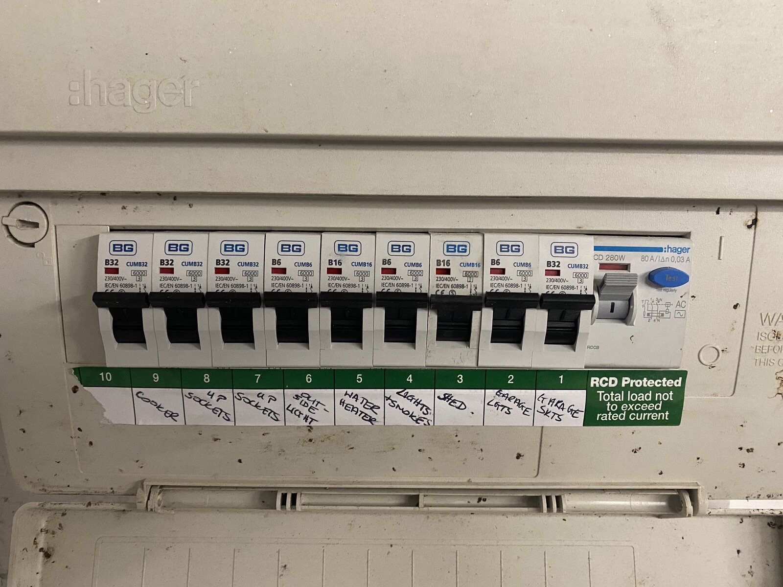

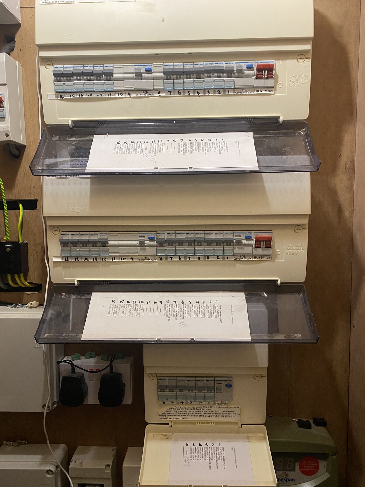

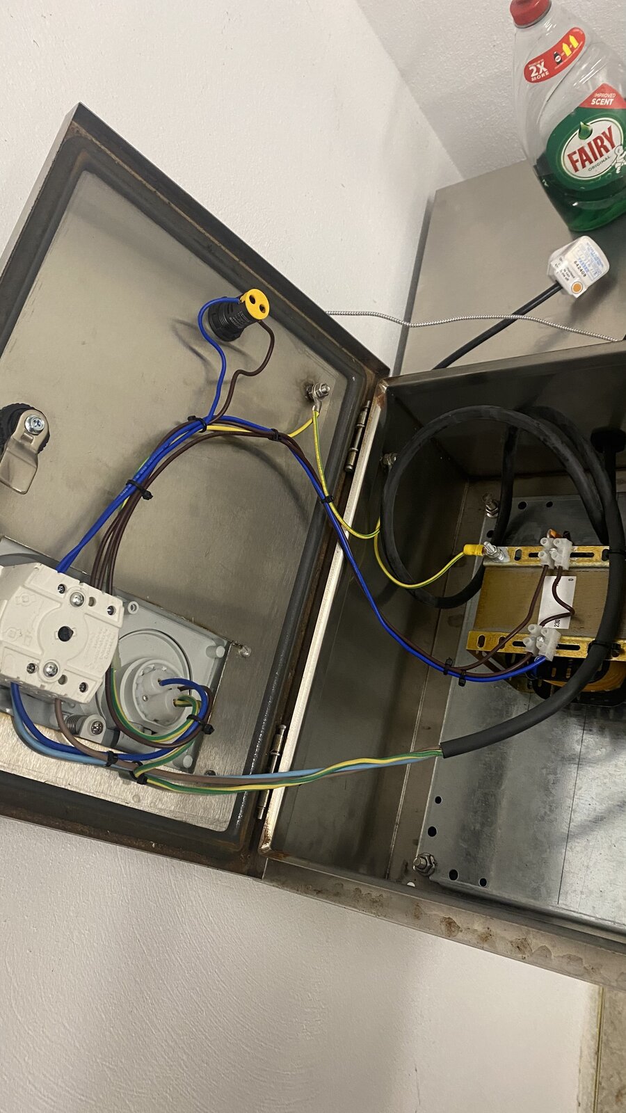

    Matty, I check the consumer units and they are all full unfortunately in both the garage and house. See below:
    I've had a look and these should do the job?
    https://www.cef.co.uk/catalogue/pro...jzQ1Avbl-wlOaRElNl0aAkO-EALw_wcB&gclsrc=aw.ds

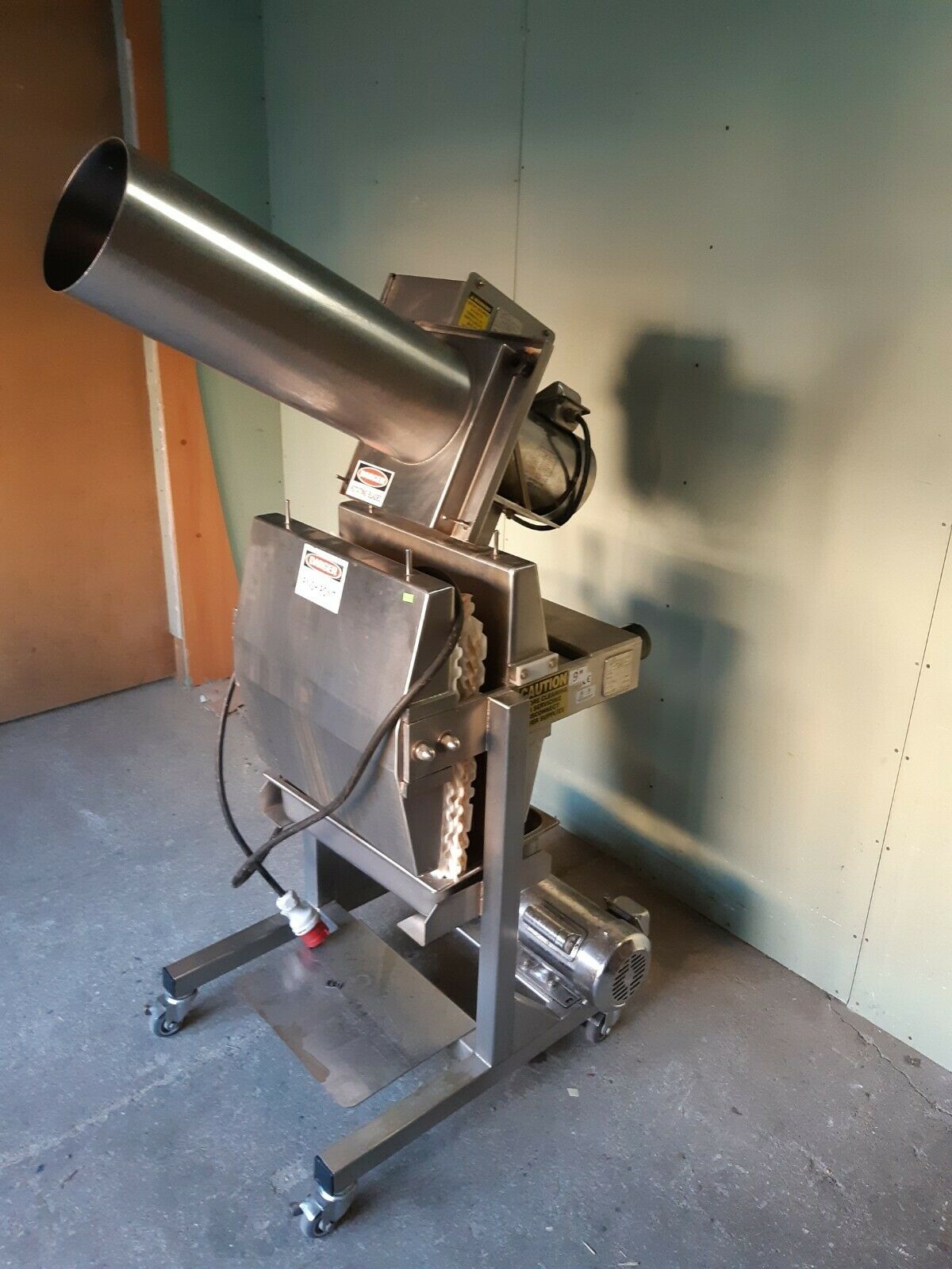

    This is the machine, it is a juice press. It has two separate functions and power leads. Grind / Press. I plan to only use the press function.

    I would not expect that to demand more than 13amps, but double check. Also double check the voltage and frequency specification. USA commonly uses 120v at 60Hz. UK is 240v (230v nominal) 50 Hz.

    In your first picture it looks like a blank way on the left.

    Thank you very much guys. The machine has been sold to the UK market so will be spec'd as such.
    Well spotted, there is indeed a blank! Thats great news and its in the garage so the missus won't shout at me :)

    And 6 spare in the second pic but the lables don't tally with the MCB's
    And if that's the actual machine you are buying in your 3rd pic it's fitted with a red [3 phase plug]
    Check carefully.
    Are you comfortable wiring a plug, if so it's a lot cheaper than the adapter cable.

    Thanks. No thats not the actual machine. The plug is as in the first photo. No problem rewiring plugs so when I receive will take a look at doing that. Thanks ;)

    No I'm really confused. The motor looks as if it may well be 3 phase, the red plug likewise. UK normally has a 3 phase supply to commercial/industrial premises, but usually single phase to most homes. Does the OP have a 3 Phase supply where he intends using this unit?

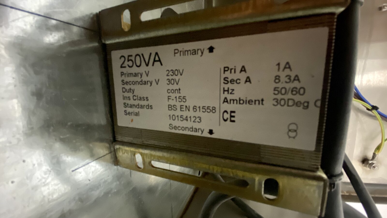

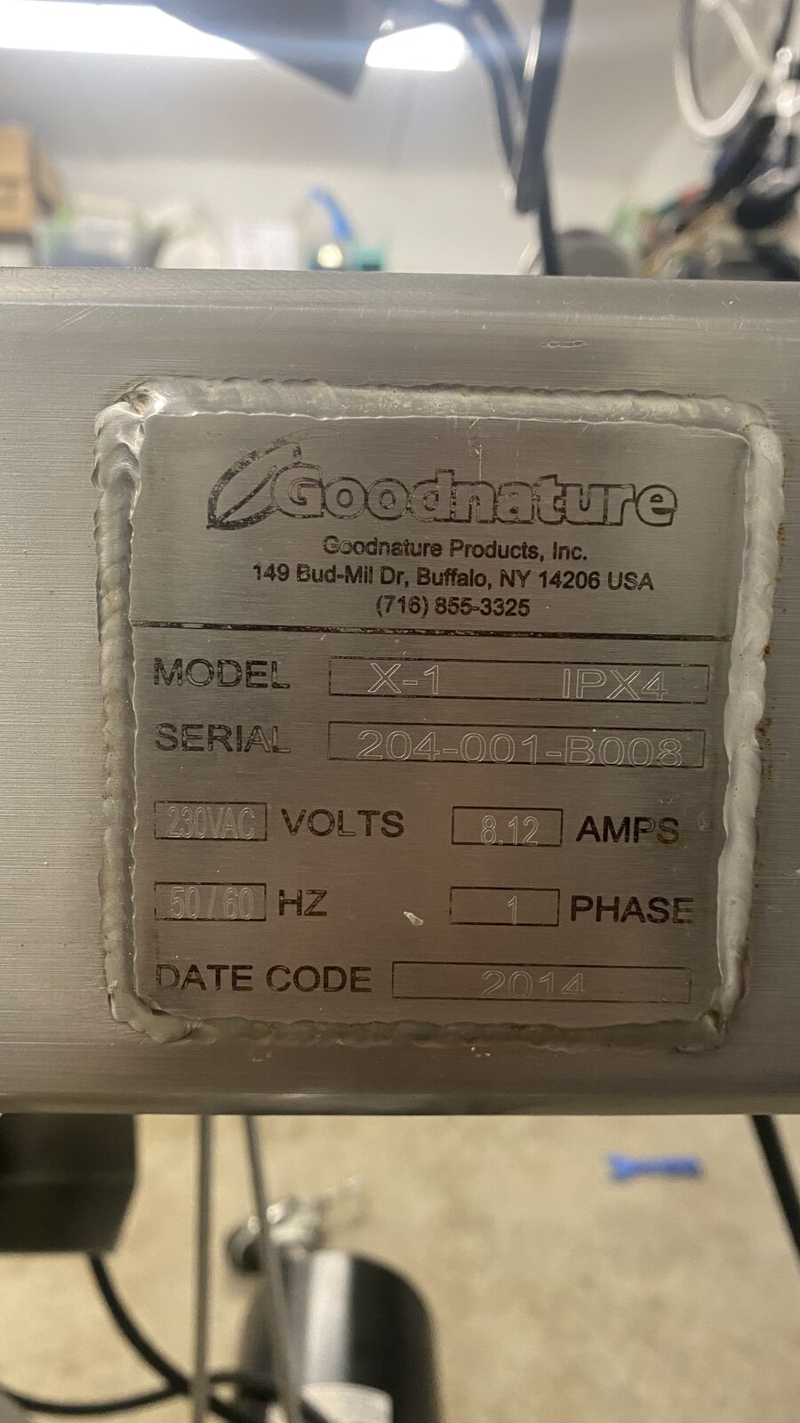

    This would be a lot more informative if you simply provided a photo of the manufacturer's data plate which will show voltage, No of phases and current requirements

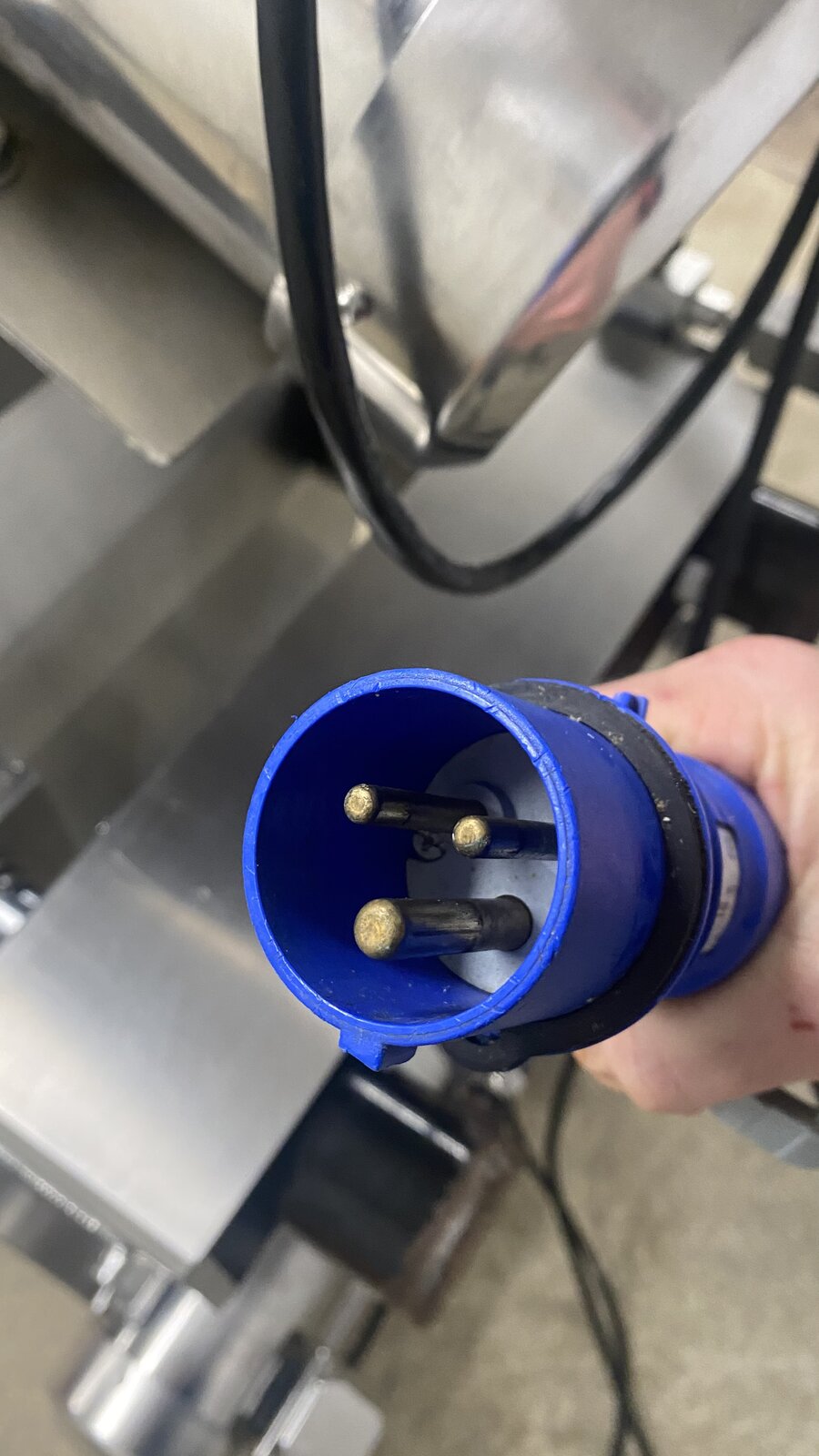

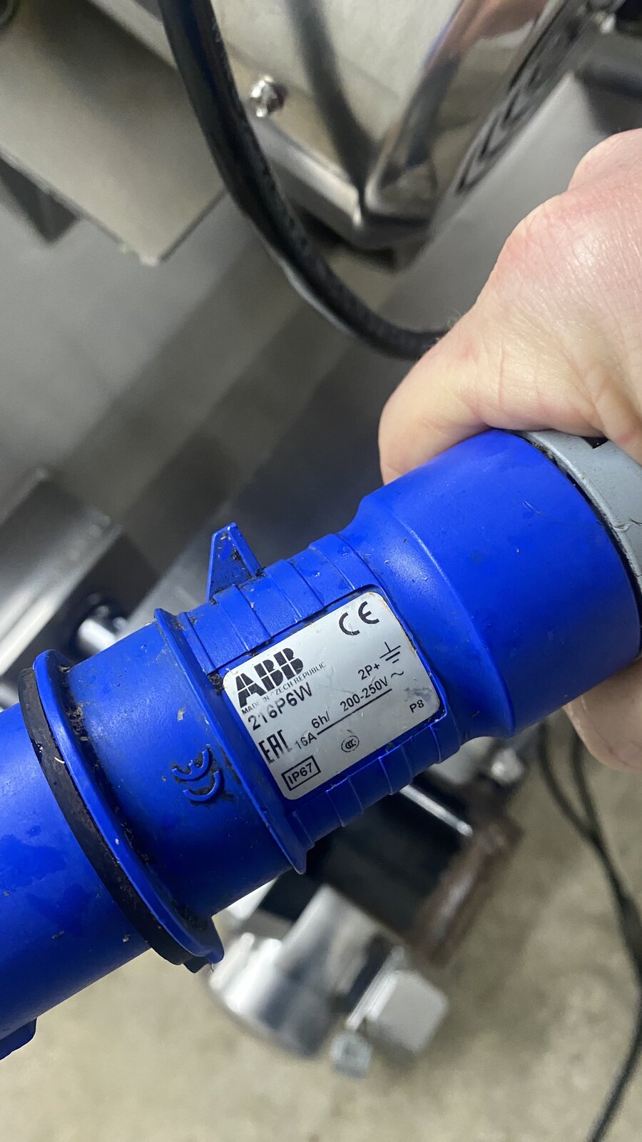

    Morning guys, I've now got the machine in my hands and am able to provide details.
    The machine has two main elements a grinder and a press. They both terminate to the same type of plugs..
    This is the data plate for the grinder:
    and this is the data plate for the press (the press then connects to the following transformer, before mains):
    Trust I can remove these plugs and replace with standard household UK 3 pins?
    Many thanks.

    Yep, should be fine, but two slight concerns....
    They are marked 230v, in the UK we have 240v so it is a few percent high.
    The start up current draw is often much higher than the running current, you may find it blows the occasional 13amp fuse.
