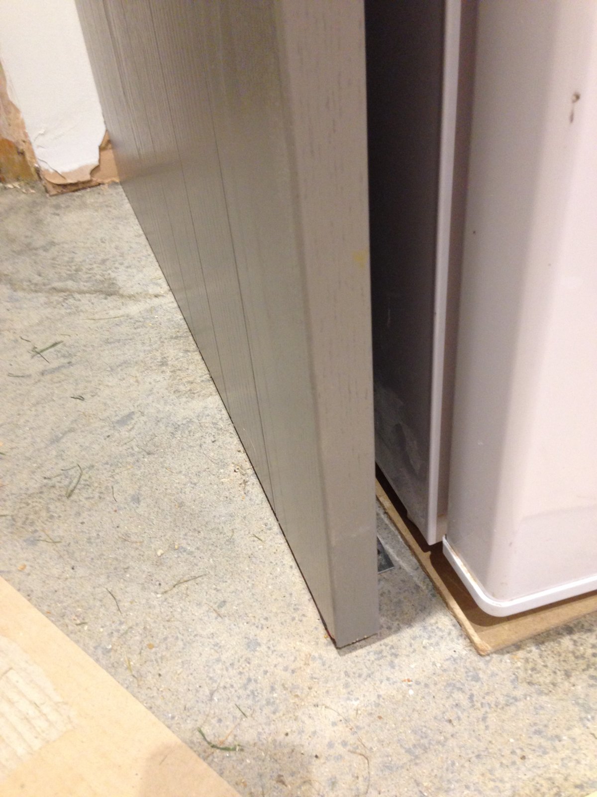

I fitted the kitchen I now need to fit laminate floor, probably quickstep.
The lines of units have end panels and two of them are weight-bearing as appliances will be next to them.
How do I fit the laminate up to the panels ideally without using beading?
Thanks.

Choices are undercut them with fein multitool of similar or scotia which you don’t like.
So...the appliance end panels I should undercut with a multi-tool (I assume thats what you meant). So the panels would only be attatched only to the worktop and wall? They'd really just be resting on the laminate?
The unit end panels could I partially undercut, say 5mm, and slot the laminate underneath a bit or is that naff!?
I would cut flush, makes it easier to take up when the fridge leaks and destroys the laminate .

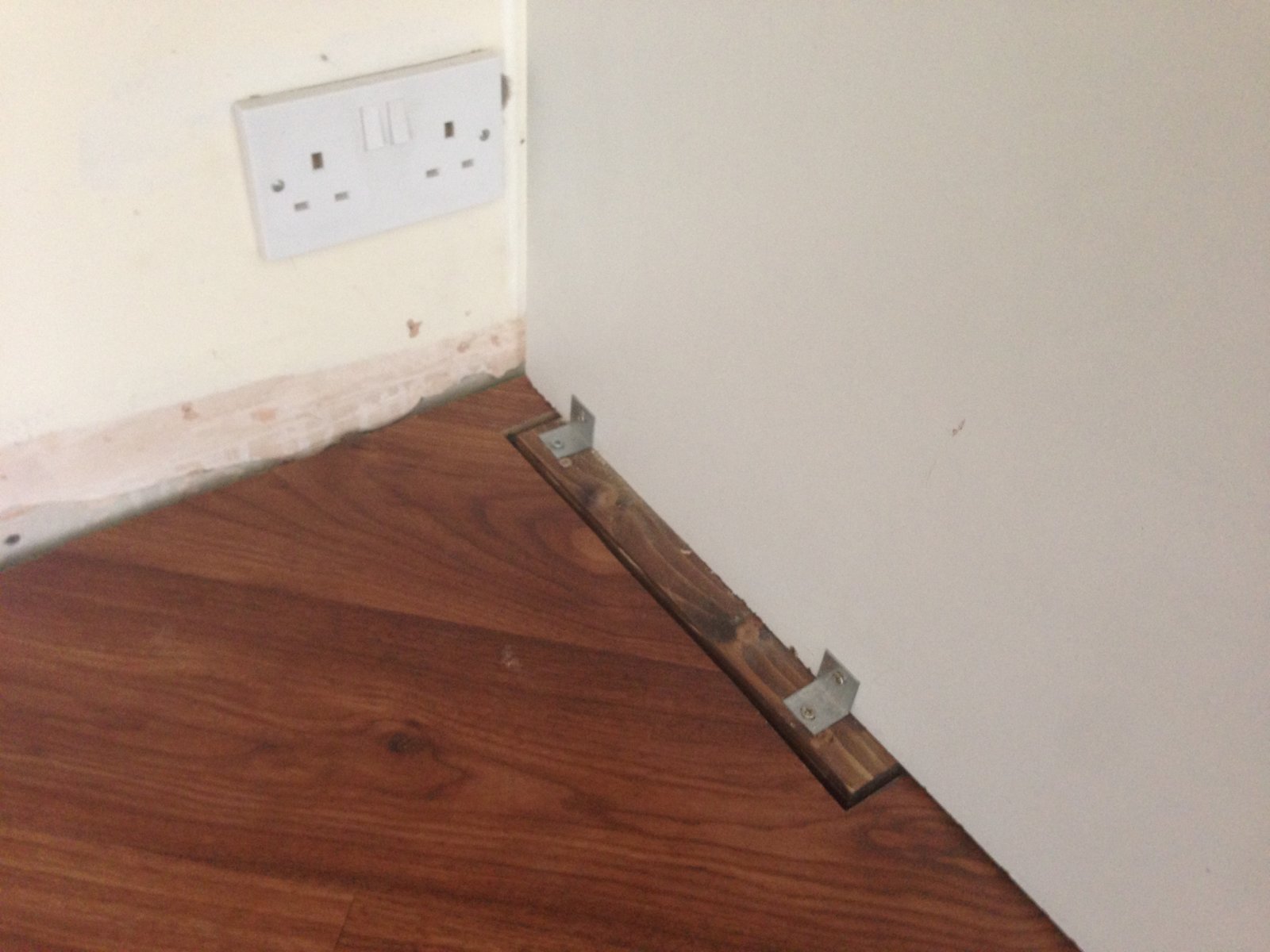

I took mine off and trimmed them down. As there are angle brackets to hold it in place on the floor, I moved these towards the back and fitted a bit of wood for it to rest on and to allow me to screw these into the floorboards rather than through the laminate

You could add decorative end panels to the two base units to match the existing, will look nicer and be consistent with the rest of the kitchen, fixing from the inside and raised slightly off the floor.
With the other two panels, as advised, either undercut, or flush cut and beading. Angle brackets can be used to fix to wall (from the inside of the panel), and likewise on the floor as Azlog suggests (or a variation of it without the angle brackets) again on the inside of the panel.
I get (got) a neater finish, as a DIYER, with a sharp handsaw, cutting carefully, than I can with a multi tool.
Good idea, a hydrid which provides some support not just relying on the wall.
