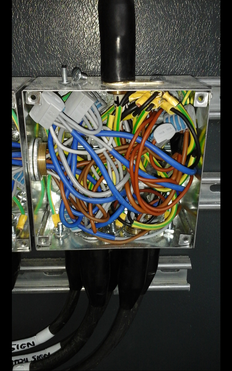

It would be nice to think it would find things like this:
https://www.diynot.com/diy/threads/why-i-hate-domestics.507103/
2018-08-10-23-10-38-jpg.146307
However everything in that picture tested ok and was in a confined space so not an obvious thing to look for.

That was a thread that I started last year and yes that has been attributed to a previous tenant and he went on to start again in his next tenancy

Too true, that was all lighting and half of it was outside lights. It has since been gone over thoroughly and that corner terminated in an adaptable box with some silliness removed. As I wrote in OP if it was in an enclosure no one would have given it a second thought (Apart from a CPC sleeved black being used as a neutral).
Realistically it's not a lot different to this:
full
other than it's not covered up with some random enclosure.
