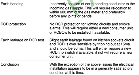

    Cheers. I've now got their actual report as well as the quote for remedial work. Of course there's no guarantee their quote is the minimum work needed so it might be a reasonable quote for the work, but not all the work is needed. Can you advise me, once someone makes any amendments to the main circuits does the whole thing have to be brought up to current regs?
    Details:
    I'll have to get photos shortly. Anyway the main issue is with the consumer unit quote. They're selling it as a safety issue which means my buyer is asking me to have it remedied. I'm not sure what I'm supposed to do about that since my word won't carry as much weight as the electrician's. But there's a clear difference between a)Not up to regs b)An issue but not dangerous c)Dangerous

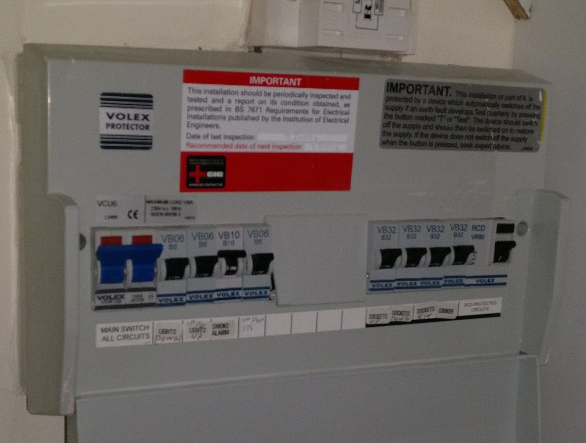

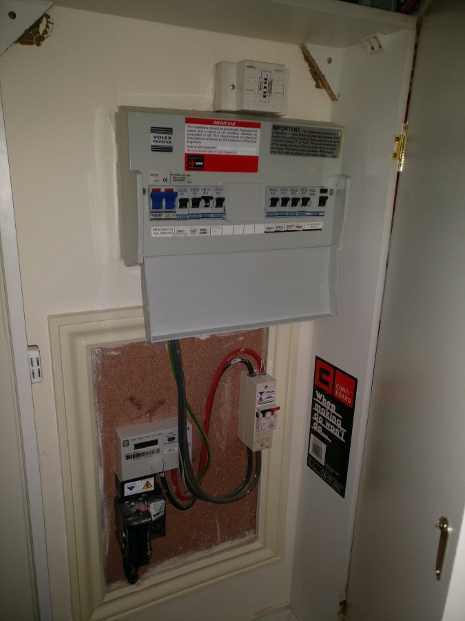

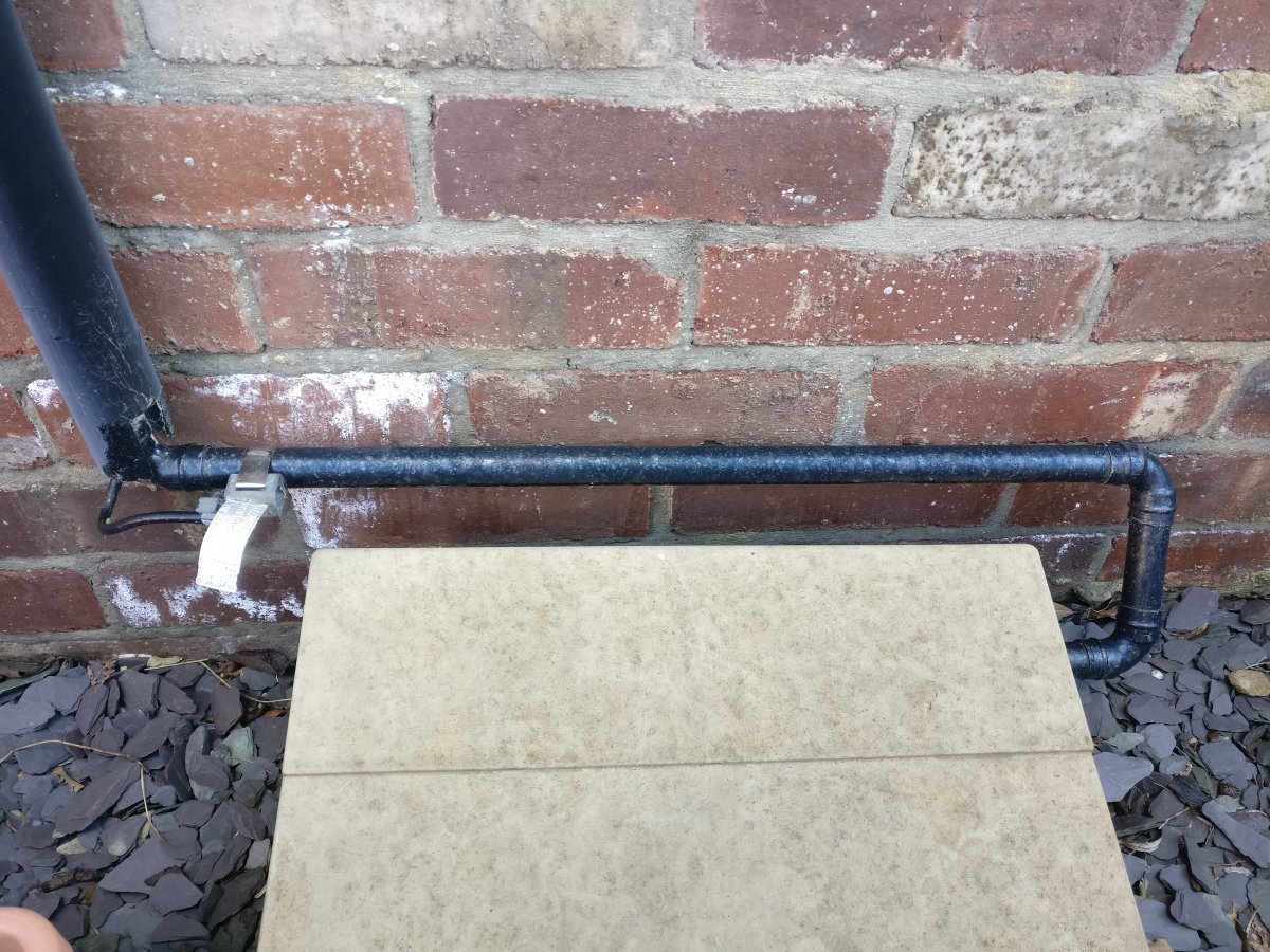

    1) Yep, that needs correcting- not up to standard. Not sure who painted the pipe black either, should have been coated with that yellow protective sleeve stuff. Without putting a joint in the cable (which is allowed but best avoided) it could be a pest running a new bit of cable back to the main earth. But not a disaster either- it is bonded, just not correctly.
    2) If everything is as fitted in 2004 (which you have stated and the red and black cable would tend to confirm) then not required, no issue.
    3) Slight earth leakage? Not a useful term. Without any test figures for insulation resistance between conductors, that 'issue' could be caused by any number of things. Did they, for instance, unplug or disconnect every single item (including stuff on FCUs) before testing? RCD over sensitive is not (to me anyway) a cause for alarm, looking at that CU a replacement RCD would almost certainly be available. I'd be sticking my tongue out at that one (or asking them for insulation resistance readings on the circuit in question).
    4) Does look quite neat and tidy and there's nothing visibly wrong with that CU.
    4A) And that 'earth leakage caused by loose screws' - nice scare story for the gullible. Loose terminal screws are undesirable but easily checked and repaired.
    So, Item 1 is a definite not compliant with regs. If the main earth is near that point then rectification would cost about £2 in bits and about 5 minutes if you did it yourself.
    Item 2 is not an issue
    Item 3 without some numbers to quantify the 'earth leakage' is a bit fishy.
    If the purchaser wants to spank £500 replacing a perfectly good consumer unit then let him/her do so, but from the info given there is no good reason to replace the thing.

    Problem with all of it is the whole buyer/seller thing. The bonding on the gas pipe is an easy fix- put the clamp in the correct place, fix the correct size wire to it and tighten it to the correct torque. All visual stuff, no drama.
    Replacing the RCD isn't a biggie either- but you've got no way to prove that the new one is functioning correctly without getting someone with all the gear to test it. The slight earth leakage in the kitchen is a quality scare tactic- again impossible to prove clear without expensive test gear.
    Here's what I'd be tempted to send the purchaser
    Dear Buyer.
    Gas pipe bonding- here's what they didn't like, here's what they said should be done, here's the pics (you can do that lot) of it done.
    No RCD on lighting and smoke alarm- was not required in 2004 when the place was wired. Is not required now unless any additional cabling on the circuits falls within the scope of the regs
    Slight earth leakage in the kitchen- please ask your inspector to elaborate with (a) test methodology used (b) insulation resistance figures between L, N & CPC. Without this data it is impossible to determine what work should be undertaken. A new consumer unit is not going to correct any 'slight earth leakage' in the kitchen.
    RCD tripping at 15mA- this is a good thing, as it is tripping at only 50% of the current at which it is required to trip. If there were any serious 'earth leakage' in the affected circuits the thing would be tripping every 5 minutes- as it is we've had to reset it (insert number of occasions) in the last x years.
    Bottom line- we're not going to replace a perfectly serviceable consumer unit without some evidence that the existing one is defective. We're not going to replace an RCD which has been PROVEN to operate correctly under fault conditions (ie disconnects at 30mA or less of fault current). We have corrected the bonding to the gas pipe. What you do after you've bought the place is up to you.
    Love,
    The Seller
    Oh yes, your question. If you added cabling or sockets to a ring final (or extra lighting onto a lighting circuit) then THOSE ADDITIONS have to comply with current regs. In most cases this will mean you'll need an RCD on the circuit (unless the new cable is surface mounted or in proper conduit or buried deeper than 50mm from any accessible surface). The RCD is intended to operate in case of damage to the installed cable as well as in case of any damage to a connected device- so for power sockets you cannot just use an RCD socket, besides which it'll nearly always be cheaper and certainly neater to protect the whole circuit at the CU. So, let us say, you added an extra light fitting (using buried cable) on the ground floor lighting circuit. That circuit would require RCD protection to comply. If the cable was surface mounted (or buried as above) then it probably would NOT require RCD protection to comply.

    Gas bond needs to be as near the meter as possible (max 600mm) , preferably before any joints. I expect that bond was installed before the supply was connected, quite likely on the original drawings the outlet from the meter was on the other side of that hide & thus the tail left by first fix would have reached.

    Well it's within 600mm so I would not have a problem with it. It's certainly not unsafe. Besides, those meter boxes are dated where the supply would be plastic anyway, so it's unlikely the bond is even needed.
    You could bring the bond inside at the point of entry to the property to protect from elements if that was a concern.

    Others already replied but what I was told was:
    • It has to be bonded within 600mm (I think it is though whether that is straight-line distance or distance the bond is along the pipe?)
    • It is recommended to be bonded before any joint
    • They didn't like that it was attached on top of a painted pipe
    A mate also suggested the pipe should be highlighted in some special tape rather than painted black but I never heard of that one before.
