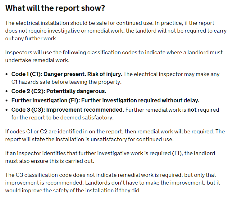

    Hi. Just had one of these done and the electrician has failed it and says the property needs a new consmuer unit.
    The consumer unit in there is about 10 years old and has RCDs. I think he's just looking for work or is he right?

    Not really.
    The regulations are very unclear as to whether the installation must meet the current standards or just be safe.
    There are a few threads on here about it

  12. EFLImpudence
    EFLImpudence
    Joined:
    7 Jul 2010
    Messages:
    37,034
    Thanks Received:
    4,150
    Location:
    Retired to:
    Country:
    Portugal
    This is the Government guidance.
    https://www.gov.uk/government/publi...safety-standards-in-the-private-rented-sector
    It clearly states that C3 codes (improvement (to 18th) recommended) are allowed.
    This, by definition, must mean that not everything has to be to the latest 18th Edition Regulations for the installation to be satisfactory.
    So, until you have the report you cannot tell what has been decided and whether it is right or wrong.

  15. EFLImpudence
    EFLImpudence
    Joined:
    7 Jul 2010
    Messages:
    37,034
    Thanks Received:
    4,150
    Location:
    Retired to:
    Country:
    Portugal
    If true, then they can be replaced - but how do you know without the results?
    And - has he tested them properly.
    Next time you have a report done, emphasise that the inspector will not be given any of the remedial work required.
    • Like Like x 1
