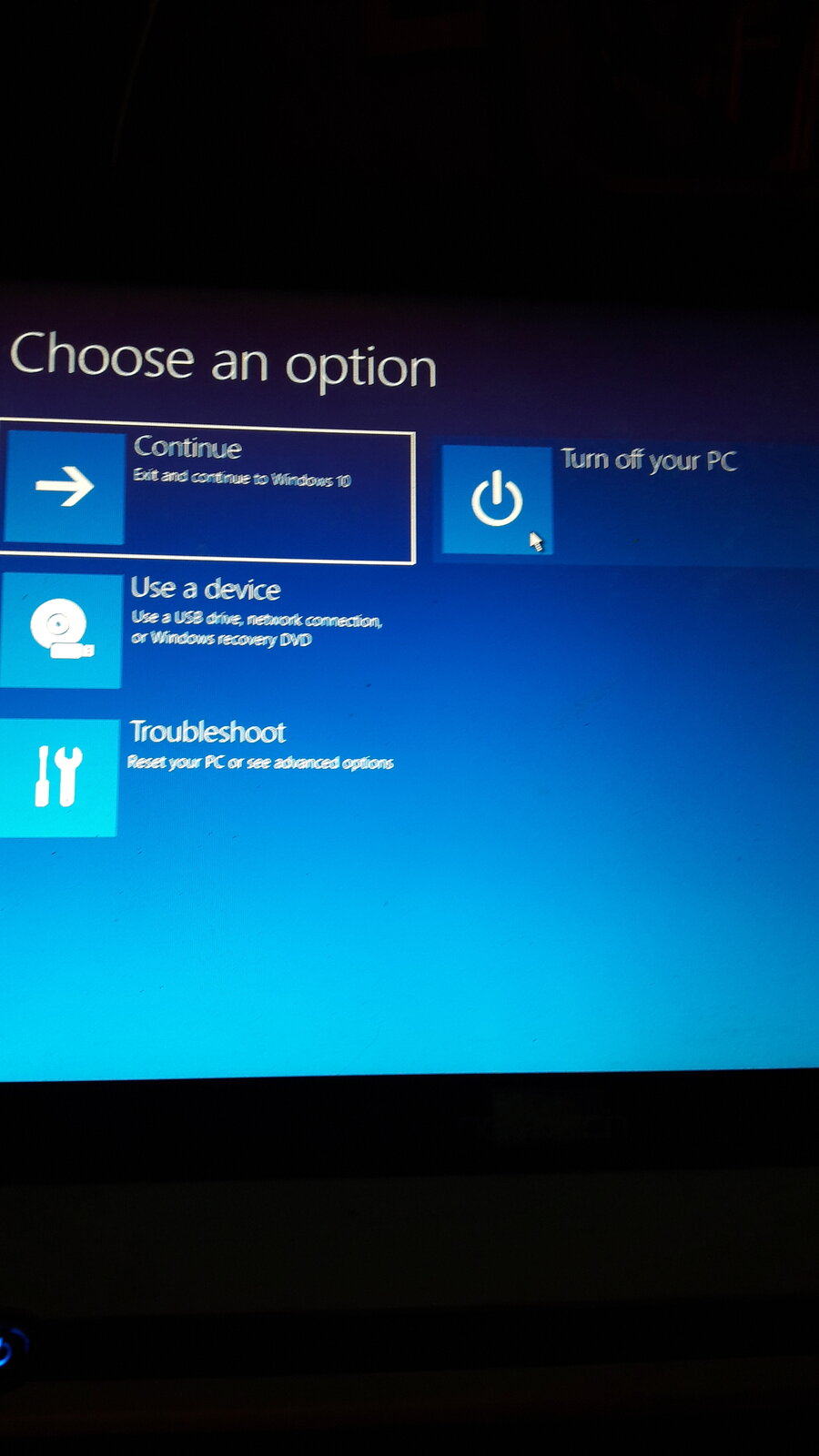

Hi all? All of a sudden I get this:
Rather than my home screen.
Og the options listed, I have no recovery devices to use.

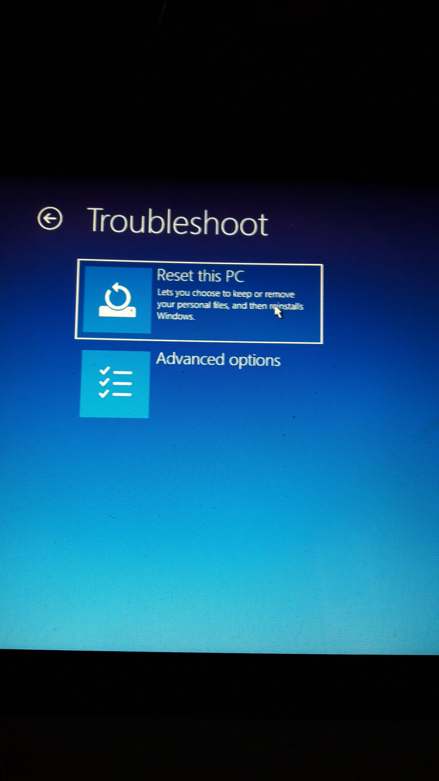

Troubleshoot brings me to this screen:

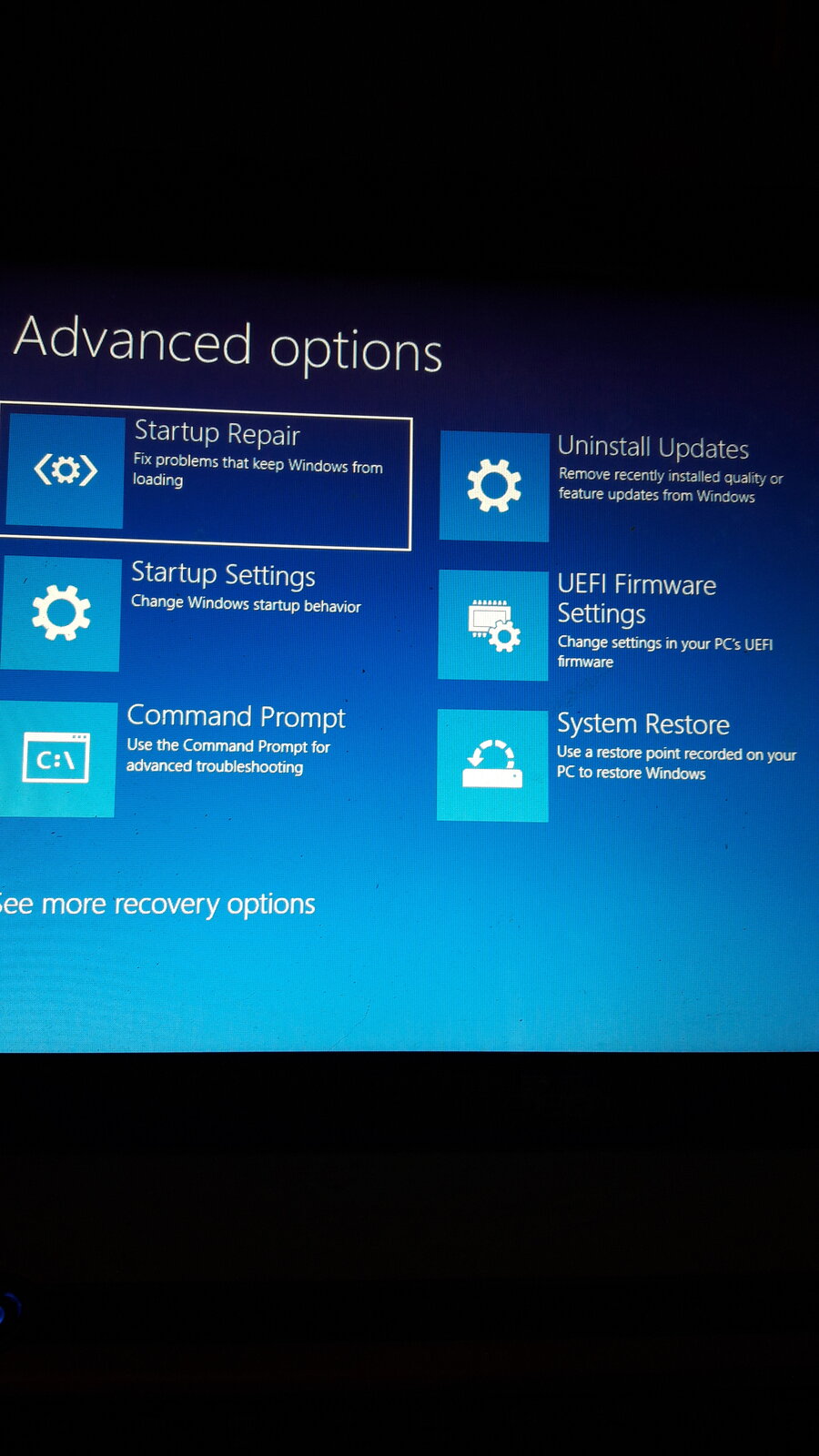

Reset does nothing and Advanced options gives me this screen:
None of which seem to do anything.
The only option which seems to do anything is Continue (1st screen). When I select this I get this screen for about half an hour before a message saying 'preparing automatic repair', another one saying 'diagnosing your PC', and then back to the first screen I posted.

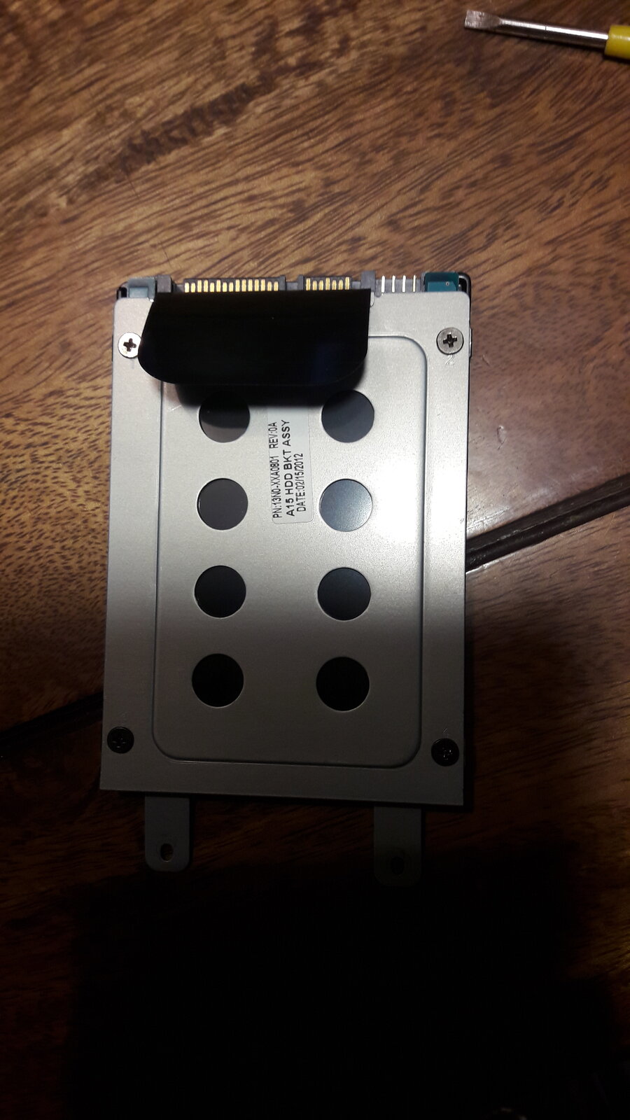

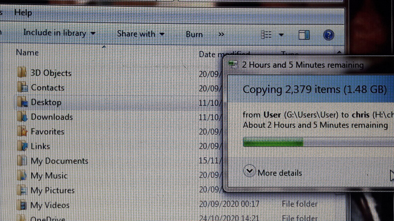

I guess the hard drive is faulty, and I'll need to source a new one, but having taken the back off to access the drive, I cannot see any plug comnected to ( what I would describe as) the power connection. (Those 4 pins at the exterme right). I cannot see a spare plug either, but that could be because I havent stripped the laptop down enough yet.
Could the fault be lack of power to the HDD?
That is a SATA (Serial ATA) drive. The Left hand gold plated connector is the data connector, the central gold plated connector is the power connector. These will connect with the socket on the motherboard. The four right hand pins are probably for jumpers and not used.
Thanks for the confrmation Mike.

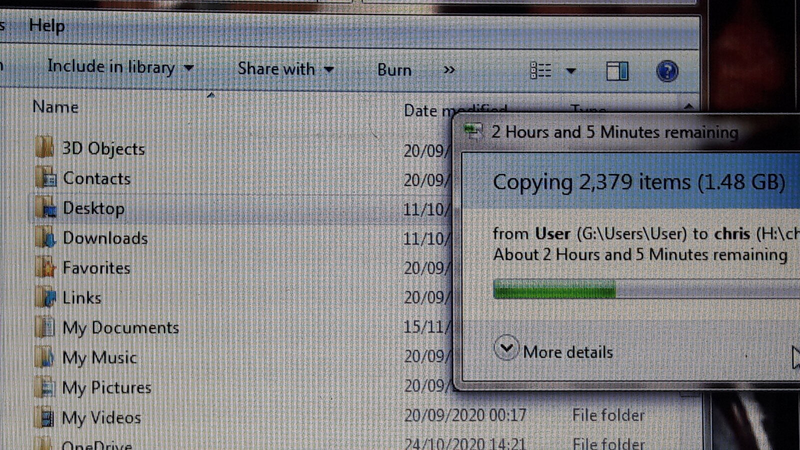

I've just had the HHD enclosure arrive and it seems to be transferring the contents of my desktop to a 500G external drive, so I shd save my files. Thanks for the tip Ross.
I've also downloaded the ISO software onto a 16G mem stick.
My intention is to try the ISO tool with the old HDD first and then get a new one.
